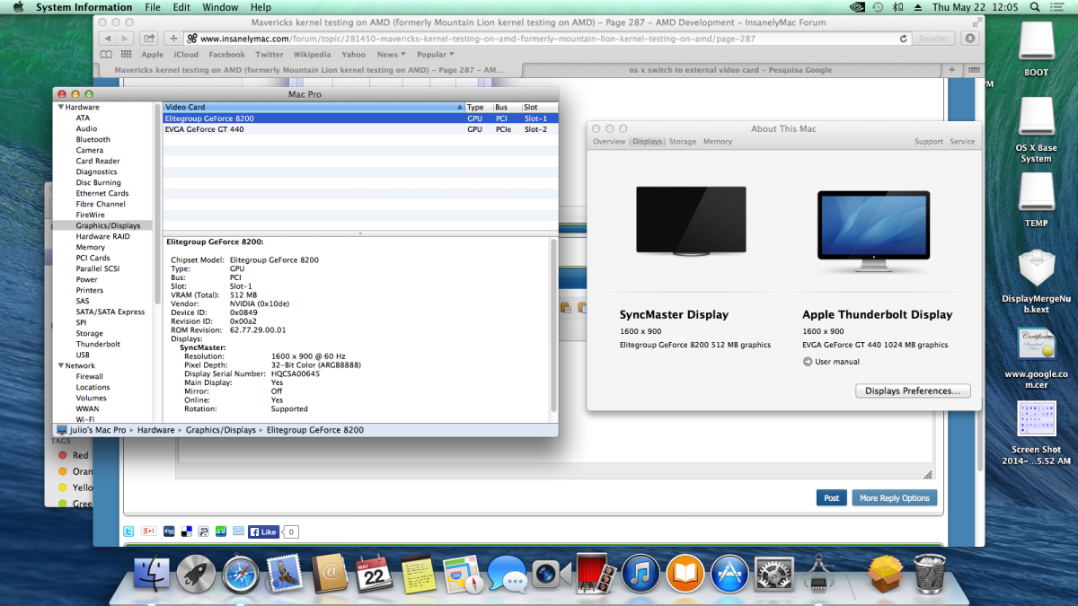

Guys sorry for for this bit off-topic post but i've managed to boot my rig with IGPU and GFX Card in SLI Mode and have QE/CI but system is slow as f**k and i still can't take advantage of it. I've tried it before with standard os x drivers with no success so yesterday i did a the most possible vanilla install i could to see if it would solve the problem with SSL on Chrome, it didn't, but i started to test other things like this and managed to get it working. Follow the screenshots i'll post instructions with detailed information if i could get it to work the way it should. Resumed process: OS X 10.9.3 Install > boot with standard flags > Download nVidia latest web drivers and Cuda > Reboot > Set SLI on in BIOS > Set amount of shared memory in BIOS > Set IGPU first in BIOS > Save > Boot with standard flags plus nvda_drv=1 > Wait for a long time to enter desktop, mine takes some time since its not working 100%. Thats it, will give updates ASAP.

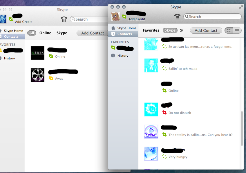

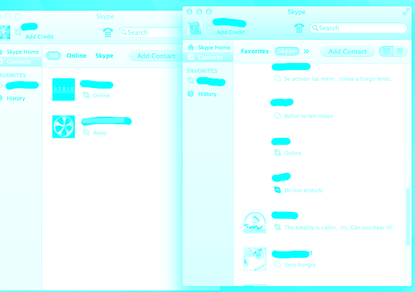

The coloring on screencapping and all that is related to all these graphical glitches across the system.
this happens in skype for example .post-1147257-0-23707400-1400786650_thumb.png
(the one on the left is my work skype that is launched as a root user, it doesnt appear to show glitches on the avatars as the one of the right)
And this happens when you edit and save a file though Preview.app post-1147257-0-38581700-1400786680_thumb.png
This is new behaviour with this kernel and is reminicent of back when we used to get pink Launchpad icons.

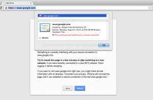

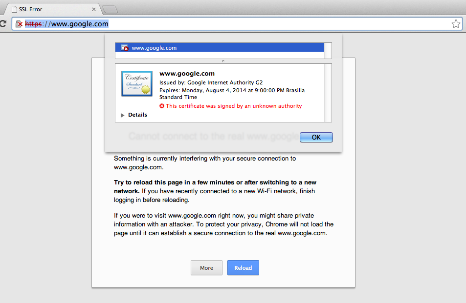

And the SSL problem in crome happens in any website that requires https connection. I cant even visit google... Ive switched to firefox in the meantime. infact ive had to switch to different apps for different things that have been broken.

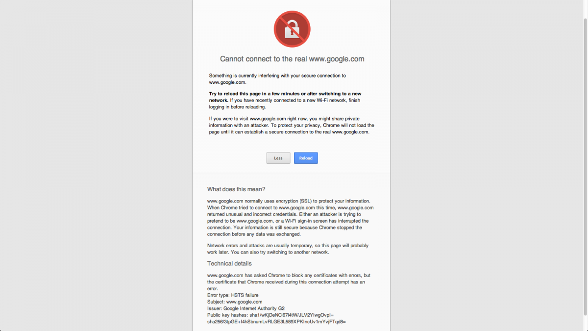

Hi Bronya, the symptoms are very simple to understand.
  • Any HTTPS (SSL) request made by Chrome will be blocked be Chrome itself;
  • Any HTTP request will work perfect;
  • If you do a HTTPS request from Safari or other browsers it will work perfect;
Attached some screenshots and a copy of the *.cer file. Hope it helps;
My current specs:
Below the copy and paste of the error page:
Cannot connect to the real www.google.com
Something is currently interfering with your secure connection to www.google.com.
Try to reload this page in a few minutes or after switching to a new network. If you have recently connected to a new Wi-Fi network, finish logging in before reloading.
If you were to visit www.google.com right now, you might share private information with an attacker. To protect your privacy, Chrome will not load the page until it can establish a secure connection to the real www.google.com.
LessReload
What does this mean?
www.google.com normally uses encryption (SSL) to protect your information. When Chrome tried to connect to www.google.com this time, www.google.com returned unusual and incorrect credentials. Either an attacker is trying to pretend to be www.google.com, or a Wi-Fi sign-in screen has interrupted the connection. Your information is still secure because Chrome stopped the connection before any data was exchanged.
Network errors and attacks are usually temporary, so this page will probably work later. You can also try switching to another network.
Technical details
www.google.com has asked Chrome to block any certificates with errors, but the certificate that Chrome received during this connection attempt has an error.
Error type: HSTS failure
Subject: www.google.com
Issuer: Google Internet Authority G2
Public key hashes: sha1/wKjDeNCi67l4tW/JLV2YIwgOvpI= sha256/3tpGE+I4hSbnumLvRLGE3L589XPKIncUv1mYvjFTqd8=
www.google.com.cer.zip
