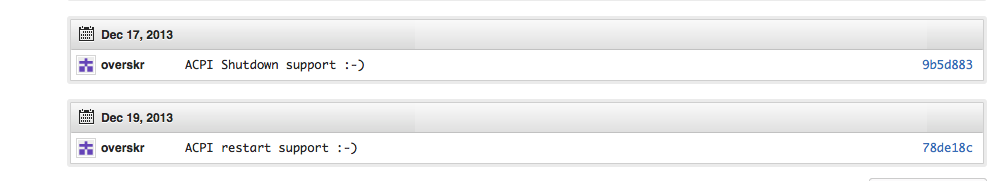

Edit: Built from Sinetek's latest edits. Includes ACPI restart support. Assuming this is V6 now as shudown would have been V5 :)
attachicon.gifmach_kernel.zip
thanks, i've posted a new release
https://github.com/sinetek/xnu/releases/tag/10.9.0_v6
i haven't had the courage to dig into yall's ACPI tables yet :rolleyes:
@tragediana   your FACP is missing the reset register thingy. it's an easy fix, i'll just make it reboot by poking the default PCI bus.

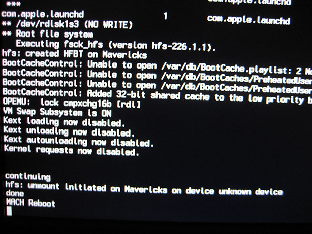

interesting, it seems you have one of the very first amd64 cpu's .. it can't run windows 8.1 either.
i'm not sure how to add support for it. there are only 2 lines inside the kernel that cause problems, so it might be possible

pic from 10.9.0_v1 ...10.9.0_v4 stuck at PCI Configuration
