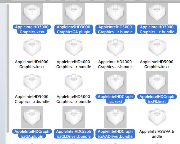

artur_pt Posted July 25, 2013 Share Posted July 25, 2013 hello u must use macbookpro8,1 smbios and use nullcpupowermanagement probably must delete from the installer appleintelhd*.* from system/library/extensions if that error go on use in boot cpus=1 hp have that problem.. lapic fix good hack Link to comment Share on other sites More sharing options...
Aswin Posted July 25, 2013 Share Posted July 25, 2013 Thanks for the reply.. i used macbook pro 8.1 and pasted null cpupowermanagement kext (along with fakesmc kext) in /System/Library/Extensions folder of the usb... In that folder u want me to delete appleintelhd*.*...??? Link to comment Share on other sites More sharing options...

artur_pt Posted July 26, 2013 Share Posted July 26, 2013 hello what lapic fix u apply ? don't need it for install only need to boot cpus=1 and make a default in bios.. only need sata in ahci mode good hack Link to comment Share on other sites More sharing options...

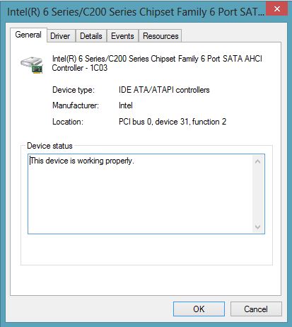

Aswin Posted July 26, 2013 Share Posted July 26, 2013 Hi I think i dont have any option to change in my Insyde BIOS other than H/W virtualisation and Dynamic graphics... I cant see AHCI or SATA anywhere in BIOS... Can u tell me how can i check whether my system has sata in AHCI mode? using any software.. If its already in AHCI mode I can continue or I should give up installing MAC along with my windows 8 right!!! Link to comment Share on other sites More sharing options...
artur_pt Posted July 26, 2013 Share Posted July 26, 2013 hello that ahci is for the hd... the give up is u decision... what i can tell to u . is mac os x is for mac and developed exclusively for mac hack mac os x is 99% of reading, googling, persistency and 1% of luck u hardware be compatible.. this is not windows .. can be installed in a toaster.. only need the toaster have a dvd drive.. don't expect any easy way... to install and run mac os x .. good hack Link to comment Share on other sites More sharing options...
Aswin Posted July 26, 2013 Share Posted July 26, 2013 Sorry I did not mean i m frustrated.. u r the one who is helping me... I just wanted to know how to check my sata mode and i think found it from device manager.. I hope this is what u said about and i think its in ahci mode only.. I ll try again and update you.. Thanks... Link to comment Share on other sites More sharing options...
artur_pt Posted July 26, 2013 Share Posted July 26, 2013 hello revise the installer remove the appleintelhd*.* boot -f -v GraphicsEnabler=No cpus=1 that with original mach_kernel good hack Link to comment Share on other sites More sharing options...

artur_pt Posted July 26, 2013 Share Posted July 26, 2013 hello remove from installer appleintelhd*.* the second card don't work.. use smbios 8,1 i'm in maverics so i have another kext.. but that is the idea after removed the appleintelhd*.* boot -f -v GraphicsEnabler=No after install 1º boot if any graphics problems http://olarila.com/forum/viewtopic.php?f=28&t=2193 good hack Link to comment Share on other sites More sharing options...
