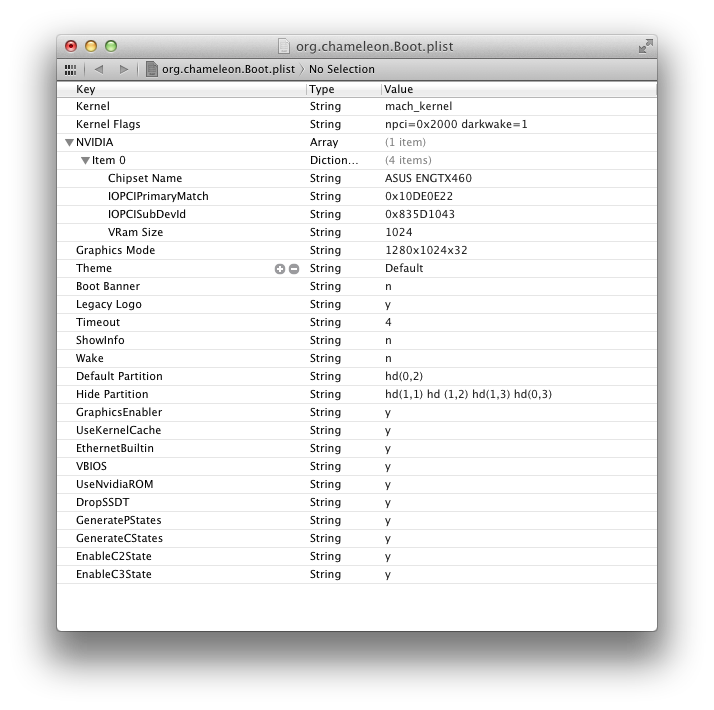

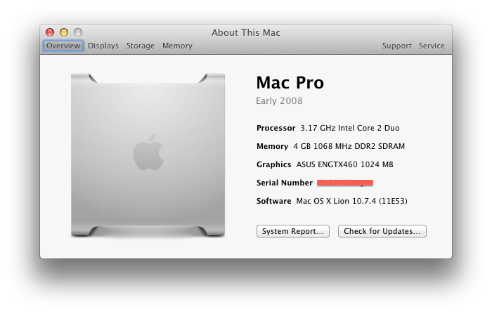

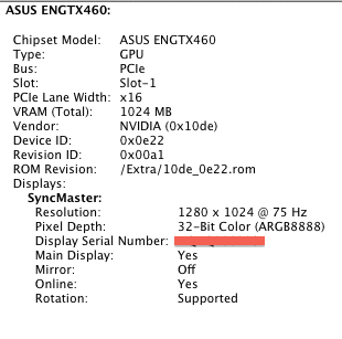

Gringo Vermelho Posted August 13, 2012 Share Posted August 13, 2012 This... Geforce GTX 460 1024MB NVc4 [10de:0e22]-[1043:835d] :: PciRoot(0x0)/Pci(0x1,0x0)/Pci(0x0,0x0) device number: 1 ...is an ASUS ENGTX460 This I haven't seen announced anywhere - we can now do this: (Chameleon 2.1 svn r2042) ..and it works: 2 Link to comment Share on other sites More sharing options...
ErmaC Posted August 13, 2012 Author Share Posted August 13, 2012 nVidia GeForce 9400 512MB NVac [10de:086a]-[1458:d000] :: PciRoot(0x0)/Pci(0x10,0x0)/Pci(0x0,0x0) device number: 1 This... Geforce GTX 460 1024MB NVc4 [10de:0e22]-[1043:835d] :: PciRoot(0x0)/Pci(0x1,0x0)/Pci(0x0,0x0) device number: 1 ...is an ASUS ENGTX460 Thx guys I will add in the next commit. Fabio Link to comment Share on other sites More sharing options...
