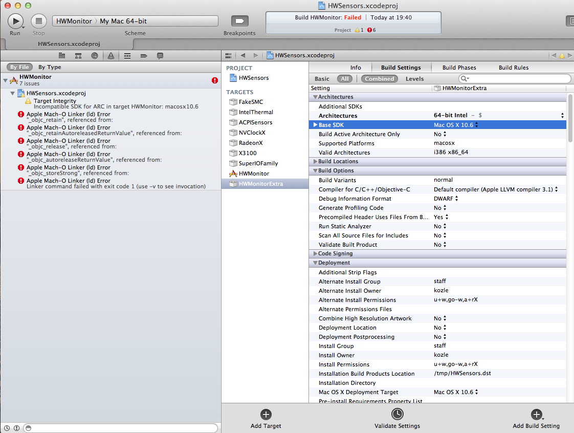

Because ARC - automatic reference counting. I tried but can't compile it for 10.6.
That's wrong Mozo - just change deployment target to 10.6 (not an SDK) and application will work in 10.6 :wink2:
XCode 4.3.2:

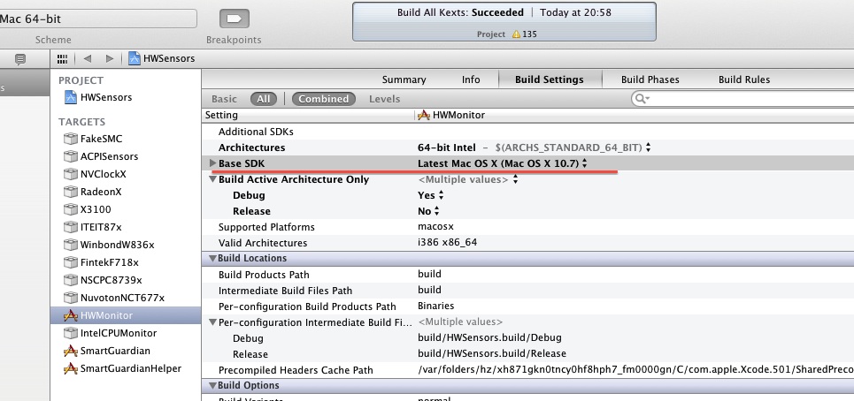

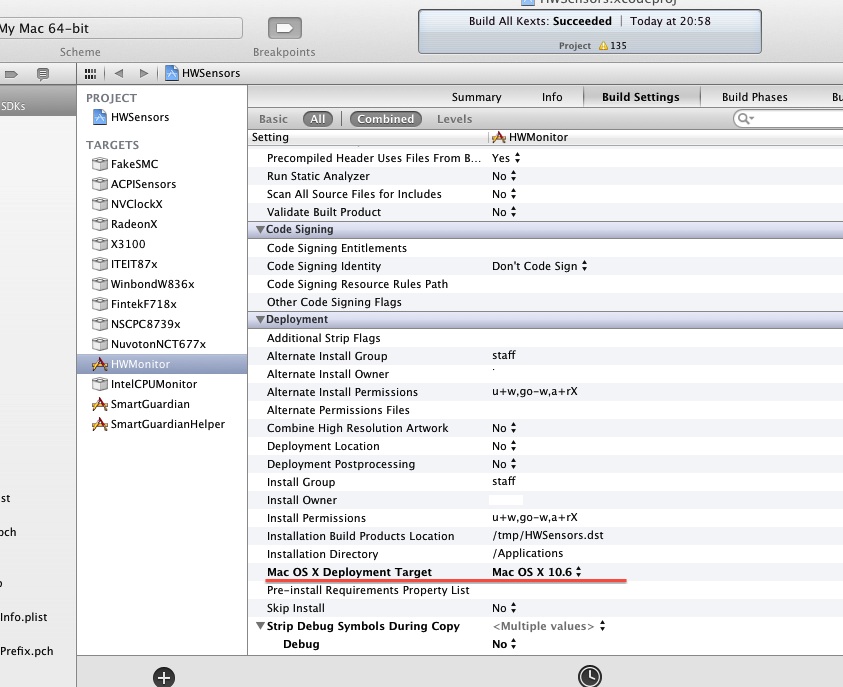

Yes, and as i said this is wrong. If you want this application to work in 10.6 - you need to setup like this
Leave SDK as 10.7
But set deployment target to 10.6
THat will compile with ARC and will work in 10.6... We had such kind issue reported before (at applelife.ru - you know what i mean).

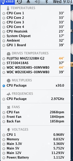

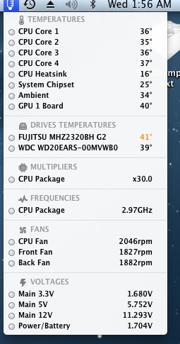

With new ACPISensors and SuperIOFamily it´s even worse :( :
What did you do I can only imagine. HWMonitor and kexts used are incompatible (from screenshot). SuperIOFamily now standalone but in your kernel log Nuvoton plugin trying to load...
P.s. what you could do: delete all HWSensors kexts and apps installed. Reinstall them from the package from the latest revision.

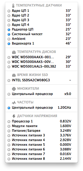

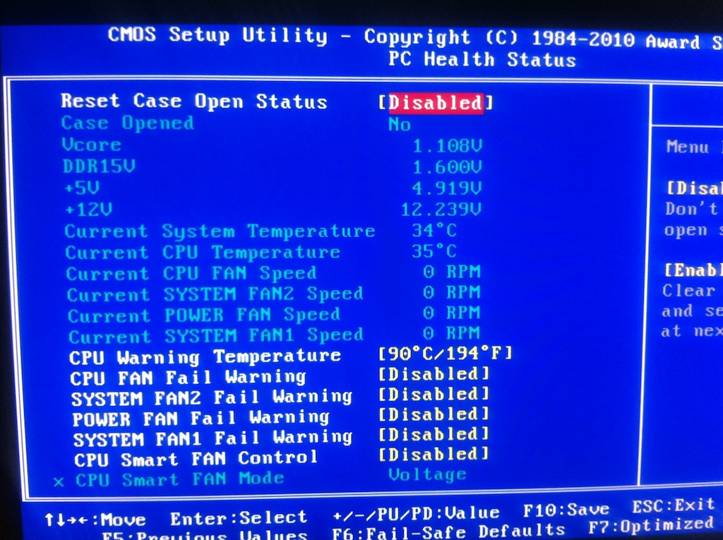

Short description how to get gain values for different voltages.
First of all you need a reference point: information about voltages from BIOS or other software from Windows like AIDA64, HWMonitor or OpenHardwareMonitor.
Dump from OpenHardwareMonitor:
| +- ITE IT8720F (/lpc/it8720f)
| | +- CPU VCore : 0.816 0.816 1.216 (/lpc/it8720f/voltage/0)
| | +- DRAM : 1.6 1.6 1.6 (/lpc/it8720f/voltage/1)
| | +- +3.3V : 3.376 3.376 3.376 (/lpc/it8720f/voltage/2)
| | +- +5V : 4.94592 4.89216 4.94592 (/lpc/it8720f/voltage/3)
| | +- Voltage #5 : 0.128 0.016 1.248 (/lpc/it8720f/voltage/4)
| | +- Voltage #6 : 3.088 3.088 3.088 (/lpc/it8720f/voltage/5)
| | +- Voltage #7 : 0.016 0.016 0.192 (/lpc/it8720f/voltage/6)
| | +- Voltage #8 : 2.144 2.144 2.144 (/lpc/it8720f/voltage/7)
| | +- VBat : 3.248 3.248 3.248 (/lpc/it8720f/voltage/8)
| | +- Temperature #1 : 34 34 34 (/lpc/it8720f/temperature/0)
| | +- Temperature #2 : 25 25 25 (/lpc/it8720f/temperature/1)
| | +- Temperature #3 : 23 23 35 (/lpc/it8720f/temperature/2)]
| | +- CPU VCore (/lpc/it8720f/voltage/0)
| | | +- Ri [kΩ] : 0 : 0
| | | +- Rf [kΩ] : 1 : 1
| | | +- Vf [V] : 0 : 0
| | +- DRAM (/lpc/it8720f/voltage/1)
| | | +- Ri [kΩ] : 0 : 0
| | | +- Rf [kΩ] : 1 : 1
| | | +- Vf [V] : 0 : 0
| | +- +3.3V (/lpc/it8720f/voltage/2)
| | | +- Ri [kΩ] : 0 : 0
| | | +- Rf [kΩ] : 1 : 1
| | | +- Vf [V] : 0 : 0
| | +- +5V (/lpc/it8720f/voltage/3)
| | | +- Ri [kΩ] : 6.8 : 6.8
| | | +- Rf [kΩ] : 10 : 10
| | | +- Vf [V] : 0 : 0
| | +- Voltage #5 (/lpc/it8720f/voltage/4)
| | | +- Ri [kΩ] : 0 : 0
| | | +- Rf [kΩ] : 1 : 1
| | | +- Vf [V] : 0 : 0
| | +- Voltage #6 (/lpc/it8720f/voltage/5)
| | | +- Ri [kΩ] : 0 : 0
| | | +- Rf [kΩ] : 1 : 1
| | | +- Vf [V] : 0 : 0
| | +- Voltage #7 (/lpc/it8720f/voltage/6)
| | | +- Ri [kΩ] : 0 : 0
| | | +- Rf [kΩ] : 1 : 1
| | | +- Vf [V] : 0 : 0
| | +- Voltage #8 (/lpc/it8720f/voltage/7)
| | | +- Ri [kΩ] : 0 : 0
| | | +- Rf [kΩ] : 1 : 1
| | | +- Vf [V] : 0 : 0
| | +- VBat (/lpc/it8720f/voltage/8)
| | | +- Ri [kΩ] : 0 : 0
| | | +- Rf [kΩ] : 1 : 1
| | | +- Vf [V] : 0 : 0
Dump from HWMonitor for Windows:
Hardware monitor ITE IT87
Voltage 0 0.93 Volts [0x3A] (CPU VCORE)
Voltage 1 1.60 Volts [0x64] (VIN1)
Voltage 2 3.38 Volts [0xD3] (+3.3V)
Voltage 3 4.92 Volts [0xB7] (+5V)
Voltage 4 3.58 Volts [0x38] (+12V)
Voltage 5 -12.35 Volts [0xC1] (-12V)
Voltage 7 3.60 Volts [0x86] (+5V VCCH)
Voltage 8 3.25 Volts [0xCB] (VBAT)
Temperature 0 33∞C (91∞F) [0x21] (TMPIN0)
Temperature 1 25∞C (77∞F) [0x19] (TMPIN1)
Temperature 2 27∞C (80∞F) [0x1B] (TMPIN2)
Fan PWM 0 0 pc [0x0] (FANPWM0)
Fan PWM 1 0 pc [0x0] (FANPWM1)
Fan PWM 2 0 pc [0x0] (FANPWM2)
Register space LPC, base address = 0x0290

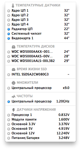

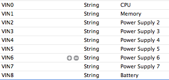

Now I know 5V value is 4.919V on my system and 12V is 12.239V. Voltage input for 5V is VIN3 and 12V should be VIN5. How to calculate Gain value? The formula is: Gain = ( Vref - Vraw ) / Vraw, there Vref is the reference voltage value obtained from BIOS or dumps and Vraw is the raw value read from specific voltage input. My Vraw values looks like this (sorry for russian):
The 5th voltage is VIN3 (Power Supply 4 in HWMonitor.app) and 7th voltage is VIN5 (Power Supply 6 in HWMonitor.app)

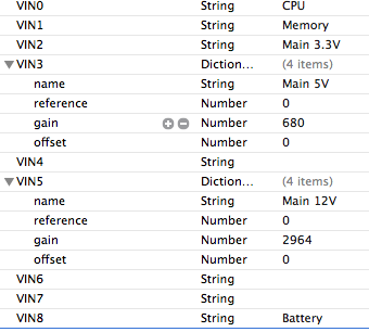

To get picture above you need to edit SuperIOSensors section for your Super I/O chip. It should be like this:
Note: Power Supply %x names always showing greater to 1 in HWMonitor.app. You must close all programs running and wait for voltages to stop changing their values.
On the full system load It should be voltage drop on 3.3V, 5V and 12V rails depending on your graphics and power supply used. Then I am running Prime95 and Unigine Heaven at the same time I am get something like this:
As you could see there is Vdrop on VIN2 (3.3V), VIN3 (5V) and VIN5 (12V).
3.3V is ok without any modifiers using on VIN2.
For 12V input I have now: Gain = (12.239 - 3.088) / 3.088 = 2,9634067357513 ~ 2.964
For 5V input I have: Gain = (4.919 - 2.928) / 2.928 = 0,67998633879781 ~ 0.680
So I should edit my IT87x section like this:
And the result:

Thanks for your great work! Working perfectly on my MB.
Question: I'm seeing some screenshots with voltage temperatures.
What info do you need to have to get this working for my MB? (ASUS P8H67-M Pro B3)
I also have Windows 7 x64 installed, and I'm willing to provide you with any info.
It would be great to let it shown voltages. :D
Thanks!
Thanks!
See post #264: I need BIOS screenshot with voltages (if it shows something), OpenHardwareMonitor or/and HWMonitor or/and AIDA64 dumps from Windows.
