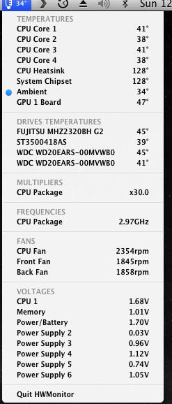

sacaman1 Posted March 17, 2012 Share Posted March 17, 2012 hi Kozlak strange think after crossing the 45 C i get a strange value please can you check this Link to comment Share on other sites More sharing options...
mrmojorisin17 Posted March 19, 2012 Share Posted March 19, 2012 Hi kozlek. Will you add support of HWMonitor to Snow Leopard 10.6.x? Link to comment Share on other sites More sharing options...
kozlek Posted March 19, 2012 Author Share Posted March 19, 2012 hi Kozlak strange think after crossing the 45 C i get a strange value please can you check this Sorry, sacaman1, I can't help you now. Looks like your hardware reports wrong values. Hi kozlek. Will you add support of HWMonitor to Snow Leopard 10.6.x? Did you tested it on 10.6.x? Not to compile for 10.6 but use binaries from the package? Link to comment Share on other sites More sharing options...

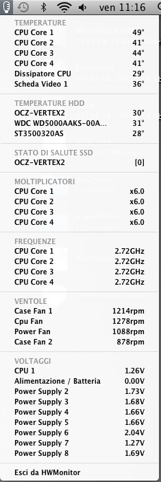

buoo Posted March 20, 2012 Share Posted March 20, 2012 Hi Kozlek this is the Italian translation "TEMPERATURES" = "ТЕMPERATURE"; "DRIVES TEMPERATURES" = "ТЕМPERATURE HDD"; "SSD REMAINING LIFE" = "STATO DI SALUTE SSD"; "MULTIPLIERS" = "MOLTIPLICATORI"; "FREQUENCIES" = "FREQUENZE"; "VOLTAGES" = "VOLTAGGI"; "FANS" = "VENTOLE"; "CPU Heatsink" = "Dissipatore CPU"; "GPU %X Board" = "Scheda Video %X"; "GPU %X Core" = "GPU %X Core"; "GPU %X Proximity" = "Sensore GPU%X"; "Northbridge" = "Northbridge"; "System Chipset" = "Chipset di Sistema"; "CPU Package" = "CPU"; "CPU %X" = "CPU %X"; "CPU Core %X" = "CPU Core %X"; "Fan %X" = "Ventola %X"; "CPU" = "CPU"; "DIMM Modules" = "Moduli di Memoria"; "Power/Battery" = "Alimentazione / Batteria"; "Quit HWMonitor" = "Esci da HWMonitor"; "No sensors found" = "Nessun sensore disponibile"; Italian_Translation.txt.zip Link to comment Share on other sites More sharing options...

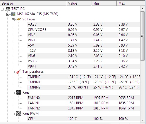

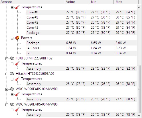

sacaman1 Posted March 20, 2012 Share Posted March 20, 2012 And what's showing OpenHardwareMonitor in Windows, could you check please? this is the windows data Link to comment Share on other sites More sharing options...
kozlek Posted March 21, 2012 Author Share Posted March 21, 2012 this is the windows data Please try the new version and tell me what you'll see. Link to comment Share on other sites More sharing options...
sacaman1 Posted March 21, 2012 Share Posted March 21, 2012 Please try the new version and tell me what you'll see. this is the result Link to comment Share on other sites More sharing options...
kozlek Posted March 22, 2012 Author Share Posted March 22, 2012 this is the result And it's ok? Seems system temperature is lower then it should be.. P.S. Sorry, sacaman1, I erroneously tought that you have Nuvoton chip. Still no changes for you. Link to comment Share on other sites More sharing options...

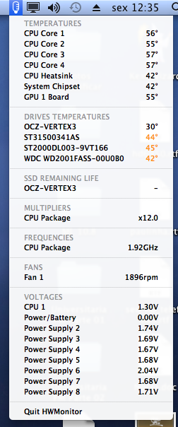

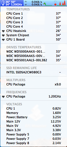

PiSToLBR Posted March 22, 2012 Share Posted March 22, 2012 My results (System specs in my signature): Build 8d05bbd Build 0d2a0b1 Localization to PT (Português) "TEMPERATURES" = "TEMPERATURAS"; "DRIVES TEMPERATURES" = "TEMPERATURAS DOS DISCOS"; "SSD REMAINING LIFE" = "DURAÇÃO PREVISTA DO SSD"; "MULTIPLIERS" = "MULTIPLICADORES"; "FREQUENCIES" = "FREQUêNCIAS"; "VOLTAGES" = "VOLTAGENS"; "FANS" = "VENTILADORES"; "CPU Heatsink" = "Dissipador da CPU"; "GPU %X Board" = "GPU %X Placa"; "GPU %X Core" = "GPU %X Núcleo"; "GPU %X Proximity" = "Sensor %X da GPU"; "Northbridge" = "Northbridge"; "System Chipset" = "Chipset do Sistema"; "Ambient" = "Ambiente"; "CPU Package" = "CPU"; "CPU %X" = "CPU %X"; "CPU Core %X" = "Núcleo da Cpu %X"; "Fan %X" = "Ventilador %X"; "CPU" = "CPU"; "Memory" = "Memoria RAM"; "Power/Battery" = "AlimentaÇÃo/Bateria"; "Quit HWMonitor" = "Sair do HWMonitor"; "No sensors found" = "NÃo há sensores disponíveis"; "Main 12V" = "Principal 12V"; "PCIe 12V" = "PCIe 12V"; "Main 5V" = "Principal 5V"; "Standby 5V" = "Repouso 5V"; "Main 3.3V" = "Principal 3,3V"; "Auxiliary 3.3V" = "Auxiliar 3,3V"; "VRM Supply %X" = "AlimentaÇÃo VRM %X"; "Power Supply %X" = "Fonte de alimentaÇÃo %X"; Link to comment Share on other sites More sharing options...

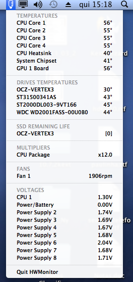

stefano.85 Posted March 22, 2012 Share Posted March 22, 2012 The same situation also on my system in rig. With the latest revision no more power supply voltages Also another question: how can i force to display all cpu cores in the HWmonitor app? tnx Link to comment Share on other sites More sharing options...

kozlek Posted March 23, 2012 Author Share Posted March 23, 2012 The same situation also on my system in rig. With the latest revision no more power supply voltages Also another question: how can i force to display all cpu cores in the HWmonitor app? tnx Try latest revision. HI! Can you help me to detect my mobility radeon 4570 on GPU stat? (id 95531002) Thank you very much This ID is already in the supported list in RadeonX plugin. HWMonitor should show GPU temperature and you should see RadeonMonitor related messages in kernel log. Link to comment Share on other sites More sharing options...
stefano.85 Posted March 23, 2012 Share Posted March 23, 2012 Works like a charm, really really a good work kozlek! nothing to say Link to comment Share on other sites More sharing options...

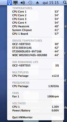

PiSToLBR Posted March 23, 2012 Share Posted March 23, 2012 Working fine now. I have several other fans that are not showing. Is there a way I can contribute ? Revision c273f7d: Link to comment Share on other sites More sharing options...

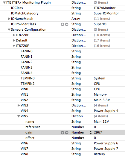

kozlek Posted March 24, 2012 Author Share Posted March 24, 2012 I just added new feature to Super I/O plugins - value modifiers. Modifiers could be set in "Sensors Configuration" section of SuperIOFamily's info.plist. It's impossible to use universal modifiers because different motherboard manufacturers have different implementations also for the same Super I/O chip models on different mobos. So it's up you to found proper modifiers values. There is couple of well known modifiers values for some mobos and Super I/O chipsets could be obtained from OpenHardwareMonitor project (see SuperIOHardware.cs file). The formula used is: offset + value + (value - reference) * gain, there is value is the unmodified value read from the registers. The formula used in OpenHardwareMonitor for voltage is a bit different. For example in OpenHardwareMonitor: v.Add(new Voltage("+12V", 5, 27, 9.1f)) , second parameter (5) is VIN5, the 3rd parameter and 4th is the gain = 27 / 9.1 = 2.967. In the info.plist you should set 2.967 * 1000 (because of info.plist's Number could get only integer values): At the end you could get a picture like this: 1 Link to comment Share on other sites More sharing options...
