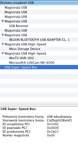

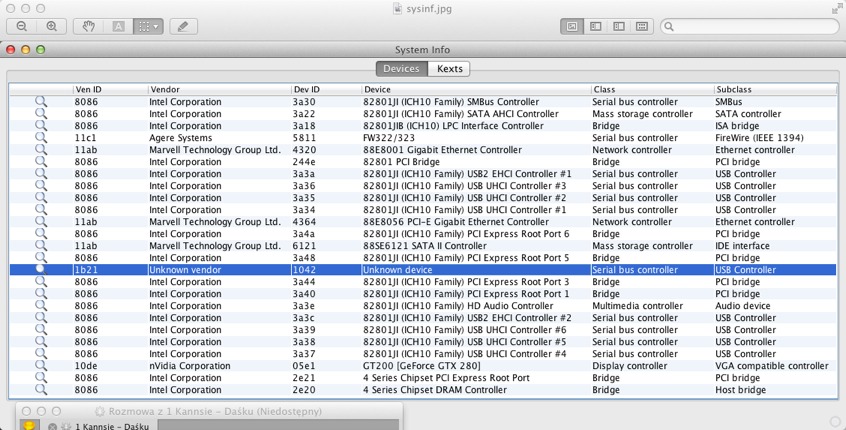

koliberK Posted June 12, 2012 Share Posted June 12, 2012 Hi, Andy how to change Vendor and Device Name ? As in my 10.7.4 this show up as unknown. Link to comment Share on other sites More sharing options...

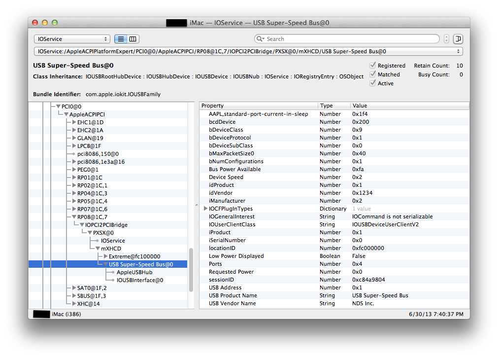

Gringo Vermelho Posted June 30, 2013 Share Posted June 30, 2013 Thanks Riley. This works on P8Z77-V Pro. The ASMedia 1042 is located at RP08: However, System Information reports "Up to 480 Mb/sec" for my SanDisk Extreme USB 3.0 flash drive (love this thing, it's so fast!), which is wrong. This happens with both the Oyen and CalDigit drivers - when I plug it into one of the Intel ports i get "Up to 5 Gb/sec". Maybe I should be using these? http://www.insanelymac.com/forum/topic/286860-genericusbxhci-usb-30-driver-for-os-x-with-source/ Link to comment Share on other sites More sharing options...
