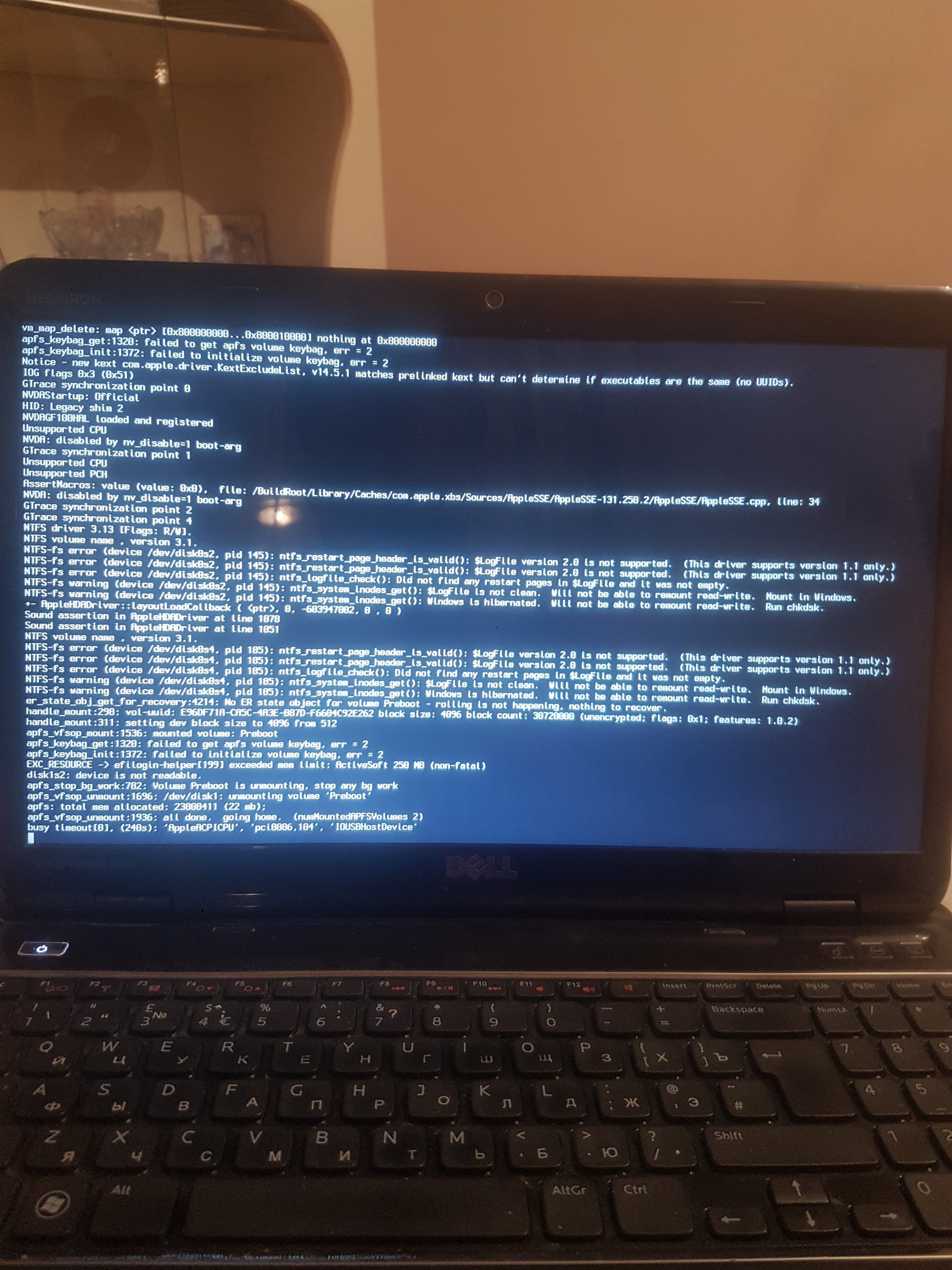

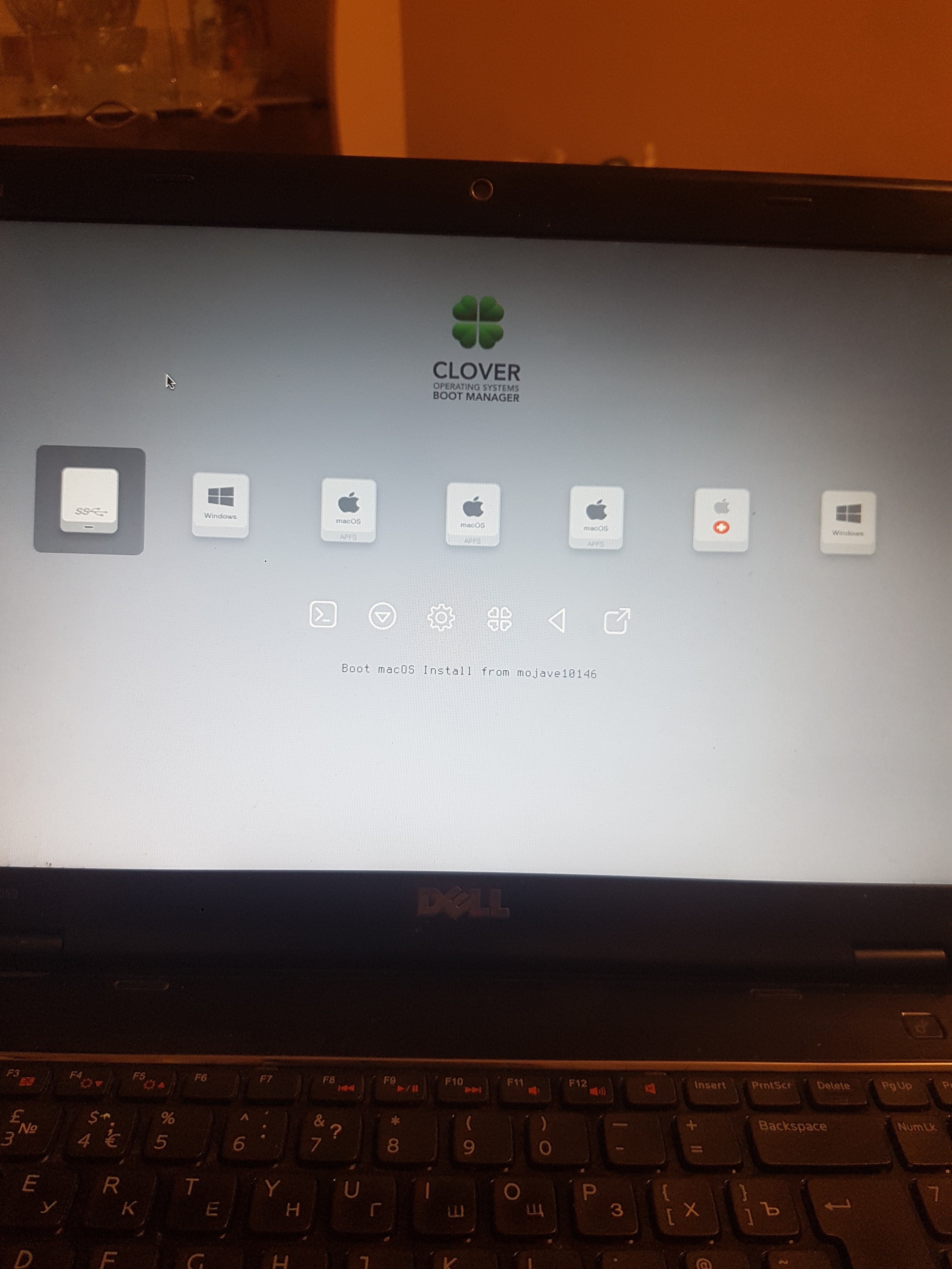

Akosh114 Posted August 21, 2019 Share Posted August 21, 2019 hello to everyone friends dell inispiron n5110 notebook i use my computer mac os x high sierra kulu was running smoothly now i wanted to install mac os x mojave setup the computer seamlessly booted from the computer problem when I amma can not reach the table please help. Available Date / Date: 21 Aug 20 19 Carsamba, 16:01:13 Computer Name: DESKTOP-NN51GFS Windows 10 Pro 64bit (10.0, Build 10240) 1slebm System Language: English (Boigesel Tuning System System System: Dell Inc. System Model: Inspiron N5110 BIOS: A11 Processor: Intel (R) Core9 5-2430M CPU 240GH 2Hz Ram: 4096MB RAM Paging file 4718MB usable 2996MB DirectX Directly printing your digital signatures Link to comment https://www.insanelymac.com/forum/topic/271573-guide-dell-inspiron-n5110/page/131/#findComment-2686817 Share on other sites More sharing options...
Kakaro Posted August 21, 2019 Share Posted August 21, 2019 (edited) 3 hours ago, Akosh114 said: hello to everyone friends dell inispiron n5110 notebook i use my computer mac os x high sierra kulu was running smoothly now i wanted to install mac os x mojave setup the computer seamlessly booted from the computer problem when I amma can not reach the table please help. Available Date / Date: 21 Aug 20 19 Carsamba, 16:01:13 Computer Name: DESKTOP-NN51GFS Windows 10 Pro 64bit (10.0, Build 10240) 1slebm System Language: English (Boigesel Tuning System System System: Dell Inc. System Model: Inspiron N5110 BIOS: A11 Processor: Intel (R) Core9 5-2430M CPU 240GH 2Hz Ram: 4096MB RAM Paging file 4718MB usable 2996MB DirectX Directly printing your digital signatures Explain the method you are using to install Mojave. Clover version, what are the kext you are using Edited August 21, 2019 by Kakaro Link to comment https://www.insanelymac.com/forum/topic/271573-guide-dell-inspiron-n5110/page/131/#findComment-2686827 Share on other sites More sharing options...
Akosh114 Posted August 21, 2019 Share Posted August 21, 2019 thank you for the answer I used the raw file ready osxinfo10146.raw clover version 2.5k rev 5018 in the other folder just kext fakesmc no more Link to comment https://www.insanelymac.com/forum/topic/271573-guide-dell-inspiron-n5110/page/131/#findComment-2686832 Share on other sites More sharing options...
Kakaro Posted August 21, 2019 Share Posted August 21, 2019 32 minutes ago, Akosh114 said: thank you for the answer I used the raw file ready osxinfo10146.raw clover version 2.5k rev 5018 in the other folder just kext fakesmc no more N5110 HD3000 is not supported by Mojave. You should use the installation method suggested by nanotech Link to comment https://www.insanelymac.com/forum/topic/271573-guide-dell-inspiron-n5110/page/131/#findComment-2686834 Share on other sites More sharing options...

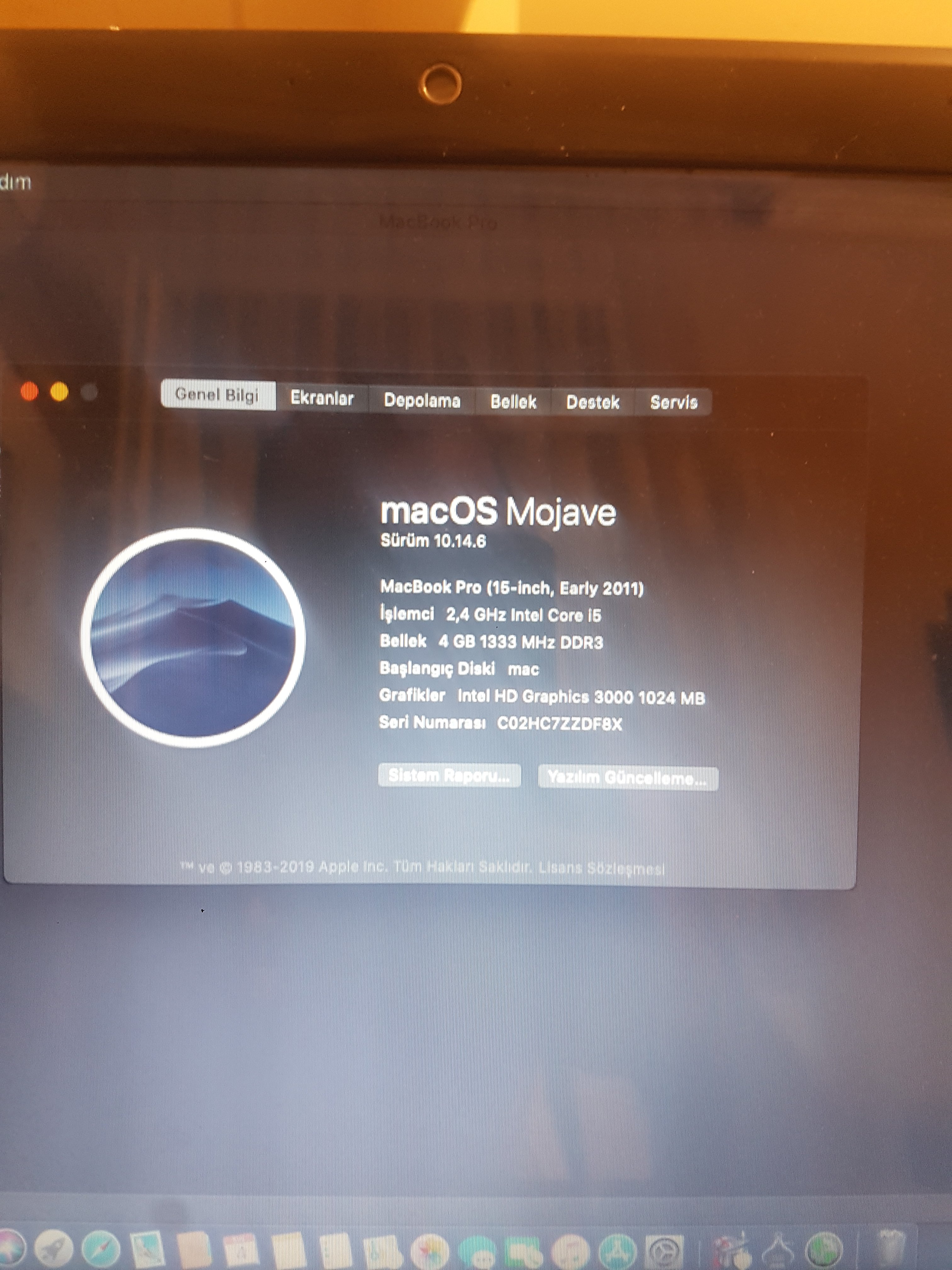

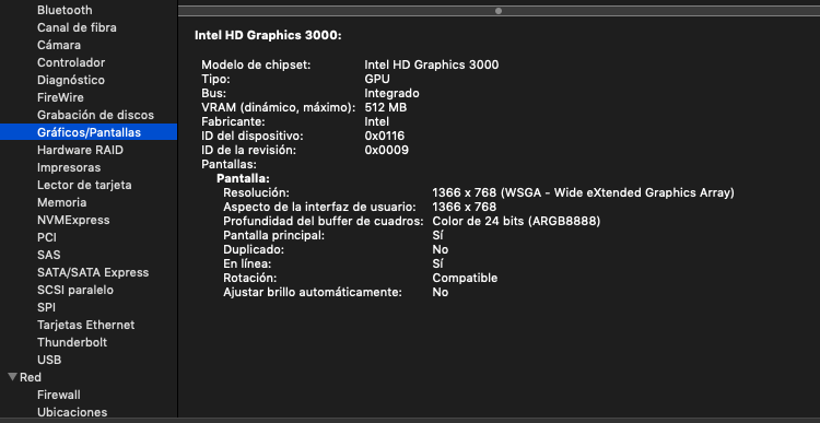

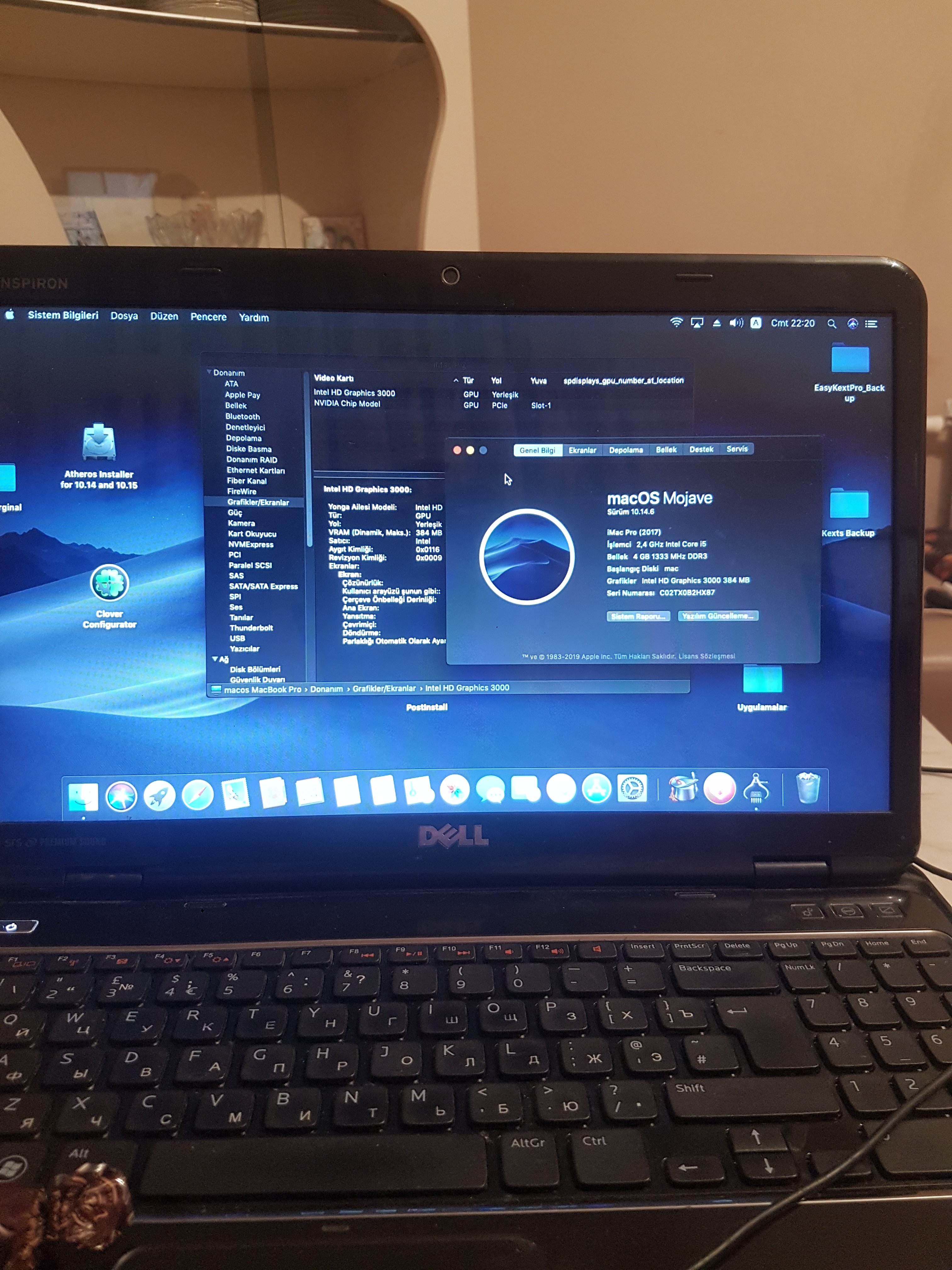

Akosh114 Posted August 24, 2019 Share Posted August 24, 2019 hello everyone thanks Kakaro n5110 mac os x mojave successfully installed but can not identify the Intel hd 3000 graphics card please help please hd hd 3000 384 mb problem Link to comment https://www.insanelymac.com/forum/topic/271573-guide-dell-inspiron-n5110/page/131/#findComment-2687203 Share on other sites More sharing options...

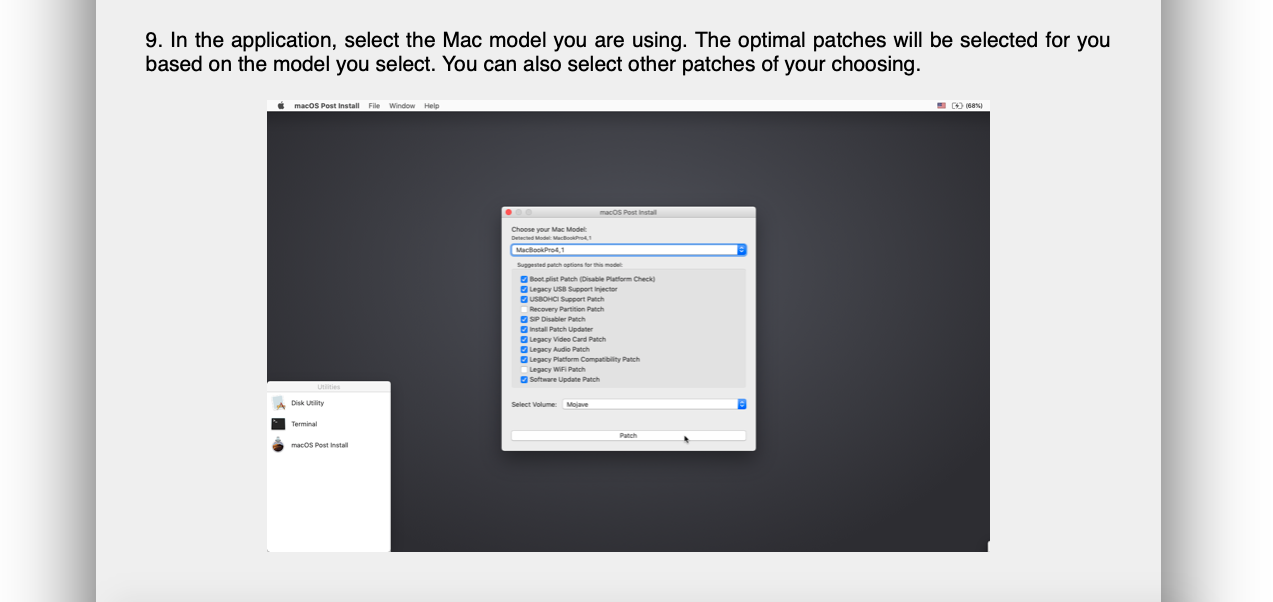

Kakaro Posted August 24, 2019 Share Posted August 24, 2019 (edited) 4 hours ago, Akosh114 said: hello everyone thanks Kakaro n5110 mac os x mojave successfully installed but can not identify the Intel hd 3000 graphics card please help please hd hd 3000 384 mb problem Did you use the dosdude1 tool when rebooting the system? You have to patch using macOS Mojave Patcher Notice that you have installed the system as if it were an imac You must do it as MacBook pro 8.1 No problem you have only 384 MB of memory in HD3000, you only have 4GB of ram installed. To upload to 512 MB in HD3000, increase the RAM memory by at least 8GB Edited August 24, 2019 by Kakaro Link to comment https://www.insanelymac.com/forum/topic/271573-guide-dell-inspiron-n5110/page/131/#findComment-2687225 Share on other sites More sharing options...

Akosh114 Posted August 25, 2019 Share Posted August 25, 2019 thank you imac the reason for the appearance of config pelis I have set yes mac os mojave phatc used 384 mb image card is normal why my computer is running delayed and color discoloration Link to comment https://www.insanelymac.com/forum/topic/271573-guide-dell-inspiron-n5110/page/131/#findComment-2687320 Share on other sites More sharing options...

Akosh114 Posted August 29, 2019 Share Posted August 29, 2019 Hi Kakaro Would the VRAM enhancement benefit the computer to work faster? 384 mb is working very slowly thanks Link to comment https://www.insanelymac.com/forum/topic/271573-guide-dell-inspiron-n5110/page/131/#findComment-2687727 Share on other sites More sharing options...
Akosh114 Posted August 29, 2019 Share Posted August 29, 2019 Thanks for your reply intel hd 3000 How much gb support ? How much can I upgrade with 8gb ram Link to comment https://www.insanelymac.com/forum/topic/271573-guide-dell-inspiron-n5110/page/131/#findComment-2687746 Share on other sites More sharing options...
Kakaro Posted August 29, 2019 Share Posted August 29, 2019 5 hours ago, Akosh114 said: Thanks for your reply intel hd 3000 How much gb support ? How much can I upgrade with 8gb ram You can only patch HD3000 if you use MacOS High Sierra or earlier version. Mojave not since this card is not supported. It is being forced to be recognized You need upgrade the ram to 8GB Link to comment https://www.insanelymac.com/forum/topic/271573-guide-dell-inspiron-n5110/page/131/#findComment-2687784 Share on other sites More sharing options...

Kakaro Posted September 3, 2019 Share Posted September 3, 2019 Use this guide to increase vram HD3000 https://forums.macrumors.com/threads/how-to-increase-vram-for-hd3000-graphics.1766384/page-9#post-27519603 Link to comment https://www.insanelymac.com/forum/topic/271573-guide-dell-inspiron-n5110/page/131/#findComment-2688458 Share on other sites More sharing options...

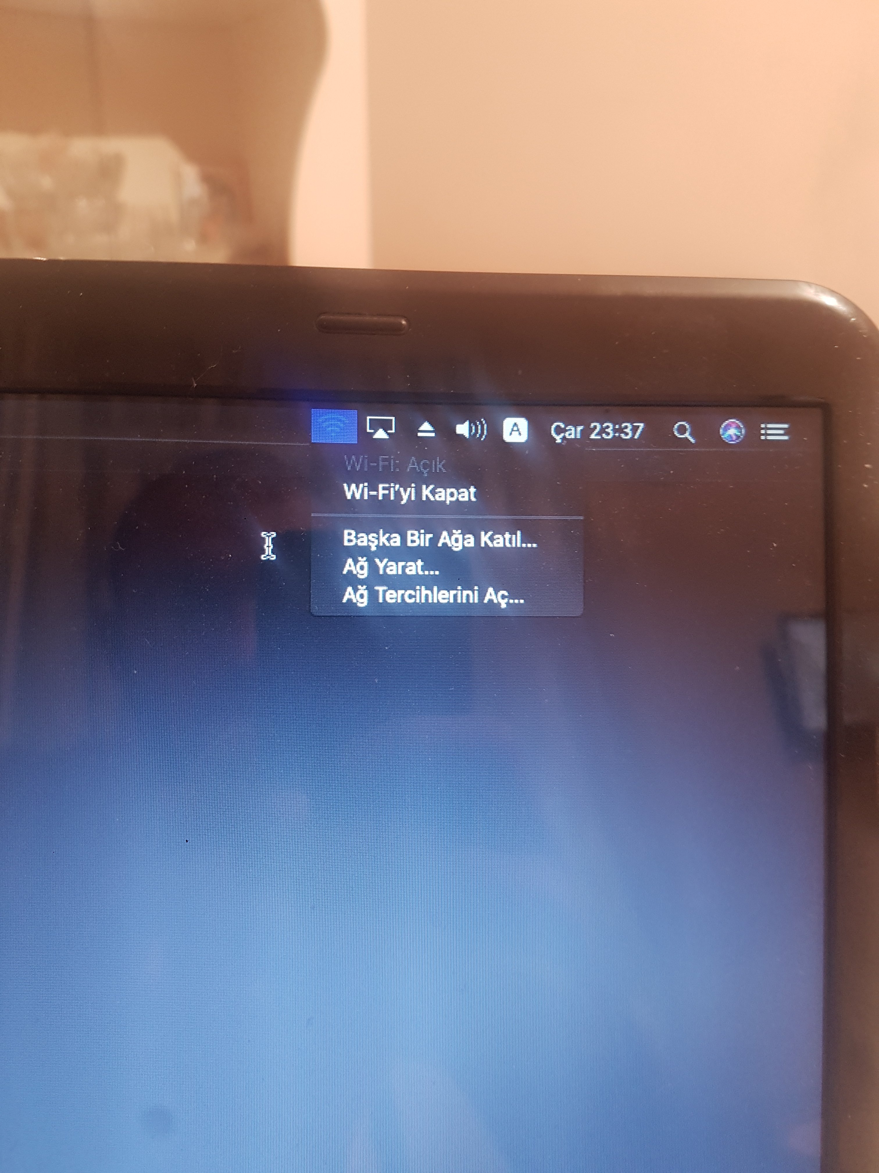

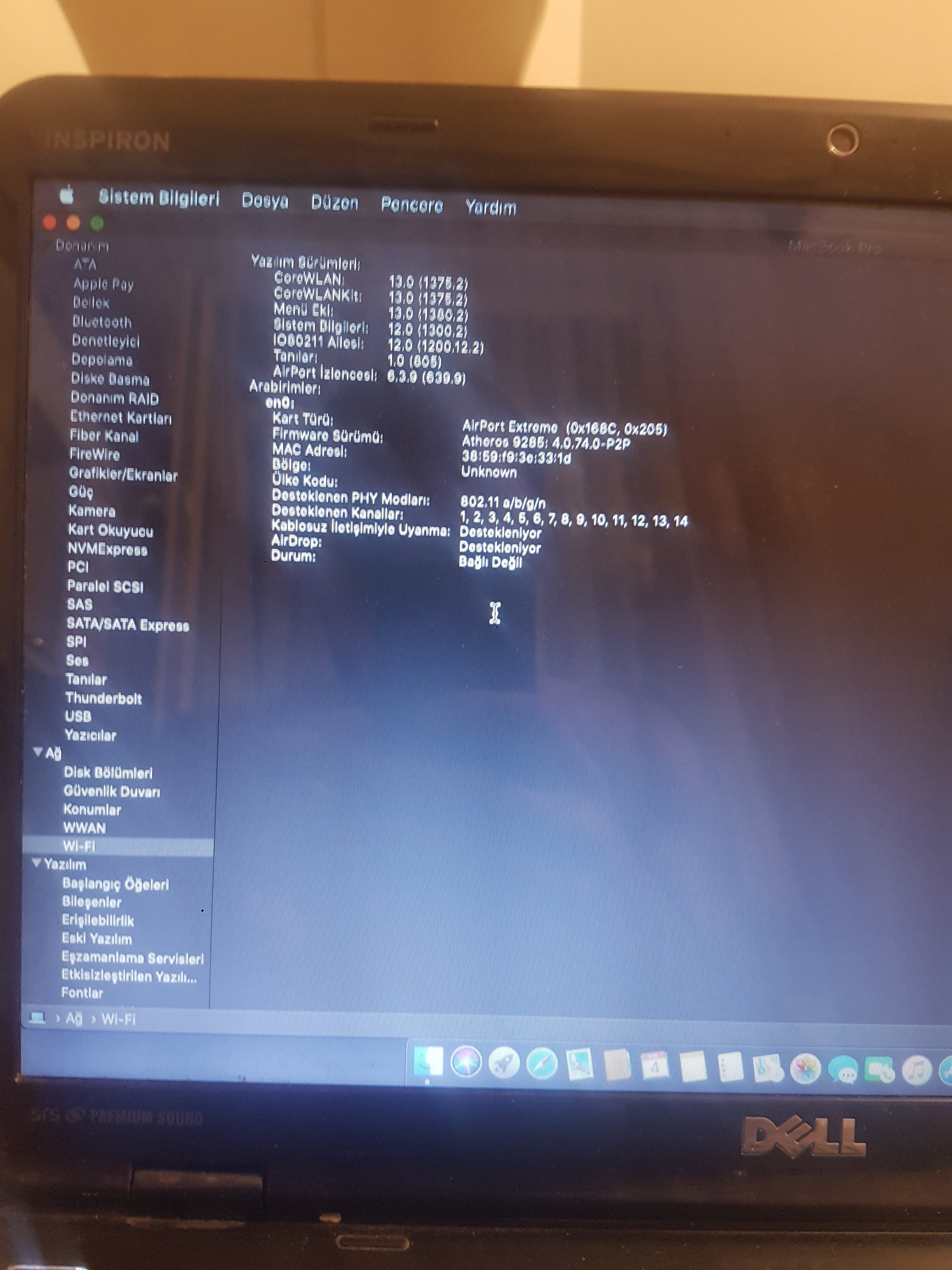

Akosh114 Posted September 4, 2019 Share Posted September 4, 2019 hello to everyone thanks to everyone who helped you first thanks 1024mb video card I made the only problem wifi is opening but does not find any network what is the problem Link to comment https://www.insanelymac.com/forum/topic/271573-guide-dell-inspiron-n5110/page/131/#findComment-2688687 Share on other sites More sharing options...
Akosh114 Posted September 5, 2019 Share Posted September 5, 2019 I solved wifi problem wifi was closed to winfows system I opened it from windows system mac os system worked please can you give me the kext that trackpad works? Thanks Link to comment https://www.insanelymac.com/forum/topic/271573-guide-dell-inspiron-n5110/page/131/#findComment-2688871 Share on other sites More sharing options...
