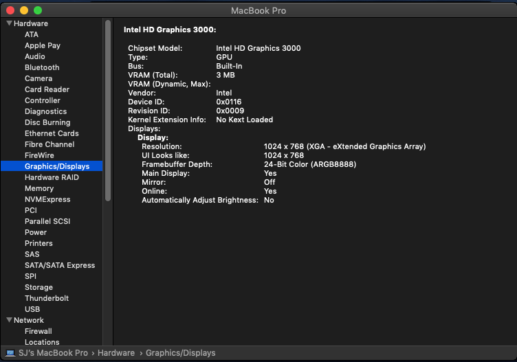

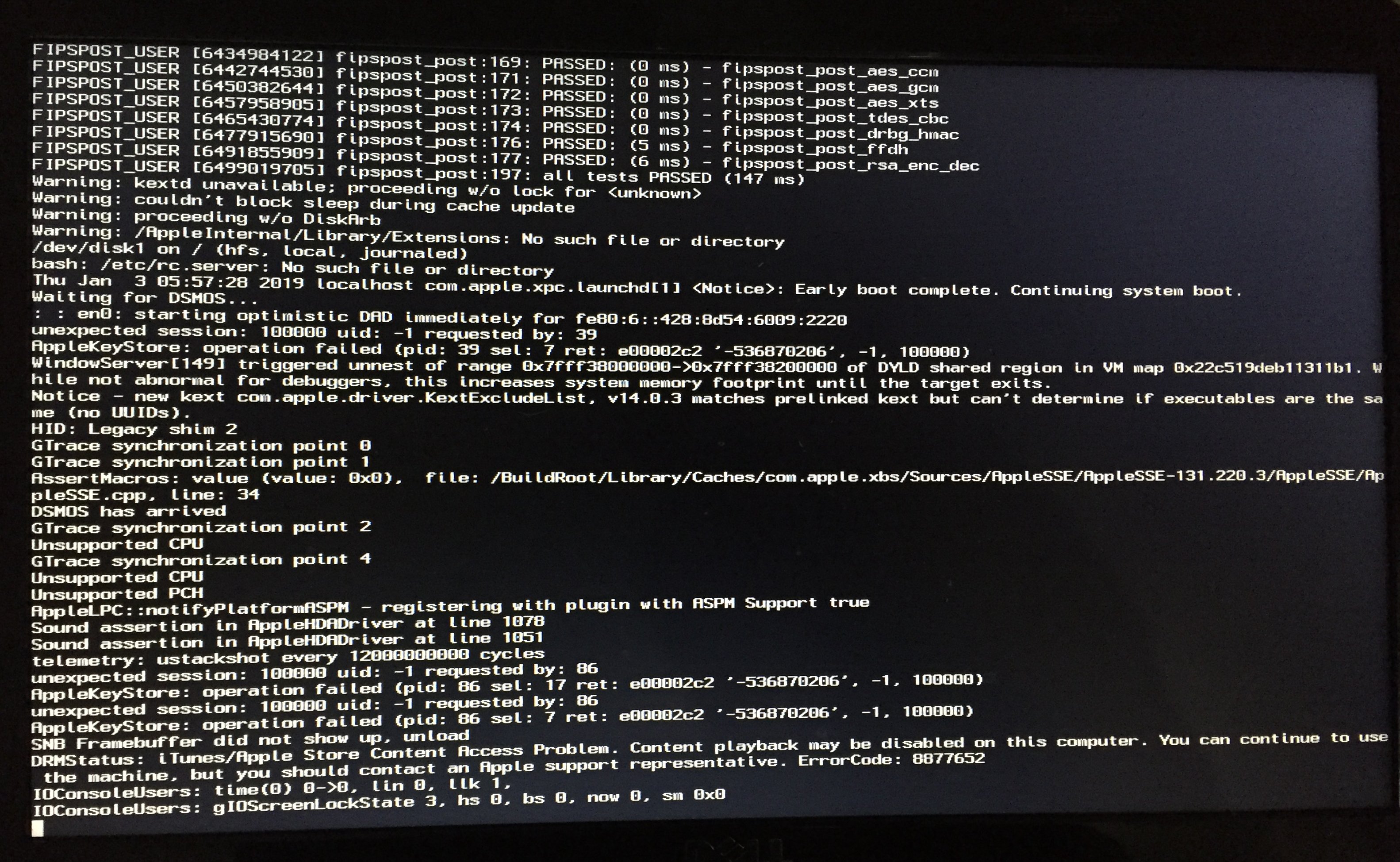

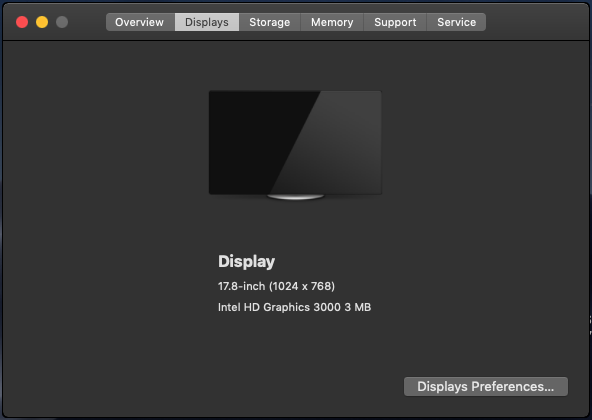

omdsmr Posted January 3, 2019 Share Posted January 3, 2019 On 12/31/2018 at 6:45 PM, Hervé said: Try the following: Replace your DSDT with this one where I've removed the snb-layout-id injection (done through Clover): DSDT.aml.zip Remove your SSDT-4.aml table from Clover's ACPI/patched folder Generate your CPU-specific power management SSDT with Pike R Alpha's well-known generator script (place it as "ssdt.aml" in ACPI/patched folder) Replace your Clover config with this one: config.plist.zip If you still don't get any graphics acceleration, try faking HD3000 0x0126 again through Clover. Use latest version of Clover Configurator. hi,Hervé thank you for your help. I tried your method,Replace my file with your file. but I still don't get any graphics acceleration,so I try faking hd3000 0x0126 (By modifying intelGFX = 0x01268086 ) and 0x0116 (By modifying intelGFX = 0x01168086 ),but The result is still not fixed,The problem still exists. When S/L/E have : AppleIntelSNBGraphicsFB.kext I can't enter my computer, the computer is stuck at “IOConsoleUsers: gIOScreenLockState 3, hs 0, bs 0, now 0, sm 0x0” So I delete AppleIntelSNBGraphicsFB.kext Then I can enter my computer. But My computer resolution is only 1024*768, my graphics card hd 3000 memory is only 3MB : Thank you for spending so much time helping me solve the problem. thank you very much! Link to comment Share on other sites More sharing options...

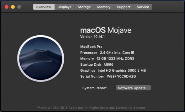

ezee Posted February 3, 2019 Share Posted February 3, 2019 (edited) Has anybody got intel graphics acceleration?...for me animations/firefox are sluggish 10.14.2 Edited February 3, 2019 by ezee Link to comment Share on other sites More sharing options...

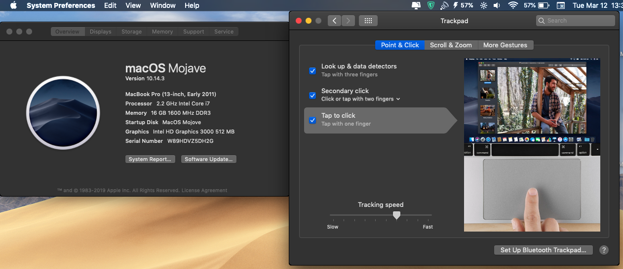

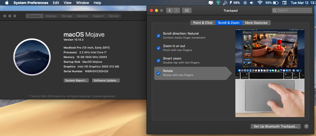

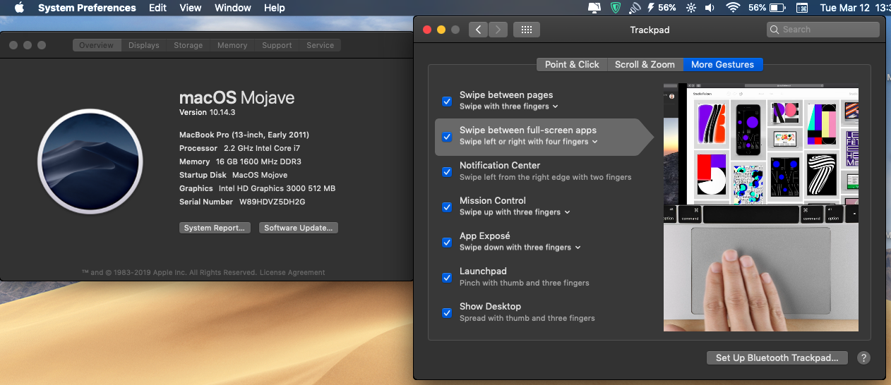

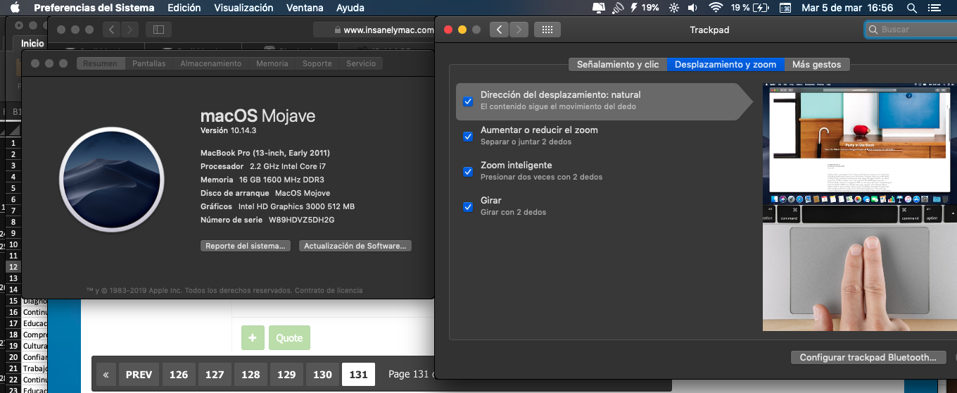

Kakaro Posted February 7, 2019 Share Posted February 7, 2019 Wow the trackpad work perfect. Scroll up, scroll down, scroll vertical and horizontal with two fingers, tap with one and two fingers. Gesture with tree fingers (change page in Safari, change music in Spotify, etc. Work in macOS Mojave 10.14.3 VoodooPS2Controller.kext.zip Link to comment Share on other sites More sharing options...
Kakaro Posted March 5, 2019 Share Posted March 5, 2019 1 Link to comment Share on other sites More sharing options...

Kakaro Posted March 12, 2019 Share Posted March 12, 2019 VoodooPS2Controller.kext.zip works great N5110 Alps Touchpad Link to comment Share on other sites More sharing options...

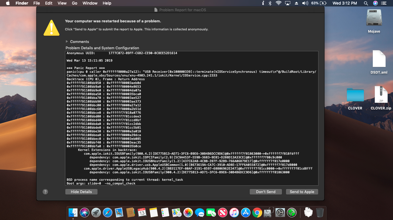

remonsaeed Posted March 13, 2019 Share Posted March 13, 2019 after reboot show this message Link to comment Share on other sites More sharing options...

Kakaro Posted March 13, 2019 Share Posted March 13, 2019 (edited) 6 hours ago, remonsaeed said: hi there can help me plz my laptop dell n5110 core i5 have nividia vga 525m system os mojave thank you this error Use this clover folder, only replace DSDT and SSDT in ACPI patched Core i5. My laptop use core i7 2670QM don´t work in your N5110. Don't install or use more kexts. Refer to this guide http://dosdude1.com/mojave/ to install correctly. Mojave don´t funtion with HD3000 (N5110) Visit post #1 to obtain DSDT and SSDT (pre–install) CLOVER.zip Edited March 13, 2019 by Kakaro Link to comment Share on other sites More sharing options...
remonsaeed Posted March 14, 2019 Share Posted March 14, 2019 15 hours ago, Kakaro said: Use this clover folder, only replace DSDT and SSDT in ACPI patched Core i5. My laptop use core i7 2670QM don´t work in your N5110. Don't install or use more kexts. Refer to this guide http://dosdude1.com/mojave/ to install correctly. Mojave don´t funtion with HD3000 (N5110) Visit post #1 to obtain DSDT and SSDT (pre–install) CLOVER.zip thank you bro Link to comment Share on other sites More sharing options...
