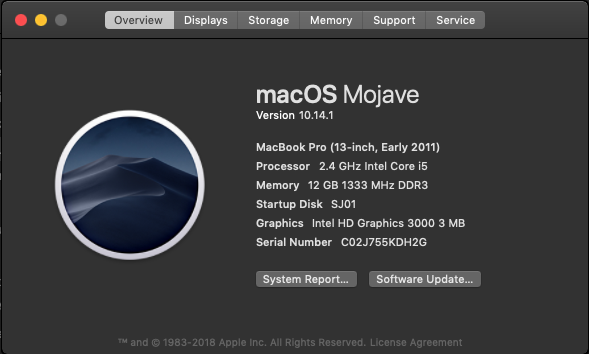

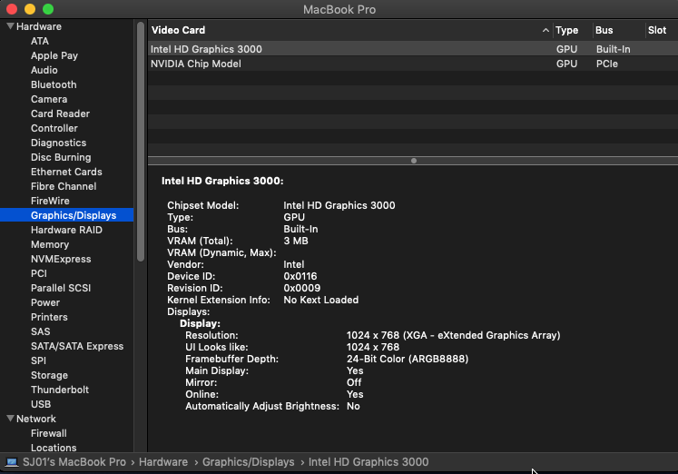

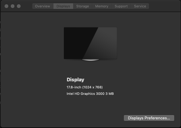

omdsmr Posted December 28, 2018 Share Posted December 28, 2018 (edited) Hello nanotech, my N5110 with spects: Intel Core i5-2430M processor 15.6-inch 1366×768 display with LED backlighting. Intel HD 3000 integrated graphics & Nvidia GT525m . 12GB DDR3 memory (1333MHz). 128G SSD . with your 127 page guide, I can install MacOS Mojave, But I have encountered some problems and can't solve it all the time. I have already installed all SNB/HD3000 kexts from a previous macOS version to /S/L/E: AppleIntelHD3000Graphics.kext AppleIntelHD3000GraphicsGA.plugin AppleIntelHD3000GraphicsGLDriver.bundle AppleIntelHD3000GraphicsVADriver.bundle AppleIntelSNBGraphicsFB.kext AppleIntelSNBVA.bundle But When S/L/E have : AppleIntelSNBGraphicsFB.kext I can't enter my computer, the computer is stuck at “IOConsoleUsers: gIOScreenLockState 3, hs 0, bs 0, now 0, sm 0x0” So I delete AppleIntelSNBGraphicsFB.kext Then I can enter my computer. But My computer resolution is only 1024*768, my graphics card hd 3000 memory is only 3MB : My graphics card hd 3000 configuration: My EFI file: EFI-clover-4722.zip can you help me? thank you very much! Edited December 29, 2018 by omdsmr Link to comment Share on other sites More sharing options...
ezee Posted December 28, 2018 Share Posted December 28, 2018 2 hours ago, omdsmr said: Hello nanotech, my N5110 with spects: Intel Core i5-2430M processor 15.6-inch 1366×768 display with LED backlighting. Intel HD 3000 integrated graphics & Nvidia GT525m . 12GB DDR3 memory (1333MHz). 128G SSD . with your 127 page guide, I can install MacOS Mojave, but But I have encountered some problems and can't solve it all the time. When S/L/E have : AppleIntelSNBGraphicsFB.kext I can't enter my computer, the computer is stuck at “IOConsoleUsers: gIOScreenLockState 3, hs 0, bs 0, now 0, sm 0x0” So I delete AppleIntelSNBGraphicsFB.kext Then I can enter my computer. But My computer resolution is only 1024*768, my graphics card hd 3000 memory is only 3MB : My graphics card hd 3000 configuration: My EFI file: EFI-clover-4722.zip can you help me? thank you very much! Use whatevergreen.kext. There are two SNB kext in 10.12.x use both not just one. I am not seeing any issue in light mode. Anybody has got nice touchpad? please share kext. I don't know how to tune-up ps2controller kext to suite our touchpad. Link to comment Share on other sites More sharing options...

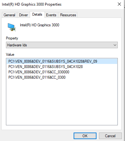

omdsmr Posted December 29, 2018 Share Posted December 29, 2018 7 hours ago, Hervé said: You need to install all SNB/HD3000 kexts as provided here: https://osxlatitude.com/forums/topic/10726-macos-1014-mojave-betas-releases/?do=findComment&comment=83039 hey,Hervé ,I have already installed all SNB/HD3000 kexts from a previous macOS version to /S/L/E: AppleIntelHD3000Graphics.kext AppleIntelHD3000GraphicsGA.plugin AppleIntelHD3000GraphicsGLDriver.bundle AppleIntelHD3000GraphicsVADriver.bundle AppleIntelSNBGraphicsFB.kext AppleIntelSNBVA.bundle but When S/L/E have : AppleIntelSNBGraphicsFB.kext I can't enter my computer, the computer is stuck at “IOConsoleUsers: gIOScreenLockState 3, hs 0, bs 0, now 0, sm 0x0” So I delete AppleIntelSNBGraphicsFB.kext Then I can enter my computer. But My computer resolution is only 1024*768, my graphics card hd 3000 memory is only 3MB . Sad, I still can't fix it. Why Link to comment Share on other sites More sharing options...

omdsmr Posted December 30, 2018 Share Posted December 30, 2018 20 hours ago, Hervé said: Try faking mobile Intel HD3000 graphics 0x0126. By modifying intelGFX = 0x01268086 right? I tried, but unfortunately still did not solve the problem. thank you for your help! Link to comment Share on other sites More sharing options...

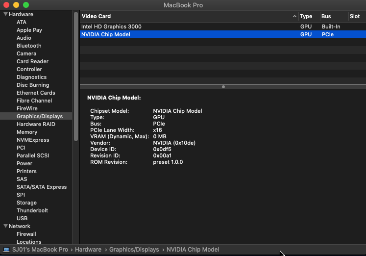

ezee Posted January 1, 2019 Share Posted January 1, 2019 (edited) why there you have Nvidia showing ? use this patch SSDT_DGPU.aml Also in BIOS Set Initial Display Output to IGFX Set Internal Graphics to Auto/Enabled Set DVMT Pre-Allocated to 64MB Set DVMT Total Gfx Memory to 256/128MB Edited January 1, 2019 by ezee Link to comment Share on other sites More sharing options...

omdsmr Posted January 3, 2019 Share Posted January 3, 2019 On 1/1/2019 at 2:13 PM, ezee said: why there you have Nvidia showing ? use this patch SSDT_DGPU.aml Also in BIOS Set Initial Display Output to IGFX Set Internal Graphics to Auto/Enabled Set DVMT Pre-Allocated to 64MB Set DVMT Total Gfx Memory to 256/128MB thank you for your help! Through your patch now my computer only has hd3000 graphics card but Unfortunately, I still didn't solve my problem. When S/L/E have : AppleIntelSNBGraphicsFB.kext I can't enter my computer, the computer is stuck at “IOConsoleUsers: gIOScreenLockState 3, hs 0, bs 0, now 0, sm 0x0” So I delete AppleIntelSNBGraphicsFB.kext Then I can enter my computer. But My computer resolution is only 1024*768, my graphics card hd 3000 memory is only 3MB : I tried a lot of methods through Google, but still can't solve it. Really desperate,sad Link to comment Share on other sites More sharing options...
