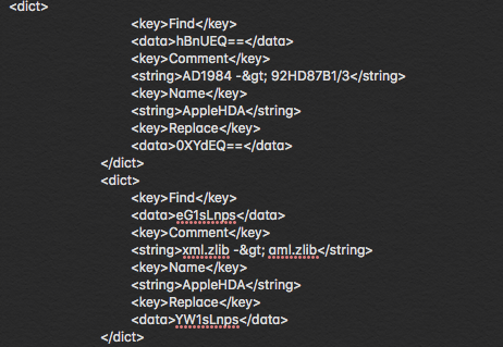

Hi nonotech, there is way to have audio in MacOS Mojave with the patched AppleHDA kext? Voodoohda throws horrible audio
Hi Kakaro,  tried patching it by the latest AppleHDA  patcher by Mirone but our codecs of  IDT 92HD87B1/3 ( 76D1 layout 12) not supported ( not listed into the laptops section of the patcher) .
Unfortunately Googling this " IDT 92HD87B1/3 with Mojave "  revel nothing at all . it needs some informations
Still searching , then update
Yeah .... its totally unsupported by Mirone in his patcher !! it throws this message :
"Found unsupported "layout-id = 12" in ioreg, will not work using Mirone's patches!!!".
 I will try other way .

1 hour ago, nanotech said:
Thanks hervé , looks very promising ,Yeah, its for unsupported codecs, and our layout is supported via this patcher
So lets do some fun then update :thumbsup_anim:

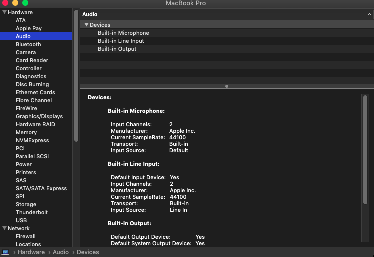

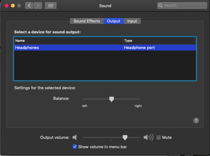

Hi Kakaro , don't bother , working on AppleALC implementation ,then update .
EDIT:

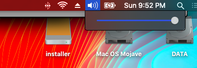

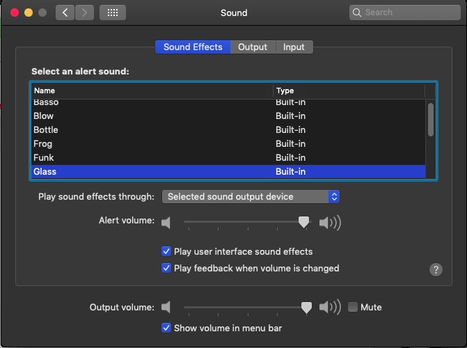

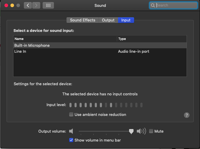

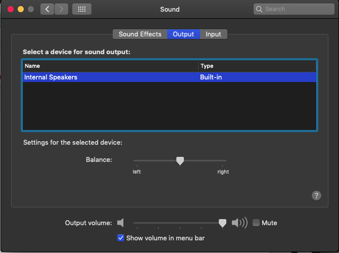

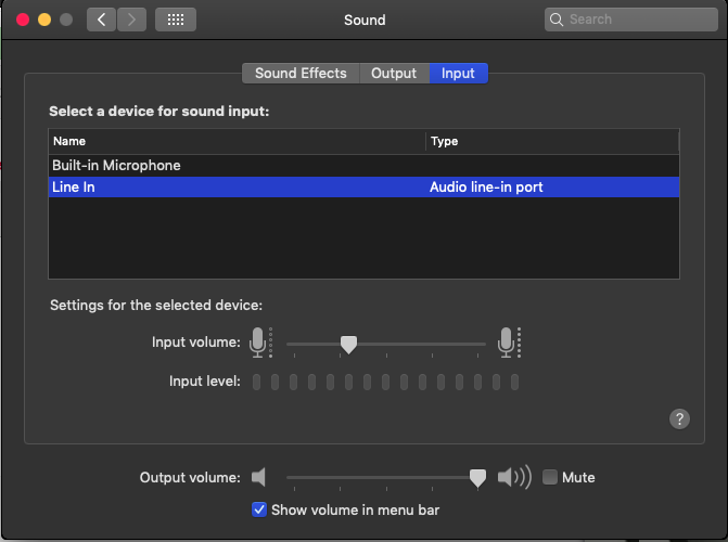

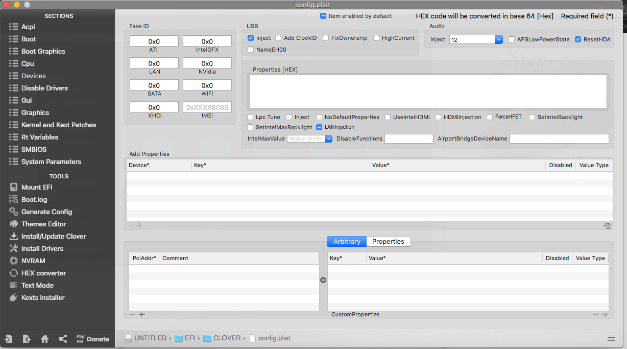

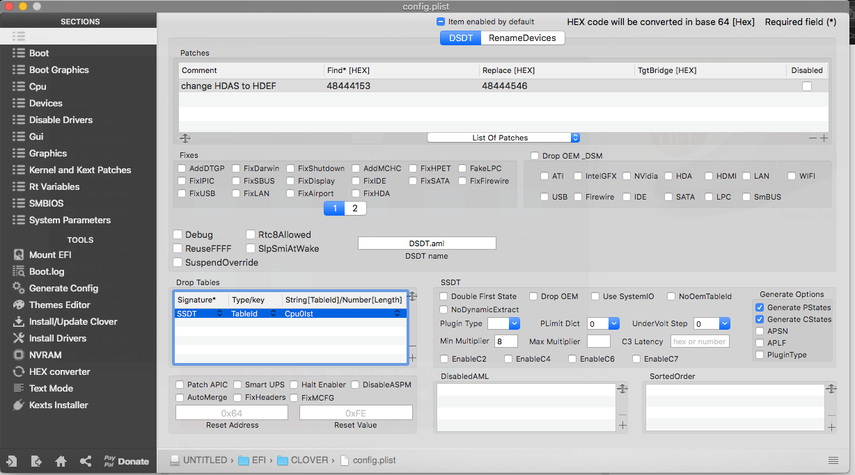

ITS working  !!!! Yeahhhhh, Vanilla AppleHDA !!
All Credits to Hervé and AppleALC Team .
This guide worked  for me its very easy :
https://hackintosher.com/guides/get-hackintosh-audio-working/
First of all , its better going clean install , for that ,deleted all kexts from other folder on my USB clover boot flash drive except for FakeSMC.kext and VoodooPS2Controller.kext.
* then put the tow kexts into other folder (AppleALC.kext and Lilu.kext).
*the original config.plist in the first post guide contains AppleHDA Patching on the fly which is no longer works this  patch must be removed .thos tow entries down this post
*patch DSDT by clover configurator like in the guide like above use inject under audio
and use 12
* clean install dosdude1s guide WITH THIS USB FLASH and after finish DONT APLY AUDIO PATCHING IN THE POST INSTALL STAGE , JUST UNCHECK IT FROM THE SUGGESTED PATCHES AND COMPLET THE INSTALLATION. Restart and
Viola !!! AppleHDA , yeah , its True .

Hi nanotech, incredible, it works perfect. Thank you very much for your contributions, you are a great person, I am grateful. Since everything works wonderfully and I use it in secondary disk in CADY, now I will install it in the SSD disk. I did not install again, just make the changes to the config, plist, copy the AppleALC and Lilu kext, extract AppleHDA with pacificit.app and replace it and ready to enjoy high quality sound

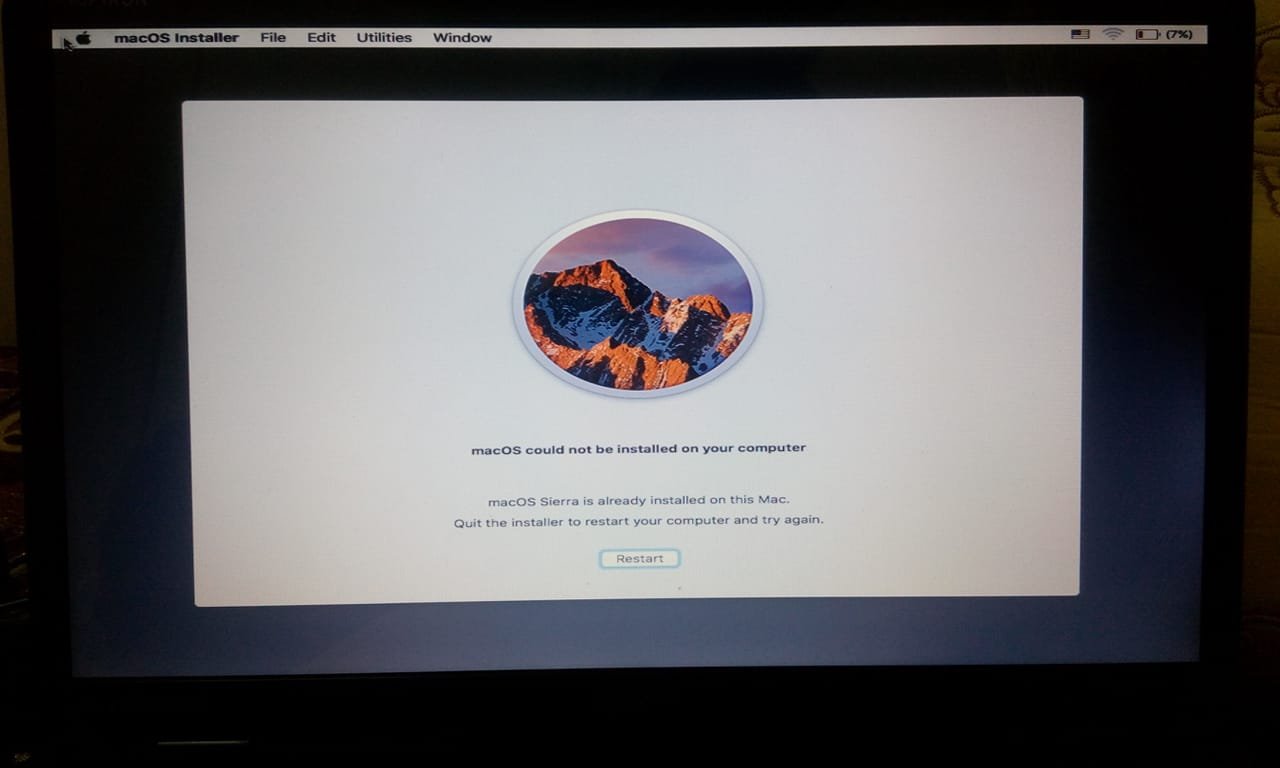

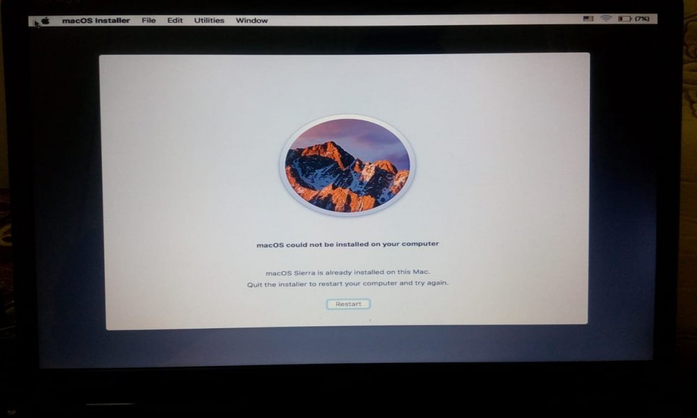

12 minutes ago, mohammed-dirdasawi said:
that ok! i used your file attached to me but after apple logo loaded appear these error!!
i hope to help.
Its not a clean installation
EDIT:
backup your files and format your partition for clean install , you are trying to install the same macOS version ! go clean install.
when installer startup go to disk uitility format your installation partition then continue the installation
Edited by nanotech

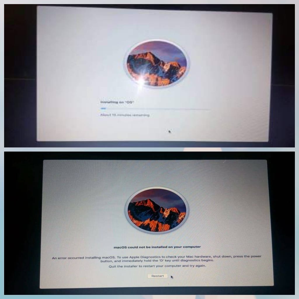

EDIT:
i did that my HHD is empty and i format it but same error
i put DSDT.aml and SSDT-4 2.aml in CLOVER\ACPI\patched. is not it?!
OHHH... your SSDT-4 REMAME IT its not SSDT-4 2.AML
ITS SSDT-4.aml
Its my fault ,  sorry .
but it seems its not related to your error , it seems you have MacOS Sierra Mount points in your boot sector of your HDD that till the installer that you allready have MacOS Sierra installed
