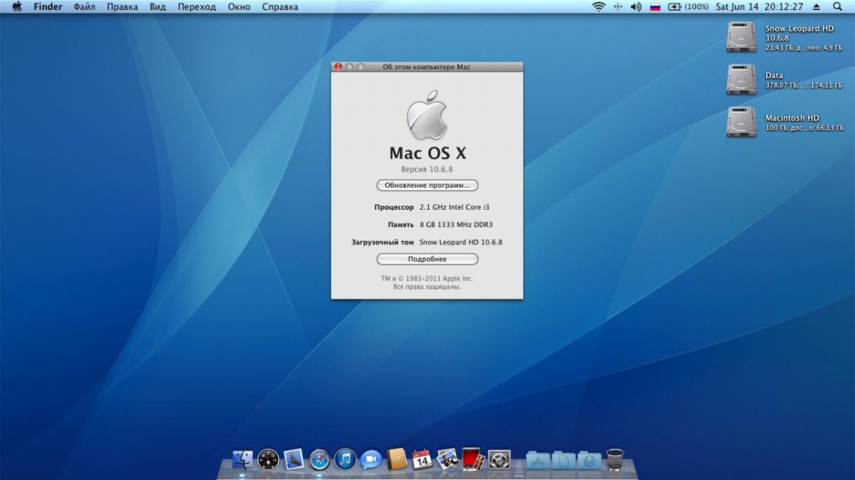

Sherlocks Posted July 23, 2017 Share Posted July 23, 2017 Snow Leopard? this is not a good idea for this laptop, HD3000 works on 10.6.8 very incorrectHd3000 works on 10.6.8. But we need to find hex patch for hdmi or vga patch like lion.I will find this hex from debug. I bought L502x today. I successed to install snow leopard. I will check. Thanks 나의 LG-F800S 의 Tapatalk에서 보냄 Link to comment Share on other sites More sharing options...
LuckyLuck Posted July 24, 2017 Share Posted July 24, 2017 http://www.everymac.com/systems/apple/macbook_pro/specs/macbook-pro-core-i5-2.3-13-early-2011-unibody-thunderbolt-specs.html MacBookPro8,1 HD3000 graphics 1st released with Snow Leopard early 2011, i.e before Lion which was released in the summer... Yes,I know about this I was install 10.6.8 a few years ago and I have a problem to boot and getting kernel panic on AppleIntelSNBGraphicsFB.kext (default 10.6.8 kext) By replacing this kext on another one from Lion's 10.7.0 beta (i don't remember a beta version number) I was able to boot into os Link to comment Share on other sites More sharing options...
