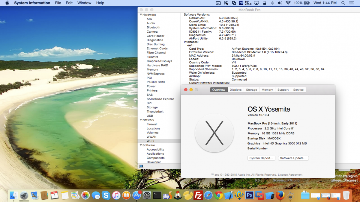

Hi guys, I need a list of WiFi half size mini pci that work on Yosemite.
i think THIS LINK can help you.
look for dell 1702, its rebranded atheros, not sure if your laptop has a whitelist, user manual might help.
this card isn't good at all, so, it's better to buy something compatible with OS X (Apple Airport, Apple Continuity, etc), it's not too expensive, $30-40
To say it isn't good at all is misleading, its the card that many of these models come with, and is supported by the guide.. for simplicity, its the ideal one to get if you are following this guide alone. Of course there are better cards, much better, but as I stated, I don't know if this model has a whitelist or not, if it doesn't, great, get a broadcom instead :)
Dell Wireless 1702 can't run Continuity, for example, and has older versions of bluetooth and wi-fi (bt 3.0+hs, 802.11b/g/n). New card supports all new features of OS X 10.10 like Continuity and has new versions (bt4, 802.11 b/g/n/ac).
So, this card (1702) works fine but without new features... and for me without 802.11n (don't know why)...
