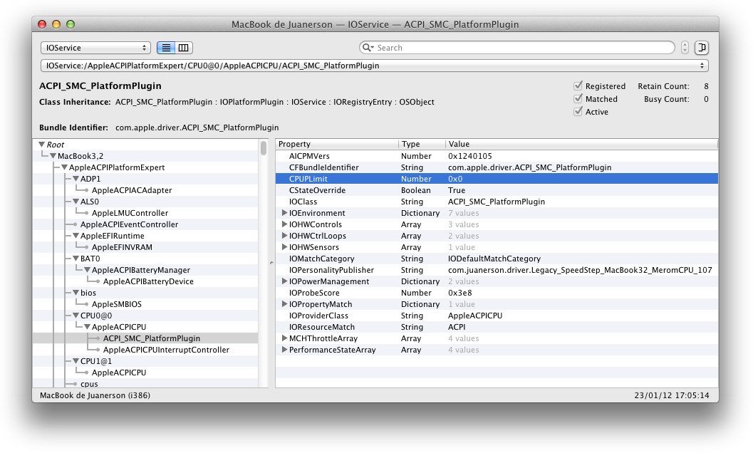

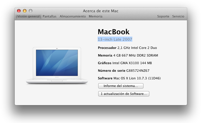

juanerson Posted January 23, 2012 Share Posted January 23, 2012 Use the files attached combined with Legacy_SpeedStep MacBook3,2 injector: MacBook3,2 Merom_CPU files.zip The Profile (smbios.plist) from /Extra, and the two kexts installed in /S/L/E (replace the previous same kexts if necessary). Tested and working here: Note: Build your own genuine-valid Mac Serial, and don't share it... please read this commentary. Good Luck. Link to comment Share on other sites More sharing options...
mnfesq Posted January 25, 2012 Share Posted January 25, 2012 I just want to report that I have not had a problem with video freeze or KP's for several days. Last week, I decided to stop testing 10.7.3 and did a fresh install of 10.7 with update to 10.7.2. I then used the smbios for MacBook 5,2 and installed the new IntelCPUMonitor.kext for FakeSMC. I also put FakeSMC and all of its monitor kexts in S/L/E instead of E/E. That's all I did to produce the better working condition. I observed a huge difference with the new IntelCPUMonitor. It made fixes for my Merom CPU and now the speedstepping works better than ever. It used to be that I had no more than 3 working P-States. Now, speedstepping works at frequency intervals of 200 MHz from 600 MHz to my maximum of 1800 MHz. I am thinking that the video freezes may be due to inaccurate CPU data which cannot be processed properly by the video kexts. 1 Link to comment Share on other sites More sharing options...

juanerson Posted January 29, 2012 Share Posted January 29, 2012 I can't to work with that DSDT. Can you upload your factory DSDT from windows (extracted with AIDA64) or Linux? I need a non-dirty DSDT, and a copy of your .ioreg. Link to comment Share on other sites More sharing options...

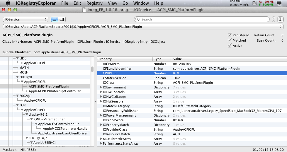

Alex_Nik Posted January 29, 2012 Share Posted January 29, 2012 I can't to work with that DSDT. Can you upload your factory DSDT from windows (extracted with AIDA64) or Linux? I need a non-dirty DSDT, and a copy of your .ioreg. This is my DSL's + sys info from ubuntu and ioreg from clean lion 10.7.2 with clean dsdt (from ubuntu). kexts in system: 3100fb 1.5.18; fakesmc 3.1.0; ps\2 (not voodoo); patched AppleRTC; IntelCPUmonitor 1.0; VoodooMonitor 1.1.1. Speedstep working in this case with Chameleon. Archive.zip Thanks) Link to comment Share on other sites More sharing options...

juanerson Posted January 31, 2012 Share Posted January 31, 2012 Alex Nik, try this dsdt.aml from /Extra 1) For NATIVE SpeedStep use the Legacy injector MacBook3,2. You don't need VoodooMonitor (or voodoopower) at all, delete it. 2) Install X3100FB.kext from 10.5.8 (1.5.36.25). No needed Natit.kext because now your DSDT has hack code for graphics. 3) Add this to your org.chameleon.Boot.plist (your machine need to be detected as NOTEBOOK = type 2 in Mac OS X): <key>SystemType</key> <string>2</string> 4) Repair permissions and blablabla... restart. Good Luck. Note: Please upload a new .ioreg to see the changes. DSDT test1.zip Link to comment Share on other sites More sharing options...
Alex_Nik Posted February 1, 2012 Share Posted February 1, 2012 Alex Nik, try this dsdt.aml from /Extra 1) For NATIVE SpeedStep use the Legacy injector MacBook3,2. You don't need VoodooMonitor (or voodoopower) at all, delete it. 2) Install X3100FB.kext from 10.5.8 (1.5.36.25). No needed Natit.kext because now your DSDT has hack code for graphics. 3) Add this to your org.chameleon.Boot.plist (your machine need to be detected as NOTEBOOK = type 2 in Mac OS X): <key>SystemType</key> <string>2</string> 4) Repair permissions and blablabla... restart. Good Luck. Note: Please upload a new .ioreg to see the changes. Hi! Report: With FB kext from 10.5.8 (1.5.36.25) - Now blue screen and system does not work in the background. With FB kext 1.5.18 (which previously always loaded with no problems) - Now is also a blue screen, but the system works in the background, it is possible to use Applescript to get ioreg The system starts with only Kext from 10.6.7 (I have no other), but continues freeze arc Alex_nik.zip Link to comment Share on other sites More sharing options...
juanerson Posted February 1, 2012 Share Posted February 1, 2012 Ok. The hack code injection for graphics is working. And the SpeedStep injector is loaded. Then: 1) I did NOT said "the freeze is solved" at all. 2) I did NOT wrote "system-type". So, use the proper o.c.B.p attached into the .zip. 3) Your SSDT tables (for processor-firmware support) are NOT recognized by Lion, therefore NO SpeeStep (P-States and C-States) at moment. The cause: Bad BIOS or incompatible ACPI code. In case, MAYBE GenerateP-States and GenerateC-States Flags (both = Yes) should solve this problem, maybe NOT. So, use the same o.c.B.p attached. 4) New dsdt.aml test 2. 5) Please upload new ioreg to see the changes. Test2 Alex_nik.zip Link to comment Share on other sites More sharing options...
Alex_Nik Posted February 1, 2012 Share Posted February 1, 2012 i installed fresh Lion 10.7.2 with 3100FB 1.5.36, and on first start system my screen work good. But i have ext monitor and i (as usual) activated him as general and then changed resolution from 1024*1280 to native 1680*1050. Then i created first ioreg. On first start system (load without kernelCache), Legacy_SpeedStep_MacBook32_107.kext (as see in ioreg) not loaded, and i restarted system. After restart i see blue screen. If resolution to return back, the blue screen remains. Then I installed FB 1.6.26 and the system has booted correctly, I created a second ioreg. Arc_Alex_nik2.zip Link to comment Share on other sites More sharing options...
juanerson Posted February 1, 2012 Share Posted February 1, 2012 I don't know what are you talking about, those things you said about cache (YOU NEED UseKernelCache=YES) and the legacy SpeedStep injector worked in your previous ioreg. So, I think definitely you are doing something wrong, or you have a NEW but corrupt operating system, or wherever you do to install .kexts, repair permissions and rebuilt cache process. Because that file should works in your case too (as for me, and many other people) because NOW you have P-States and C-States, I mean two new SSDT tables has been added by Chameleon flags. Please, see all in your own ioreg. Edited: As you can see, in the second ioreg you have FULL SpeedStep support and working by the Legacy injector: In general, the second ioreg looks much better, EDID is registered and all graphics patches working. About Graphics with X3100FB.kext from 10.5.8 (first ioreg): Maybe you have problems with your EDID (maybe random happen). I see is NOT loading at all in the INTERNAL display (first display0). Search about "display EDID override" thread by CharredPC in the forum (information in my signature too). Sorry, I can`t do more for you. Last to comment, I have Extended display always working PERFECT, and obviously NOT mirror, as we know than ever worked for us (any X3100 user), never. Good Luck. Link to comment Share on other sites More sharing options...
