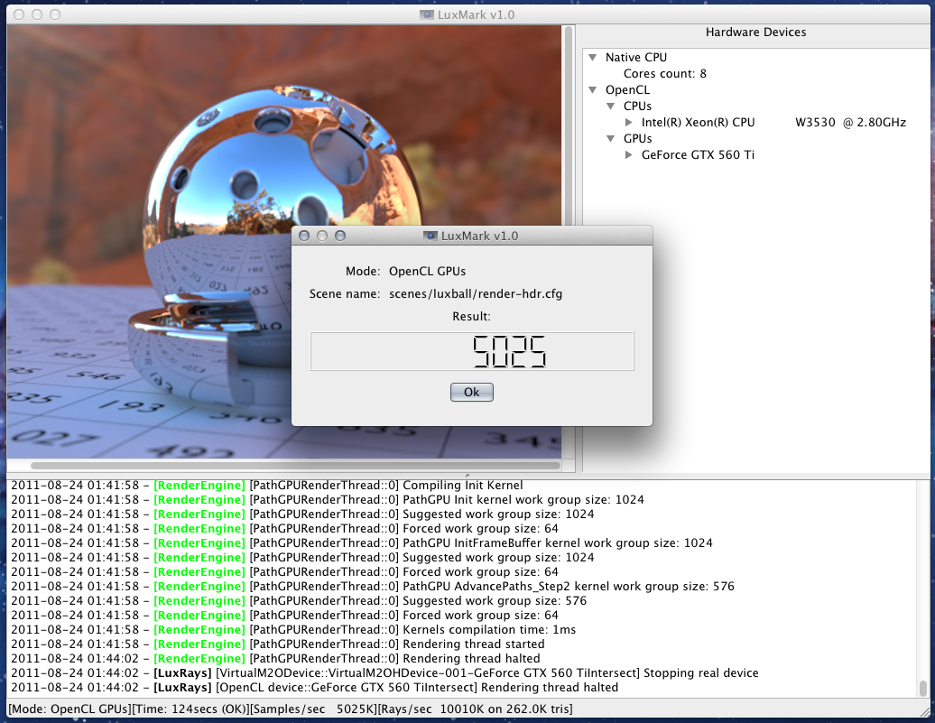

cmf Posted August 24, 2011 Share Posted August 24, 2011 (edited) Note: This still applies for 10.7.4 and 10.8! No longer needed for 10.9!good news everyone After I bought a GTX 560 Ti, I noticed a few odd things about the OpenCL support of this card.It's telling you that it's capable of all these things, but it actually isn't and will produce compile errors like "requires .target sm_12 or higher" even though it's a sm_21 capable card. So, I started digging and from the looks of it, Apples OpenCL compiler is only (directly) supporting cards up to sm_20 (Quadro 4000, GTX 480/470/580/570). If it's higher than this it will fallback to sm_10 or sm_11.The solution: let's just pretend we have a 2.0 card So, open up a hex editor of your liking and do this:open /System/Library/Extensions/GeForceGLDriver.bundle/Contents/MacOS/libclh.dylib (as root or with sudo)on 10.7.x and <=10.8.2:find: 8B 87 1C 0C 00 00 89 06 8B 87 20 0C 00 00 89 02replace by: 31 C0 FF C0 FF C0 89 06 31 C0 89 02 90 90 90 90on 10.8.3+ (as mentioned here):find: 8B 81 1C 0C 00 00 EB 06 8B 81 20 0C 00 00replace by: B8 02 00 00 00 90 EB 06 B8 00 00 00 00 90savereboot is not required, but recommendedWhat this basically does is replacing the dynamic cc device info in clhDeviceComputeCapability with a hardcoded 2.0 "info". Note that this is x64 only for the moment (which most people are certainly using since 10.7). I will add x86 support at a later point.Also, if you have another non-sm2.0 capable nvidia card installed, this will (probably) break OpenCL support for it.Now, everything that did work before should still be working ... [Device 0] Name: GeForce GTX 560 Ti Vendor: NVIDIA Type: GPU Device Version: OpenCL 1.1 Driver Version: CLH 1.0 Compute Units: 16 Work Group Size: 1024 Clock: 0 MHz Global Memory: 1024 MB Local Memory: 48 KB Cache Size: 0 Bytes Cache Line Size: 0 Bytes Available: Yes Double-Precision: No Extensions (12): cl_APPLE_ContextLoggingFunctions cl_APPLE_SetMemObjectDestructor cl_APPLE_clut cl_APPLE_fp64_basic_ops cl_APPLE_gl_sharing cl_APPLE_query_kernel_names cl_khr_byte_addressable_store cl_khr_gl_event cl_khr_global_int32_base_atomics cl_khr_global_int32_extended_atomics cl_khr_local_int32_base_atomics cl_khr_local_int32_extended_atomics ... but programs that are using some advanced OpenCL features (e.g. lexmark) should work now too: Edited September 17, 2013 by cmf 4 Link to comment Share on other sites More sharing options...
riprod Posted August 24, 2011 Share Posted August 24, 2011 The solution: let's just pretend we have a 2.0 card So, open up a hex editor of your liking and do this: open /System/Library/Extensions/GeForceGLDriver.bundle/Contents/MacOS/libclh.dylib (as root or with sudo) find: 8B 87 1C 0C 00 00 89 06 8B 87 20 0C 00 00 89 02 replace by: 31 C0 FF C0 FF C0 89 06 31 C0 89 02 90 90 90 90 save reboot is not required, but recommended I have a 460 GTX, I've done netkas opencl fix. I tried your method above and when running Luxmark I get this error in Luxmark: 2011-08-24 12:02:31 - RUNTIME ERROR: Unable to find any appropiate IntersectionDevice. Link to comment Share on other sites More sharing options...

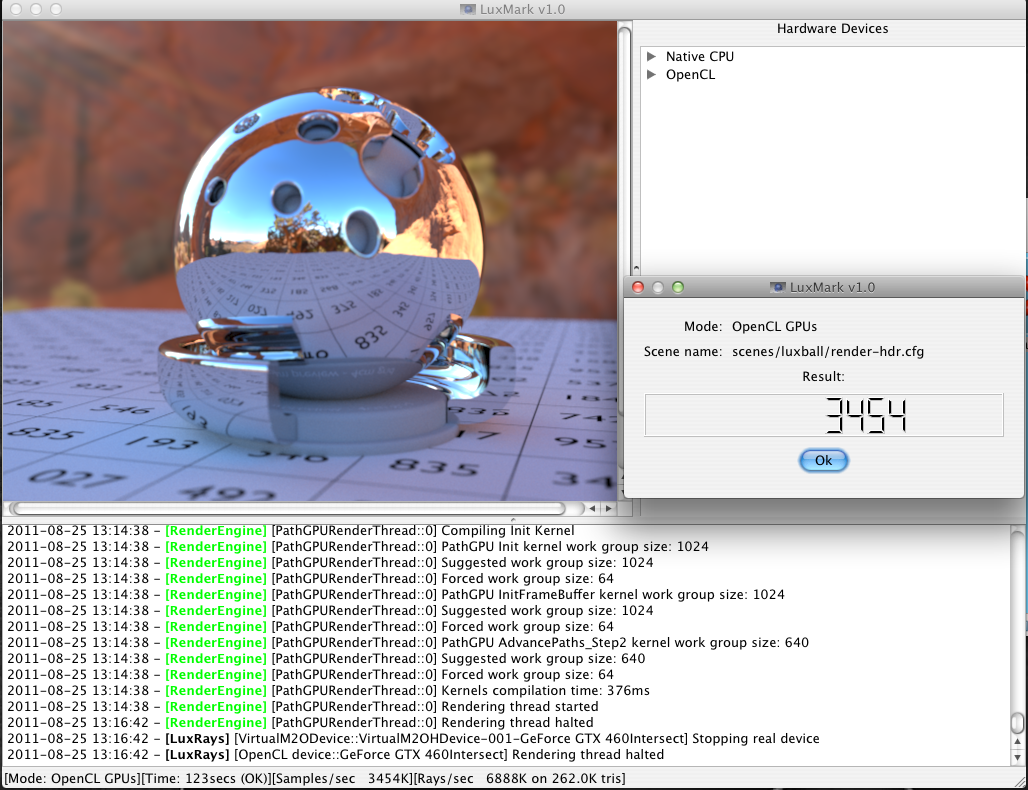

cmf Posted August 24, 2011 Author Share Posted August 24, 2011 I have a 460 GTX, I've done netkas opencl fix. I tried your method above and when running Luxmark I get this error in Luxmark: 2011-08-24 12:02:31 - RUNTIME ERROR: Unable to find any appropiate IntersectionDevice. I haven't checked this on 10.7.0 or 10.7.1 yet, but I just checked the 10.7.0 nvidia drivers on 10.7.2 and it does work too (there aren't any relevant ptx/nvidia changes in OpenCL.framework, so this shouldn't matter). It's either an GTX 460 issue or another issue altogether. I would guess the latter, since the error message you get from luxmark w/o this fix is a different one ("- OpenCL ERROR: clBuildProgram(-11)"). Could you check if you have OpenCL support at all (click)? Link to comment Share on other sites More sharing options...

riprod Posted August 25, 2011 Share Posted August 25, 2011 which os x version? have you really applied the initial opencl fix? I applied the opencl fix from netkas, but I think it was when I was on 10.7.0. Now on OS X version is 10.7.1. I will try and reapply the netkas opencl fix and see if that changes anything. I'll post back with any differences. Link to comment Share on other sites More sharing options...
riprod Posted August 25, 2011 Share Posted August 25, 2011 I took a look at my /System/Library/Extensions/GeForceGLDriver.bundle/Contents/MacOS/GeForceGLDriver. I found that the netkas edits I had done were not saved or had been over written in the update from 10.7.0 to 10.7.1. I reapplied the netkas hex edits and tried luxmark v1.0 and it worked! Thank you. Link to comment Share on other sites More sharing options...

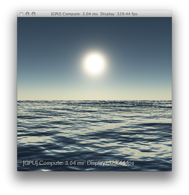

cmf Posted September 21, 2011 Author Share Posted September 21, 2011 If working, you are welcome to test your patch in real world by OceanWave OpenCL Benchmark.Until now, no Fermi GPU runs that benchmark (from Apple) with success. http://www.insanelymac.com/forum/index.php?showtopic=268209 PS: Even if OCLINFO runs well (after patching), it may happen not all OpenCL apps work too. You may get runtime or Compilererrors (OpenCL compiles on the fly). your binary is kinda broken, so i compiled it myself and it does work: 1 Link to comment Share on other sites More sharing options...
rominator Posted September 21, 2011 Share Posted September 21, 2011 your binary is kinda broken, so i compiled it myself and it does work: Could someone post the fixed version or explain how to compile this? Guess we know now why we have been getting 16 fps.... Link to comment Share on other sites More sharing options...
Florian U. Posted September 21, 2011 Share Posted September 21, 2011 Could someone post the fixed version or explain how to compile this? Guess we know now why we have been getting 16 fps.... i dont think it is broken, you just need to use terminal and cd into that directory and launch the application from there -> else it'll report files missing Link to comment Share on other sites More sharing options...

cmf Posted September 21, 2011 Author Share Posted September 21, 2011 i dont think it is broken, you just need to use terminal and cd into that directory and launch the application from there -> else it'll report files missing thats what i did and it just segfaulted. Could someone post the fixed version or explain how to compile this? Guess we know now why we have been getting 16 fps.... use 10.7 sdk, compile, add #include <OpenGL/OpenGL.h> and #include <OpenGL/gl.h> in the two files you get compile errors in, compile again, possibly run successfully. you'll still get lots of compile warnings in xcode and when compiling the opencl kernel though. i think this already tells you enough about the quality of this sample ... Can someone upload the edited file please for the OpenCL fix? sry, no, not using 10.7.1 any more. but if apple continues to push out a beta every 5 - 7 days and i get annoyed enough, i'll probably write a program ;P Link to comment Share on other sites More sharing options...
