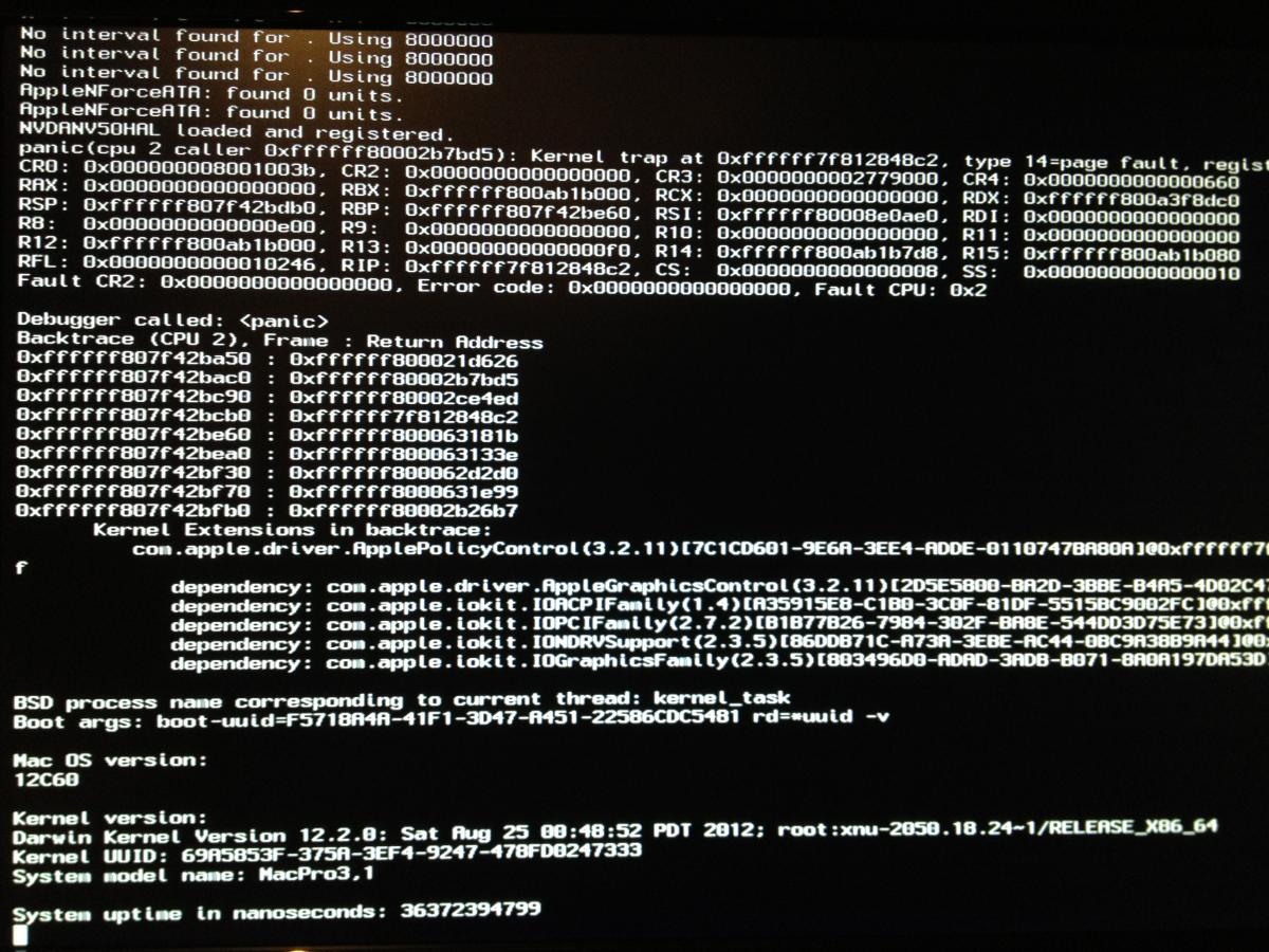

I followed your steps to create and patch a DSDT, now sitting on the desktop. But when I tired to boot straight from the hard drive, I get "Waiting for root device" and I have to restart and boot from the USB installer.

@ brandoc0mmand0
Have you installed a Chameleon v2.0 or v2.1 bootloader on your OS X system HDD.....?
Have you put imk's 64bit AppleNForceATA.kext in your HDD OS X system's /Extra directory or in /System/Library/Extensions directory......?
Your patched DSDT.aml file should go in the OS X root directory i.e. / or in the /Extra directory.......I always put my DSDT.aml file in /
@ brandoc0mmand0
First of all, after putting imk's 64bit AppleNForceATA.kext in S/L/E, you need to use Terminal to reset the kexts ownership and permissions and rebuild the kernelcache file……alternatively, you can use janek202's Kext Wizard for a Terminal-free life.......
In Terminal type:
sudo chown -R root:wheel /System/Library/Extensions
sudo chmod -R 755 /System/Library/Extensions
sudo touch /System/Library/Extensions
exit
Have you done this?
If yes, then first save a copy of ApplePolicyControl.kext before deleting it from /System/Library/Extensions/AppleGraphicsControl.kext/Contents/PlugIns
BTW does your DSDT.aml file compile without any errors and/or warnings?
Finally, if you are now running only OS X 10.8.2, then please switch to posting in my OS X Mountain Lion topic.
