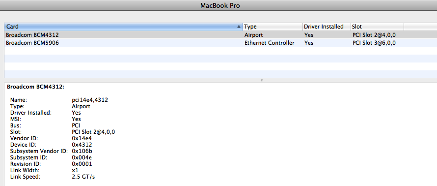

Hi, I have the issue you mentioned, my WIFI is BCM4312 and LAN is BCM5906, both of them are hangs after upgrade to 10.6.8, the system preference shows the LAN is connected but it doesn't. Anyway, login hangs about 5 seconds or more, this is boring even though it boot faster than before.
I also had problem with BCM4311, solved setting SMboardproduct in smbios.plist
http://blog.nawcom.com/?p=763
Your ethernet should work with this
http://www.insanelymac.com/forum/index.php?showtopic=247470

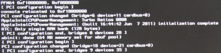

PFM64 0xf10000000, 0xf0000000
 [ PCI configuration begin ]
 console relocated to 0xf10000000
 PCI configuration changed (bridge=8 device=3 cardbus=0)
 [ PCI configuration end, bridges 13 devices 16 ]
My PC just hangs* on "PCI configuration begin" with the 10.6.8 IOPCIFamily and AppleACPIPlatform kexts.
It looks like something that's fixable via DSDT, maybe PCI devices/PCI bridge needs to be declared in a more Apple-like way now.
*techincally it doesn't, what happens is all display activity stops, but it actually continues to boot. Hmm actually that sounds more like a video card specific problem.. I do have a GTX 460 which is apparently still not supported in the 10.6.8 nvidia drivers.

Thanks for the suggestion, I follow your method and get a good result, there is no hangs login, wireless problem. No need to replace some kexts from 10.6.7 and the new chameleon works great.
Thanks again.
