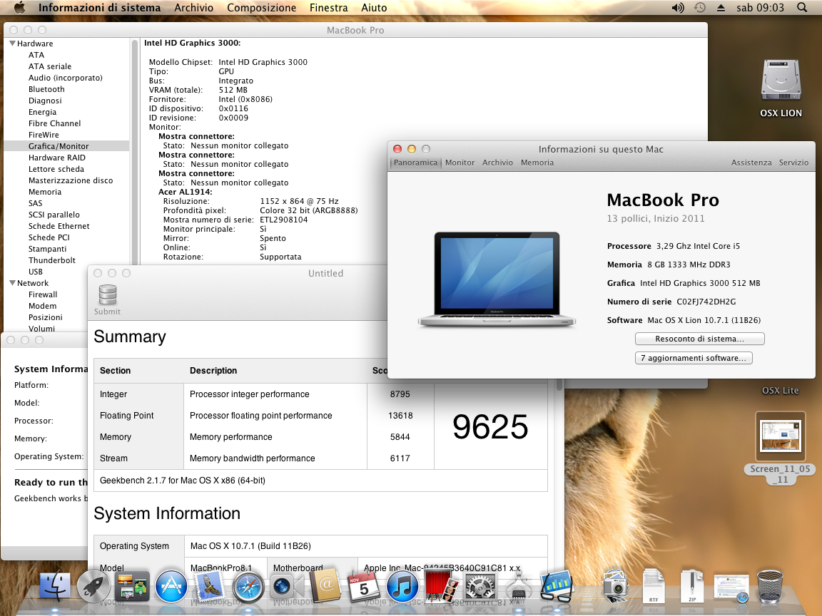

PippoX0 Posted November 4, 2011 Share Posted November 4, 2011 Eureka ! I got my VGA port working on my Hackintosh GA-H67N-USb3-B3 mobo with intel i5-2500K and Intel Hd 3000 video ID:0112 ... on OSX Lion 10.7.1 , Chimera 1.5.4 / MacBookPro8.1 smbios.plist /DSDT.aml and everything works with QE/CI enabled !! i finally can use iMovie and iWorks ... I followed as described on first post the hex editing in the AppleIntelSNBGraphics binary thanks to Bcc9 and Timp. ( i use 602 values suggested by timp) AppleIntelSNBGraphics FrameBuffer to be binary patched 0102 0400 1007 0000 1007 0000 0503 0000 0200 0000 3000 0000 0205 0000 0004 0000 0700 0000 0304 0000 0004 0000 0900 0000 0406 0000 0004 0000 0900 0000 Patch 0503->0602 From internal LCD port to VGA port ... I patched also my DSDT to get ID:116 instead of ID:112 (real one) Mod. IGD0 Device (IGD0) { Name (_ADR, 0x00020000) Method (_DSM, 4, NotSerialized) { Store (Package (0x04) { "hda-gfx", Buffer (0x09) {"onboard-2"}, "device-id", Buffer (0x04) {0x16, 0x01, 0x00, 0x00} }, Local0) DTGP (Arg0, Arg1, Arg2, Arg3, RefOf (Local0)) Return (Local0) } OperationRegion (IGDP, PCI_Config, 0x40, 0xC0) what to fix: my Monitor Acer AL1914 has 1280x1024 res, but i got 1152x864. If i try to change resolution i lost qe/ci and get black screen ( I need to boot with " -x -v" option and delete /Library/Preferences/com.apple.windowserver.plist to get back 1152x864 resolution and fix black screen) Best Regards !! Link to comment Share on other sites More sharing options...
