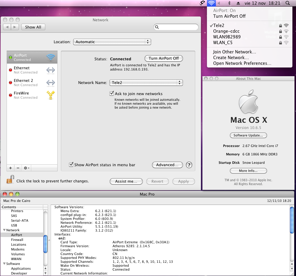

cairo_sc Posted September 10, 2010 Share Posted September 10, 2010 TPlink PCI-e 1x model TP-WN781N chipset Atheros AR9285 Full Support SL 10.6.3+ 32 and 64 (10.6.5 kext needed, how-to in my signature) Link to comment Share on other sites More sharing options...

Jordan2Delta Posted November 11, 2010 Share Posted November 11, 2010 TPlink PCI-e model TP-WN781N chipset Atheros AR9285 has stopped working after installing Mac OS X 10.6.5. It says no AirPort card installed. Which is funny because it worked with the beta (10.6.5) of IO80211Family.kext Any thoughts on this? Link to comment Share on other sites More sharing options...
cairo_sc Posted November 12, 2010 Share Posted November 12, 2010 TPlink PCI-e model TP-WN781N chipset Atheros AR9285 has stopped working after installing Mac OS X 10.6.5. It says no AirPort card installed. Which is funny because it worked with the beta (10.6.5) of IO80211Family.kext Any thoughts on this? 1st. After installing 10.6.5 update i lost my AirPort too. 2nd. Installed the old IO80211Family.Kext 10.6.5 (Beta Version). 3rd. Got my AirPort working again =D Link to comment Share on other sites More sharing options...
Jordan2Delta Posted November 12, 2010 Share Posted November 12, 2010 1st. After installing 10.6.5 update i lost my AirPort too. 2nd. Installed the old IO80211Family.Kext 10.6.5 (Beta Version). 3rd. Got my AirPort working again =D Thanks for your help! After rolling back to IO80211Family.Kext 10.6.5 (Beta Version) it worked again! There seems to be two more solutions available here: http://www.insanelymac.com/forum/index.php...p;#entry1582007 I have edited the new IO80211Family.Kext's Info.plist and it is working. But I haven't deleted the Kernel kext cache file yet. I hope it will still work once I... There's another thing I came across during using the beta kext. Sometimes the Airport status icon in the menu bar is greyed out and it says something like "no card installed"?! Then when I open Network Preferences I click a few times on the checkbox "Show AirPort status in menu bar" and the status icon appears again. Well, sometimes that doesn't work either. Has anybody experienced similar issues? Link to comment Share on other sites More sharing options...
