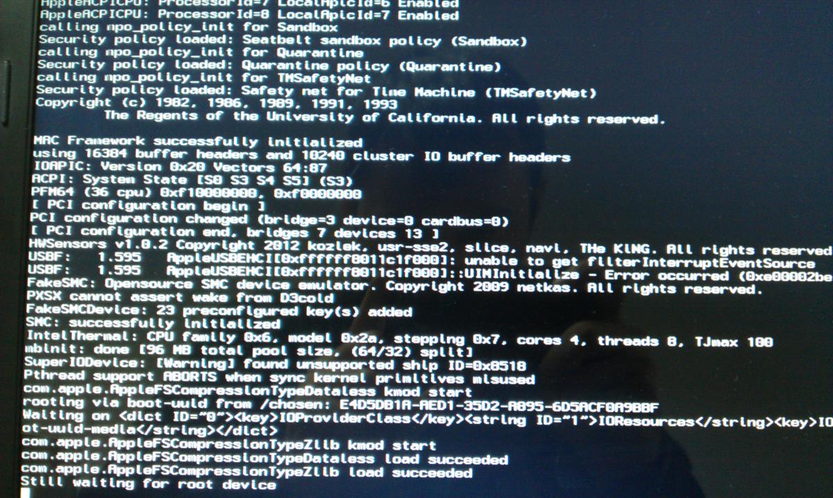

I have been trying for a few days to install ML but i get stuck at the "Still waiting for root device". I made the usb using pcwiz13's tutorial. I have tried all the suggestions in this topic but with no luck. These are all the boot args i tried: -v GraphicsEnabler=No busratio=20 PCIRootUID=1 UseKernelCache=No npci=0x2000.
Also tried creating usb stick with other methods but the same result. Also tried all usb ports. Any other suggestions? :D
@cisar throw in doix's dsdt at root or extra folder ....another unusual thing i noticed is that if i booted with the dsdt and no verbose it actually reaches the installer page and actually installs.....i dont know why this is so but it gives opportunity to see what happens on your end...you may also need to put pxhcd kext (for the usb3 ports) in extra folder with the other kexts.....alternatively you make your internal hard disk(you'll have to pull it out and also have a pre existing mac install you may also try pcwiz's install via windows method but i've never used it myself so i cant comment) into an installer then install back on to it to avoid what i believe to be a usb3 issue.
@timewalker can you tell me exatcly what settings you used to install clover.....coz now i get the apple screen but after a minute a stop sign. i stick with clover 2 v826 , coz 855 just does nothing for me and leads me back to system operations not found error.......talk to me like i'm 7 yrs old coz this boot thing is giving me nightmares everything else i got working but i cant really know how successful i am without a self booting HD. i know i'm being that guy but please help.
if the stop sign appears then you are experiencing the "waiting for root device" error under covers
start clover without kernelcache .. (in GUI press space on your desired volume and select the last option)... it should boot up properly.
then use bcc9's BlockStorage patcher-script to patch your kext (it will introduce a delay wrapper to allow it to load properly when booting with caches).

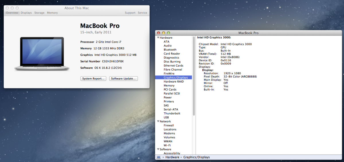

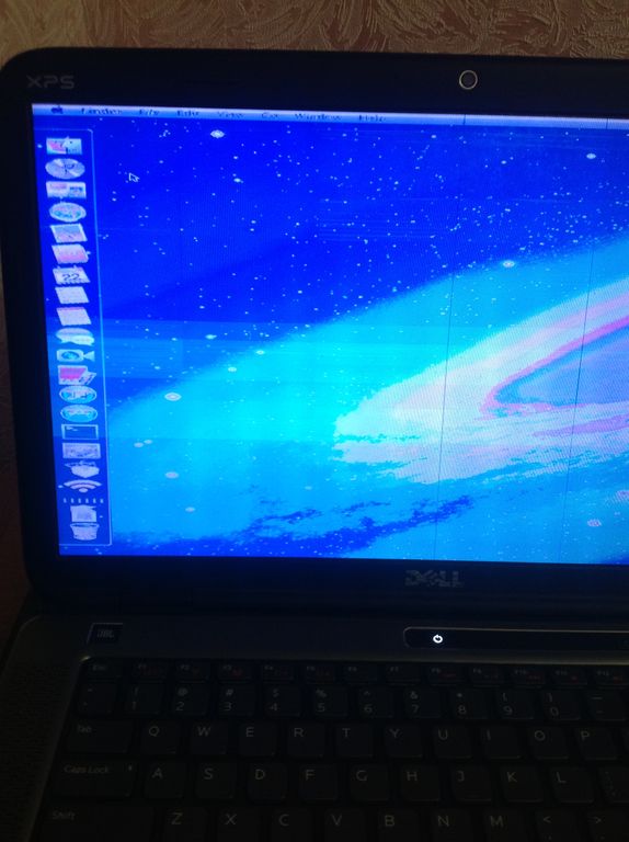

Could you please help me with my issue, which I cannot resolve for a pretty long time?
Still can't get my hd 3000 running properly.
What do i have:
Dell XPS 15 L502x / Intel Core™ i7-2630QM HD3000 IGP Optimus 2GB NVIDIA GeForce GT 540M / 12 GB DDR3 SDRAM 1.333 MHz [ 4 + 8] /Intel HM67 USB2 + USB3 //(15.6") FHD B+RGLED 1080p / Realtek ALC665
Modified/unlocked BIOS А12 > UEFI boot, all advanced options available, Intel vbios update 2137.
Mountain Lion 10.8.2 on Clover EFI (latest).
Vendor: Intel (0x8086)
Device ID: 0x0116
Revision ID: 0x0009
Pretend to be MacBook Pro 8.1
Already tried:
Removed all the kexts with ati*, nvd*, geforce*, AppleIntel*<everything_related_to_graphic>.
Result: booting in Full-HD, no QE/CI, "no kexts loaded".
Installed:
AppleIntelHD3000Graphics, AppleIntelHDGraphics, AppleIntelHDGraphicsFB, AppleIntelSNBGraphicsFB (from several disk/app images, they're totally fine).
Result: booting in 1640x????, display is corrupted, 16-bit color. see attachment mon.jpg.

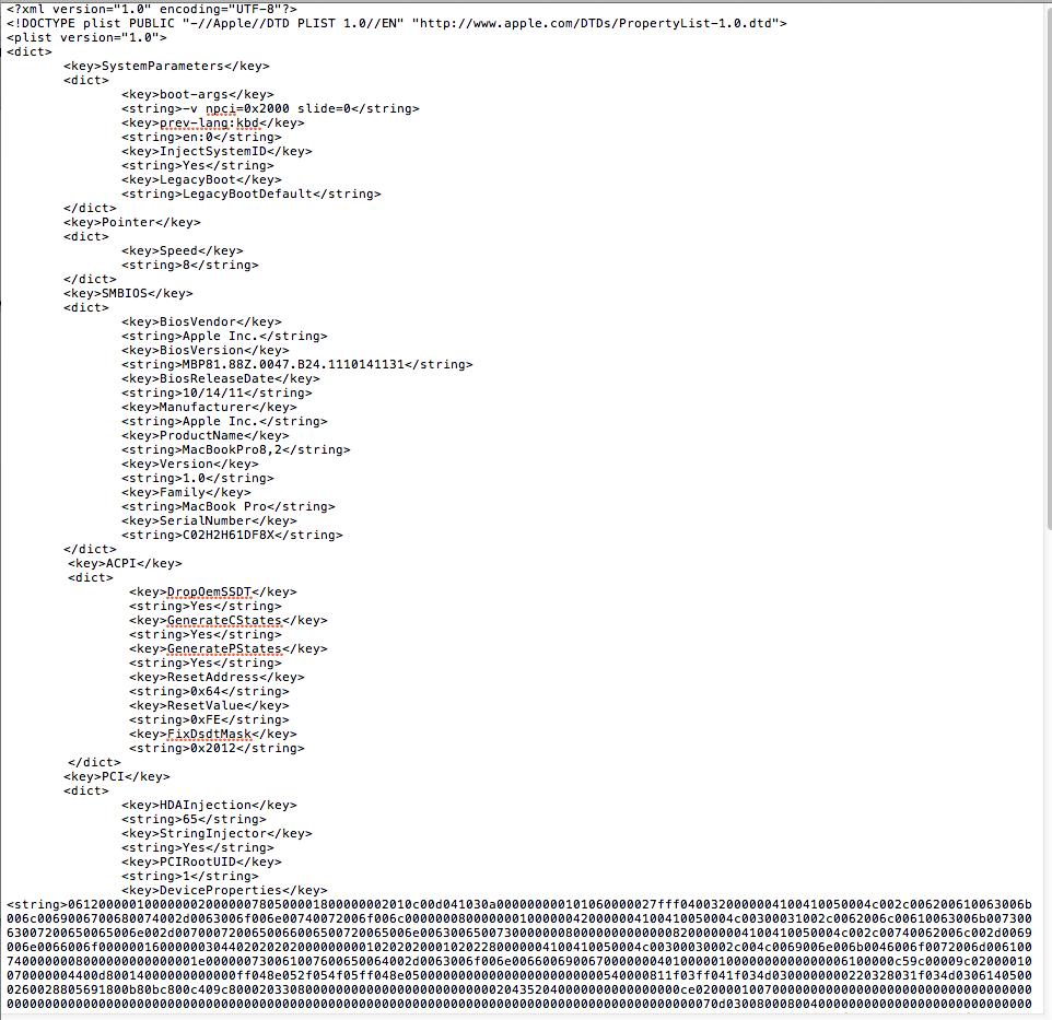

Main boot settings:
<key>SystemParameters</key>
<dict>
<key>boot-args</key>
<string>-v npci=0x2000 slide=0 WithKexts</string>
<key>prev-lang:kbd</key>
<string>en:0</string>
<key>InjectSystemID</key>
<string>Yes</string>
<key>LegacyBoot</key>
<string>LegacyBootDefault</string>
<key>BacklightLevel</key>
<string>0x0101</string>
</dict>

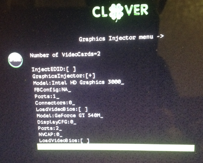

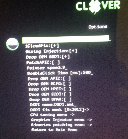

By default, Clover has GraphicsInjection true, tried both the options, didn't help.
Also tried other options like loadvbios, injectEDID and so on from menu, with the same result.
In device manager Nvidia is always being detected.
I'm out of ideas already(
Regular Lion (10.7.4) is used to work w/o a glitch, but those days that was chameleon with patched DSDL (not by me, this topic http://www.insanelym...7-l702x-optimus causes KP now). So it's not a hardware issue.
Currently, I'm using Clover which patches DSDL on fly.

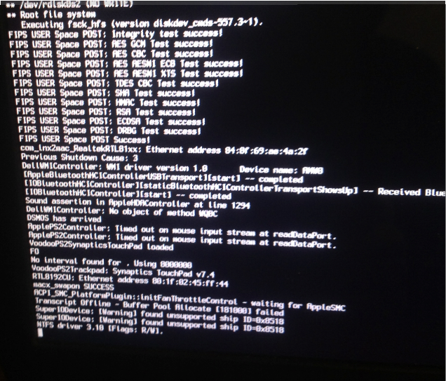

@jkbuha how did you solve sound for alc269 ..voodoo hda causes kp ....how did you solve screen glitches ..are there files i can get from you for this...i'm lazy
Point is .. just use my provided drivers. Mine works perfectly fine ...
Don't remove the aptopfixdrv because you need it..
You can extract the drivers just from the installer (extract files option) ...
For ALC269 I have a patched kext put together .. using clover the modifications you have to do after OS update are minimal.. also so far I hadn't touched it since installing 10.8 from MAS.. it just works.
Your problem is that you are lazy and admitting it .. which is good in way lol.
for the clover issue i'll just figure thing out on my end but it is your aptio file that causes the error on my side ......i did get the point the first time you said it but i have to go with the result on the ground
clover seems increasingly inconsistent to the point that it even interferes with my usb boot via f12 and even gives an error ....thats crazy....i dont know whether clover is to blame or whether its a combination of clover and dell
as for sound can u provide me with the kext

Could you please help me with my problem?
Everything's working except for not running QE/CI on my hd3000.
Dell L502x 540M i7 2630 / 0116 , 12gb RAM.
BIOS A06 modified (EFI boot)
Clean installation 10.8.2
Clover EFI,
your DSDT and SSDT from 1.4 package uploaded to EFI/ACPI/Patched.
Settings from *boot file for Chameleon were adapted for config file of Clover.
Kexts from the same package are installed to S/L/E.
I tried a lot of options, like deleting all the geforce* and NVDA*, graphicInjector+ or boot with this option disabled, modified HD3000 kexts (you attached them in this topic somewhere) and or original ones.
The best result was to leave only AppleIntelSNBGraphicsFB and AppleIntelHD3000Graphics kexts just like you suggested to someone numerous pages ago - everything becomes pretty soft and smooth (until i try to run launchpad of dashboard.
Currently, system detects my video card correctly, but still no acceleration.
To resolve it all I need is a little push, which I can't make for days.
In attachments my clover settings, clover options, boot log.
I hope you will find a minute or two to take a glance at it.
Thank you in advance.

That's not optimus related, it's because you have a Full HD Screen. Boot without the string and see if you can enter Dashboard/LaunchPad smoothly, also see if the menu bar option is available then. It's possible the string i made is not compatible with your system.
w/o string i can't even boot normally into my system.
My screen was split a half, awful colors, and other cool stuff when optimus shows its true nature."
It is possible to boot w/o string and get normal colors and uncut full-hd screen only when all the video drivers are removed.
Otherwise my screen is corrupted, and yes, dashboard is still glitchy in both cases.
