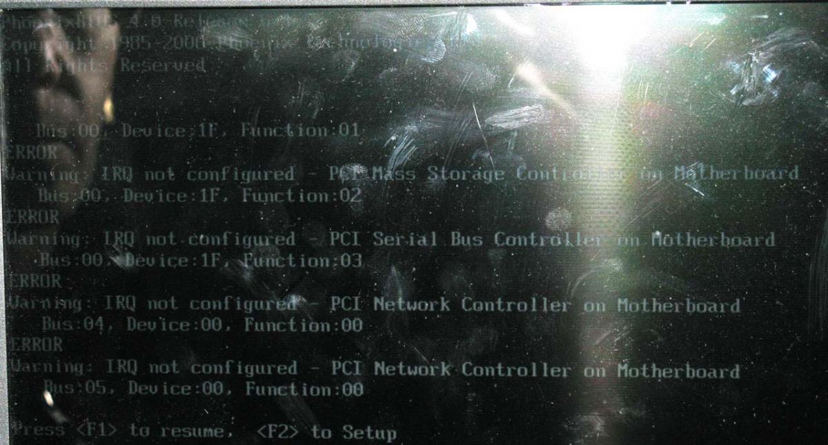

marcussebe Posted December 31, 2011 Share Posted December 31, 2011 I install Lion on USB HDD, it work, but, When i shut down lion the notebook won´t start. The error is in the image. I must press sometimes 10 times the startbutton, sometimes 50 times, until the pc will start. My notebook is Acert TM 6292. Can you help me? Link to comment Share on other sites More sharing options...
