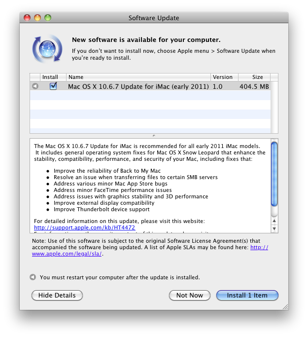

Time2Retire Posted May 4, 2011 Author Share Posted May 4, 2011 Let the speculation begin! QA didn't approve the 10.6.7 iMac12 in time, so they delayed shipment und will bring us the update on friday Nah. Just a BTO delay. Btw, Tony found some nice Geekbench results for the new iMac's with processor info: http://www.tonymacx86.com/viewtopic.php?f=...965&start=0 Interesting. Thanks for sharing. Hmm. I wonder why my FSB is 400 MHz and theirs 'only' 100 MHz. Same Geekbench version. So should it be 100 MHz or be quad pumped (4 x 100MHz) like I (we?) have? Changing your MoBo only because it doesn't have Bluetooth? I don't want some USB dongle that blocks sleep. To slow down the boot process. Not to mention that I ordered a different board, but that one was out of stock and I ended up with the one I have now. Which is officially no longer mine now Link to comment https://www.insanelymac.com/forum/topic/253642-dsdt-for-asus-p8p67-m-pro/page/6/#findComment-1679045 Share on other sites More sharing options...

Time2Retire Posted May 5, 2011 Author Share Posted May 5, 2011 Darwin Kernel Version 10.7.4: Mon Apr 18 21:26:16 PDT 2011; root:xnu-1504.14.12~3/RELEASE_I386 Same here. This was to be expected. I also had to restore my AppleHDA.kext to get sound back, but for the rest everything is pretty much the same. Too bad that the iMac upgrade doesn't include some of the files we need to finish it up. Anyway. I've added a new directive to RevoBoot (pushed to the github repository) and now it shows: "Clock modulation: Fine grained (6.25% increments)" Which tells me that we should have 15 T-States. Not just 8. At least now we now how to add them Link to comment https://www.insanelymac.com/forum/topic/253642-dsdt-for-asus-p8p67-m-pro/page/6/#findComment-1679335 Share on other sites More sharing options...

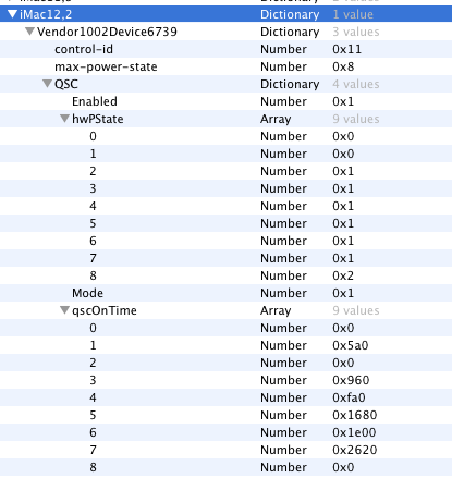

Time2Retire Posted May 5, 2011 Author Share Posted May 5, 2011 I have IOAHCIFamily v2.0.6 and IOAHCIBlockStorage v1.6.3 loaded here. No problem. Note: I don't have a DVD drive installed. The hang is probably related to the new IOClass named AppleIntelPchSeriesAHCI Also. The following screenshot shows my iMac12,2 (plist): Please note the I have a AMD 6850 and thus use a different device-id hence the 6739 here. Interesting. I had six items under: AppleACPIPlatformExpert -> Platform Memory Ranges but after the upgrade only two! AppleIntelSNBGraphicsFB v1.6.34 is loaded (like before the upgrade) even when I don't use the IGPU. It's the AppleIntelMEIDriver under pci8086,1c3a@16 in IORegistryExplorer. Link to comment https://www.insanelymac.com/forum/topic/253642-dsdt-for-asus-p8p67-m-pro/page/6/#findComment-1679418 Share on other sites More sharing options...
