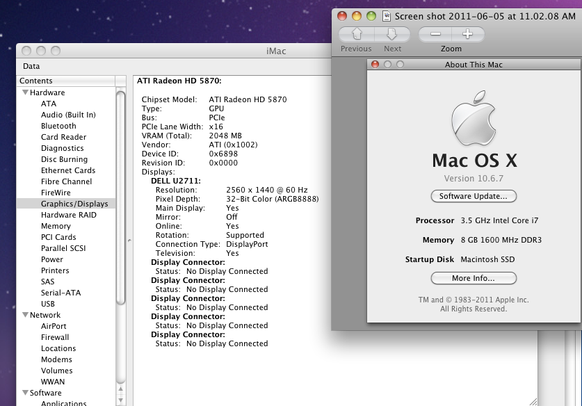

Thanks Andy! I have been building x86s for about 3 years now and this was one of the easiest. I am using:
P8P67 Pro R3.1
Sapphire 5870 Eyefinity 6 2GB
8GB Corsair XMS3
I am using a 10.6.0 install DVD and your boot loader installed first try, no problem, very easy, well done. Booting into 10.6 was no trouble at all. I did hit a hiccup after the 10.6.7 combo though. In verbose, the OS would hang @
"acpi_smc_platformplugin timed out appleintelcpupowermanagement"
I either solved this by changing "Graphics Enable" to yes in the plist or installing NullCPUPowerManagement and FakeSMC with [url=&quot;http://www.insanelymac.com/forum/topic/279450-why-insanelymac-does-not-support-tonymacx86/&quot;]#####[/url], not sure which, did them both at the same time and haven't messed with it since. As of now everything is running very well. The only annoyance is that after the OS loads I have to turn my monitor off and back on or unplug/replug the video cable to get an image and the audio pop. Not terrible, but if you have any suggestion I am all ears. Now that I am up and running and have a clone of this install I am going to start working on getting it to sleep and do some tweeking.
Well done, happy to have such a monster of a hackintosh. Thanks!
