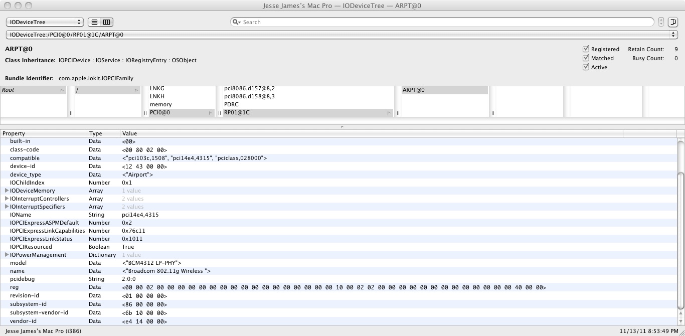

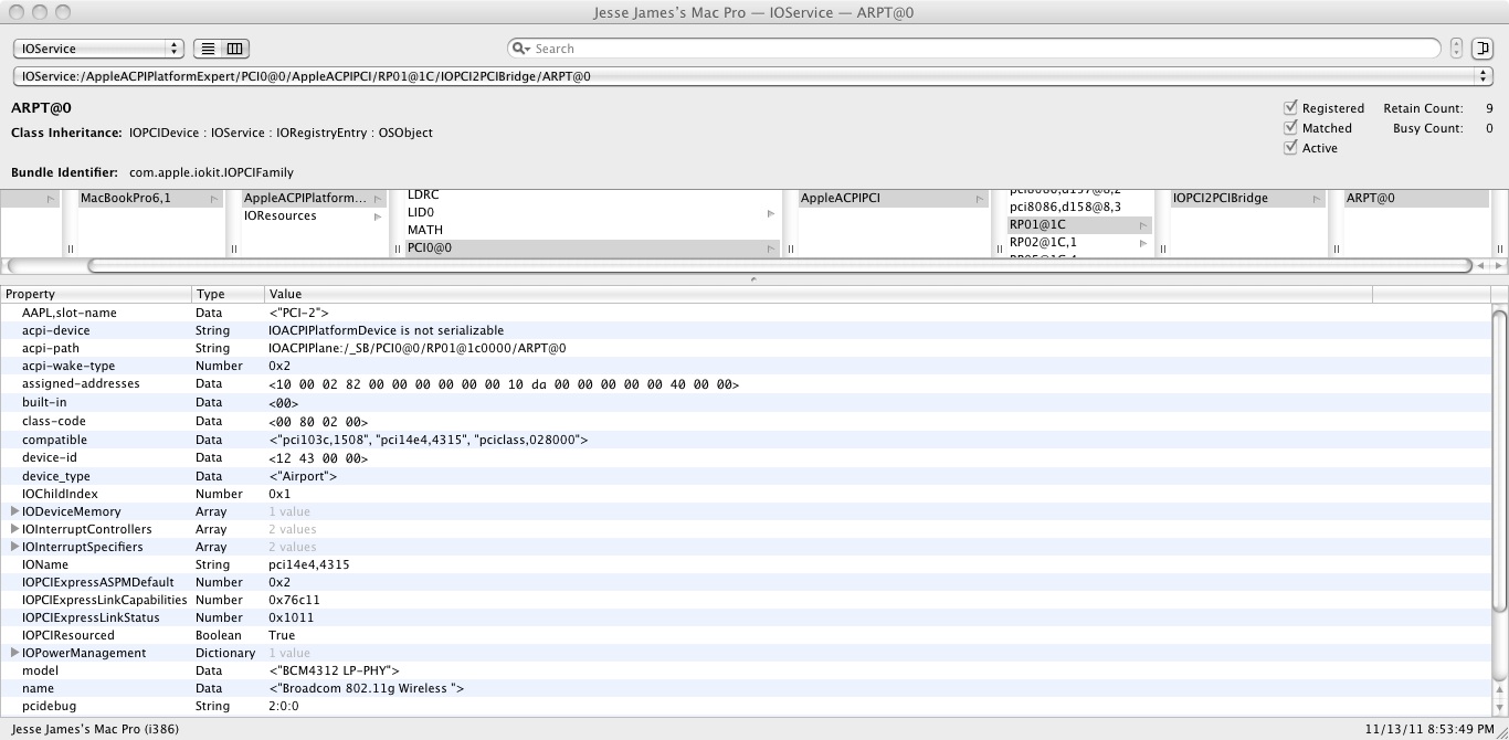

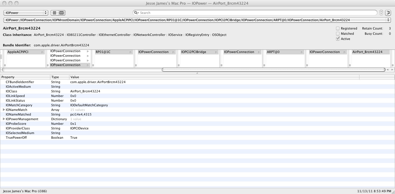

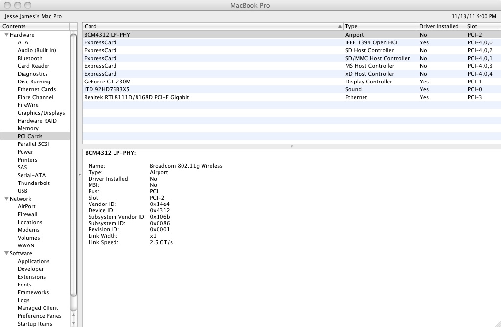

HaTToR Posted November 10, 2011 Share Posted November 10, 2011 Hi,, Still trying to get Wifi On... pci14e4,4315 (BCM4312) Broadcom.. there is a chance to make it work on 10.6.8?? Link to comment Share on other sites More sharing options...

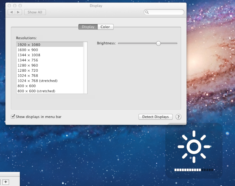

yehia2amer Posted November 11, 2011 Share Posted November 11, 2011 Thanks, I will try it, what did you do with it ? removed something ?and add patches ? Did you see any strange inside ;-) Hi Taptun, After reboot it looks OK, the only thing that is not working anymore is brightness control, I have it on function key F7 & f8, slider works but nothing changes regarding brightness on my screen ;-) Please look at the attached file if you see anything strange, ore kext that could be removed ;-) EDIT Attached a geekbench result, is this good for my system ? //Peter i install this kext in S/L/E (with Kext Utility or similar !) , don't install in /E/E ACPIBacklight.kext delete any similar Kexts Link to comment Share on other sites More sharing options...
Peter_sm Posted November 11, 2011 Share Posted November 11, 2011 I have it in S/L/E., try to reboot again I have it in S/L/E., try to reboot again No function in system preference pan, but I have some code in my DSDT that Taptun fixed for me earlier today, perhaps there is something bad pld code in my DSDT ? EDIT In S/L/E I have following kext ACPIBacklight.kext AppleBacklight.kext AppleBacklightExpert.kext Perhaps some one should be removed ? //Peter Link to comment Share on other sites More sharing options...

yehia2amer Posted November 11, 2011 Share Posted November 11, 2011 I have it in S/L/E., try to reboot again No function in system preference pan, but I have some code in my DSDT that Taptun fixed for me earlier today, perhaps there is something bad pld code in my DSDT ? EDIT In S/L/E I have following kext ACPIBacklight.kext AppleBacklight.kext AppleBacklightExpert.kext Perhaps some one should be removed ? //Peter No it should work, Repair your permissions & restart if you found the same problem then use my Guide to make a patched DSDT via Auto-Patcher by NIXin thanks yehia amer for the guide/files you provided!a question... i have snow 10.6.8 in another partition, can i safely install such kexts for snow too? or are they specific lion-only? thanks! mal yes it should work well, anyway backup your Kexts and try Link to comment Share on other sites More sharing options...

Peter_sm Posted November 11, 2011 Share Posted November 11, 2011 No it should work, Repair your permissions & restartif you found the same problem then use my Guide to make a patched DSDT via Auto-Patcher by NIXin Making new DSDT from autopatcher (DV8-i7-nixin_2011_09_29) No brightnes ( and no slider in preference pane) Battery is not working and NO Sound ! (with your AppleHDA.kext) And I attach some files for you to look at, but this is strange, but probably is my faults ;-) //Peter EDIT Using the DSDT that taptun fixed for me earlier and using my old AppleHDA.kext I have sound, battery and slider for brightens, but no changing in brightness on my screen. Looks very strange ;-) BR //Peter send_me.zip Link to comment Share on other sites More sharing options...

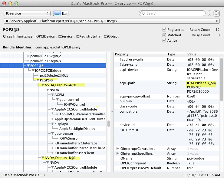

tomdek Posted November 12, 2011 Share Posted November 12, 2011 Hi, When you upgraded to 10.7.2....What did you upgrade from? Are you using GraphicsEnabler or DSDT for your video card? Was it working before the upgrade? Lion changed locations it looks for DSDT Graphics injection. By your .plist you have nVidia graphics. Do you have "IORegistryExplorer"? If not I'll attach a copy. Now, Remove "UseNvidiaRom" from your .plist. Set <key>PciRoot</key> to "0" as nic.mroc suggested. Set <key>SystemType</key> to "2" (2=laptops, 1=Desktops). If you are using a newer version oF Chameleon (highly suggested)... rename "com.apple.Boot.plist" in /Extra to "org.chameleon.Boot.plist" Reboot. With luck your graphics will come back. Fire up IORegistryExplorer. Look for your video card. This is the new location your video card needs to be injected in DSDT. It may be different than the screen shot... but the address that "You" find is where "Your" injection needs to be. If GraphicsEnabler works... you can just stop there too Hope that helps..... IORegistryExplorer.zip Sorry took a while but now it is weekend some time to try and fix it..... Thanks for the suggestion but unfort. they did not do the trick...... I did not try the dsdt as I have no clue how to do that..... i used the dsdt as provided by Mammoth but did not change a thing. How would one start with mod den the dsdt in there.....with auto patcher? Or what should I do with the info from ioregexplorer. Btw my says VGA (containing crt hdmi and lcd) instead of yours NVDA....... Link to comment Share on other sites More sharing options...

HaTToR Posted November 13, 2011 Share Posted November 13, 2011 no news about BCM4312? iam uploading Screen Shots of IOREG and System Profiler and DSDT.AML ,,, and non-touched DSDT.DSL from Ubuntu 10.10,,,, Need help here :( dsdt.zip untouched_dsdt.dsl.zip Link to comment Share on other sites More sharing options...
