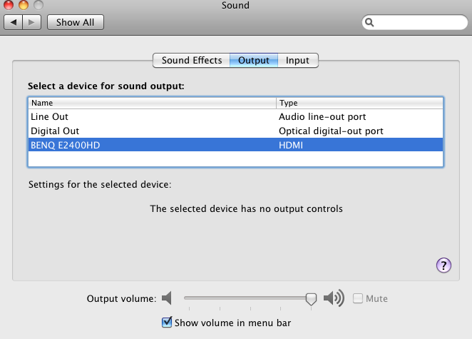

Update: The dsdt fix works on 10.6.7 and Now i got a working HDMI Sound :rolleyes::):D
for making HDMI sound works you must
1) inject graphics card from DSDT
2) GraphicsEnabler= No
3) add this fix: re-enable HDMI audio on SL 10.6.6
4) clear all caches and pfix
this is my DSDT:Amer_dsdt.zip
Good luck

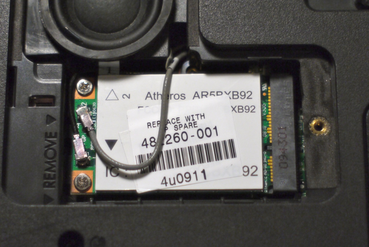

1) Happy to report that the Atheros AR5BXB92 works with my DV8. Fits in perfectly (nothing on the bottom of the card), OSX recognized it immediately. I no longer have a Windows partition so I can't say if it works there or not. See attached image for how I did the antenna cables (nothing crazy, but you do have to curl them around a bit).
2) Concerning my Time Machine issue ... it was a simple problem: it was choking on my Cham partition :) Just make sure to add that to the "exclude" list when you first enable it! (On that note, I guess it's also a good idea to exclude the Cham drive from Spotlight -- perhaps the guides already indicate this)
Thanks dgrx for the Atheros tip! And thank you Mammoth for your continuing hard work. I am really enjoying my new OSX environment.
Can you please let us know how much does the Atheros AR5BXB92 card costs?

Detailed Steps on How to re-enable HDMI audio on SL 10.6.6 or above
1) open your DSDT with DSDTSE
2) Search for "@1,device_type",
3) after
							"@1,device_type",
						Buffer (0x08)
							"display"
4) add
							"@1,connector-type",
						Buffer (0x04)
							0x00, 0x04, 0x00, 0x00
5) change the package length to
Store (Package (0x2A)
6) the final code will look like this
                           "@0,AAPL,boot-display",
                           Buffer (Zero) {},
                           "@0,backlight-control",
                           Buffer (0x04)
                               0x01, 0x00, 0x00, 0x00
                           "@0,pwm-info",
                           Buffer (0x18)
                               /* 0000 */    0x02, 0x18, 0x00, 0x64, 0x90, 0x59, 0x02, 0x00,
                               /* 0008 */    0x08, 0x52, 0x00, 0x00, 0xA5, 0x1C, 0x00, 0x00,
                               /* 0010 */    0x00, 0x04, 0x00, 0x00, 0x01, 0x00, 0x00, 0x00
                           "AAPL,backlight-control",
                           Buffer (0x04)
                           "AAPL,aux-power-connected",
                           Buffer (0x04)
                           "@0,built-in",
                           Buffer (Zero) {},
                           "@0,compatible",
                           Buffer (0x0B)
                               "NVDA,NVMac"
                           "@0,device_type",
                           Buffer (0x08)
                               "display"
                           "@0,name",
                           Buffer (0x0F)
                               "NVDA,Display-A"
                           "@0,use-backlight-blanking",
                           Buffer (Zero) {},
                           "@1,can-hot-plug",
                           Buffer (Zero) {},
                           "@1,compatible",
                           Buffer (0x0B)
                               "NVDA,NVMac"
                           "@1,device_type",
                           Buffer (0x08)
                               "display"
                           Buffer (0x04)
                           "@1,name",
                           Buffer (0x0F)
                               "NVDA,Display-B"
                           "NVCAP",
                           Buffer (0x18)
                               /* 0000 */    0x04, 0x01, 0x01, 0x01, 0x00, 0x00, 0x01, 0x00,
                               /* 0008 */    0xFE, 0x00, 0x00, 0x00, 0x00, 0x00, 0x01, 0x0A,
                               /* 0010 */    0x00, 0x00, 0x00, 0x00
                           "NVPM",
                           Buffer (0x20)
                               /* 0000 */    0x01, 0x00, 0x00, 0x00, 0x00, 0x00, 0x00, 0x00,
                               /* 0008 */    0x00, 0x00, 0x00, 0x00, 0x00, 0x00, 0x00, 0x00,
                               /* 0010 */    0x00, 0x00, 0x00, 0x00, 0x00, 0x00, 0x00, 0x00,
                               /* 0018 */    0x00, 0x00, 0x00, 0x00
                           "VRAM,totalsize",
                           Buffer (0x04)
                               0x00, 0x00, 0x00, 0x40
                           "device_type",
                           Buffer (0x0C)
                               "NVDA,Parent"
                           "model",
                           Buffer (0x17)
                               "nVidia GeForce GT 320M"
                           "hda-gfx",
                           Buffer (0x0A)
                               "onboard-1"
                       }, Local0)
                   Return (Local0)
               Device (HDAU)
                   Name (_ADR, One)
                       Store (Package (0x02)
                               "hda-gfx",
                               Buffer (0x0A)
                                   "onboard-1"
                           }, Local0)
                       Return (Local0)
7) open com.apple.Boot.plist at "/Volumes/Cham/Extra/"
8) change GraphicsEnabler to No
<key>GraphicsEnabler</key>
<string>No</string>
9) for the first time boot with "-f" boot flag and connect the HDMI cable before switching on the machine
