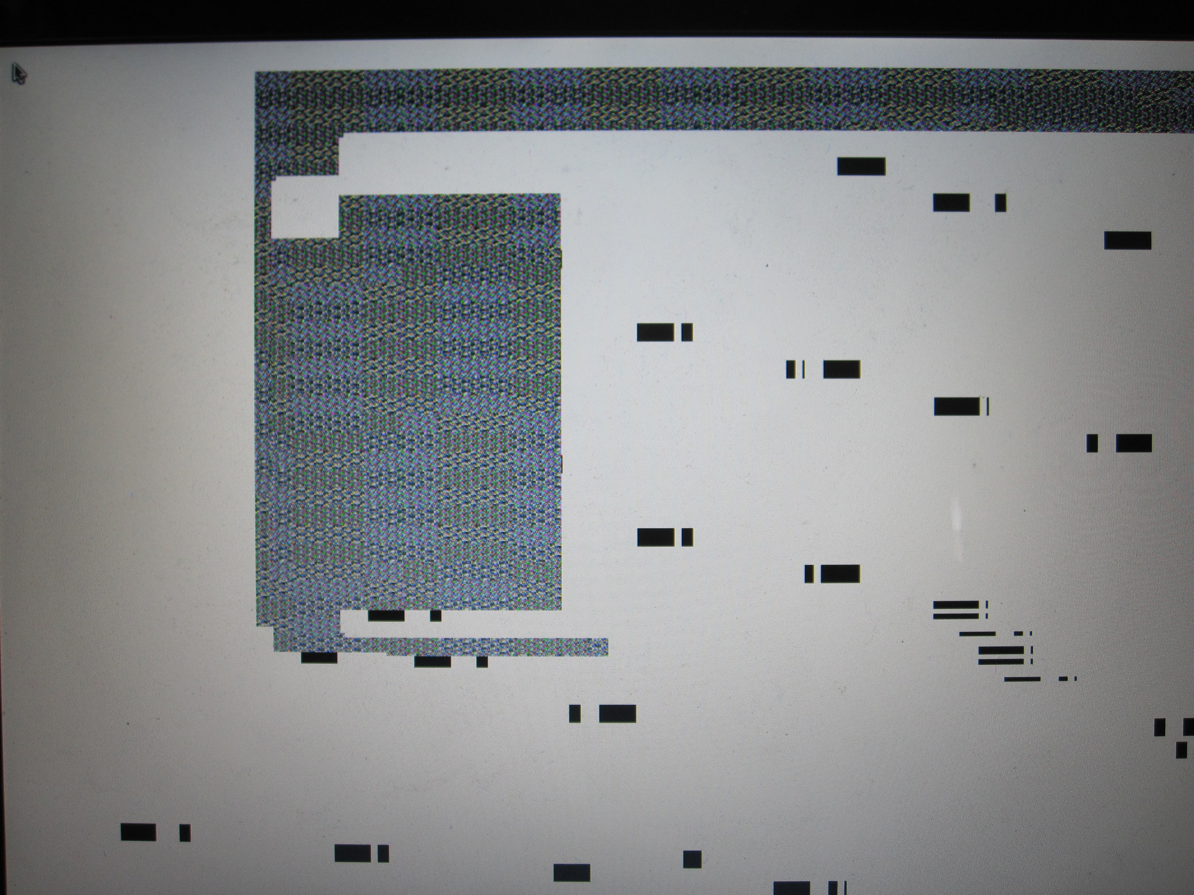

Martuzki Posted May 2, 2011 Share Posted May 2, 2011 How can i fix this? State (with this kexts): Internal LVDS Display has crazy colors (Attached pic) External VGA works (1920x1080) No QE/CI pls help P.S: Can someone help me over TeamViewer? Link to comment Share on other sites More sharing options...

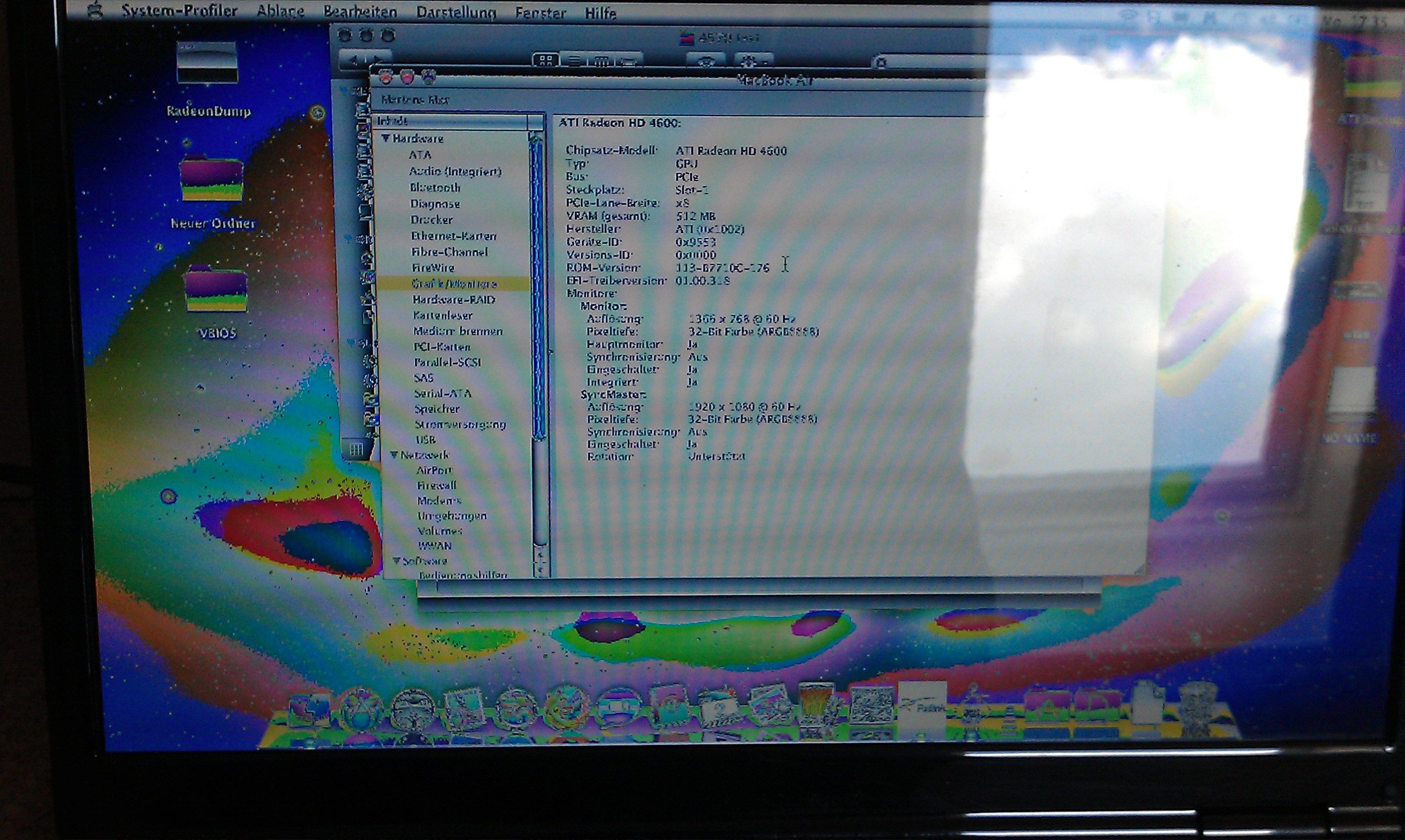

Martuzki Posted May 15, 2011 Share Posted May 15, 2011 Can someone help me? I can't get QE & CI on my 4570 Mobility to work I tried this: Peregrine: VGA 02 00 00 00 40 00 00 00 09 01 00 00 02 01 01 02 LVDS 10 00 00 00 10 00 00 00 00 01 00 00 00 10 00 01 Both will work and i can change the res to 1366x768. On the VGA Output the screen is not centred. How can i get QE/CI to work? Some Infos: Kexts loaded: ATIFramebuffer.kext ATI4600Controller.kext ATIRadeonX2000.kext ATISupport.kext Sys Profiler: ATI Radeon 4500 Mobility Series: Chipsatz-Modell: ATI Radeon 4500 Mobility Series Typ: GPU Bus: PCIe Steckplatz: Slot-1 PCIe-Lane-Breite: x8 VRAM (gesamt): 512 MB Hersteller: ATI (0x1002) Geräte-ID: 0x9553 Versions-ID: 0x0000 ROM-Version: 113-B7710C-176 EFI-Treiberversion: 01.00.318 Monitore: Monitor: Auflösung: 1366 x 768 @ 60 Hz Pixeltiefe: 32-Bit Farbe (ARGB8888) Hauptmonitor: Ja Synchronisierung: Aus Eingeschaltet: Ja Integriert: Ja SyncMaster: Auflösung: 1920 x 1080 @ 60 Hz Pixeltiefe: 32-Bit Farbe (ARGB8888) Synchronisierung: Aus Eingeschaltet: Ja Rotation: Unterstützt BIOS Dump: ATOM BIOS Rom: SubsystemVendorID: 0x1019 SubsystemID: 0x2379 IOBaseAddress: 0x9000 Filename: BR033553.004 BIOS Bootup Message: BR033553.004 M92 DDR2 64bit 500e/500m PCI ID: 1002:9553 Connector at index 0 Type [@offset 45504]: VGA (1) Encoder [@offset 45508]: INTERNAL_KLDSCP_DAC1 (0x15) i2cid [@offset 45548]: 0x90, OSX senseid: 0x1 Connector at index 1 Type [@offset 45514]: LVDS (7) Encoder [@offset 45518]: INTERNAL_UNIPHY2 (0x21) i2cid [@offset 45571]: 0x91, OSX senseid: 0x2 Thanks for any help! Link to comment Share on other sites More sharing options...
spac3man Posted May 16, 2011 Share Posted May 16, 2011 Hi all!We finally succeeded in getting Mobility Radeon HD 4xxx working with QE/CI ... Great work, but I think there're too many people who don't understand how to get their cards working I've been trying to get QE/CL on my Mobility HD 4330, I tried different ways, and now I use kexts from that topic: http://www.insanelymac.com/forum/index.php?showtopic=255976 The problem is that I can't use GraphicsEnabler=Yes, because I got the screen full of colored blocks (you can see it in attachment). Also, you can read what I did in this topic: http://www.insanelymac.com/forum/index.php...t&p=1683842 Can you at least upload your kexts? Maybe some magic will happen... Anyway, thanks! Link to comment Share on other sites More sharing options...
