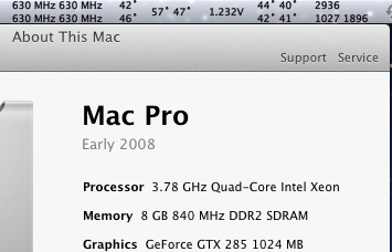

D-an-W Posted July 27, 2011 Share Posted July 27, 2011 Does anyone know if K-Stat-i has a maximum CPU speed it can display? 3750MHz shows fine, 3780MHz only shows as a three digit number e.g.: 630MHz to 945MHz (Speedstep enabled). Everywhere else the cpu speed is displayed correctly... Link to comment Share on other sites More sharing options...

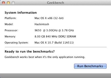

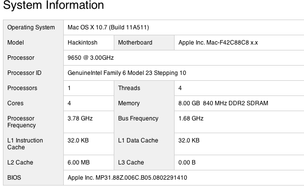

MaLd0n Posted July 27, 2011 Author Share Posted July 27, 2011 Does anyone know if K-Stat-i has a maximum CPU speed it can display? 3750MHz shows fine, 3780MHz only shows as a three digit number e.g.: 630MHz to 945MHz (Speedstep enabled). Everywhere else the cpu speed is displayed correctly... Run GeekBench Link to comment Share on other sites More sharing options...
D-an-W Posted July 27, 2011 Share Posted July 27, 2011 I get a score of 8132... Link to comment Share on other sites More sharing options...
MaLd0n Posted July 27, 2011 Author Share Posted July 27, 2011 I get a score of 8132... it solves? SMexternalclock = fsb (400x4=1600) and SMmaximalclock = processor clock in smbios Link to comment Share on other sites More sharing options...

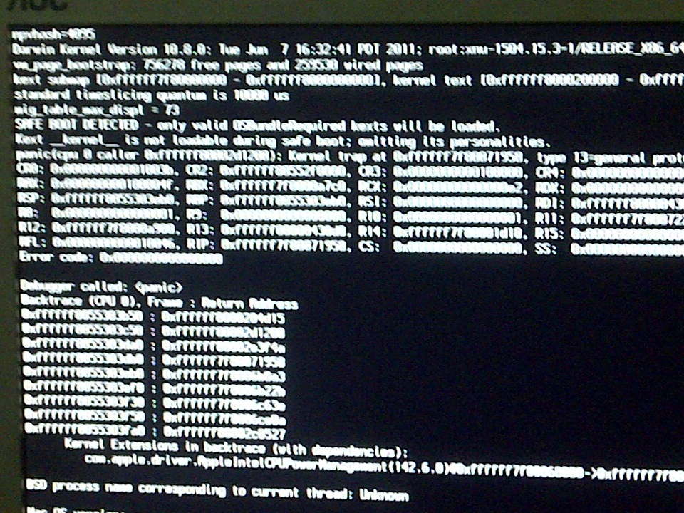

drmixkma Posted July 27, 2011 Share Posted July 27, 2011 Maldon, here's the KP's photo . Thanks before. Link to comment Share on other sites More sharing options...
D-an-W Posted July 27, 2011 Share Posted July 27, 2011 it solves?SMexternalclock = fsb (400x4=1600) and SMmaximalclock = processor clock in smbios No, doesn't work. 419x9 works ok with K-Stat-i, anything >419 (tried 420, 421, 422) and K-Stat-i doesn't show the correct CPU speed even with this is in the SMBIOS.plist... <key>SMexternalclock</key> <string>422</string> <key>SMmaximalclock</key> <string>3798</string> Link to comment Share on other sites More sharing options...
MaLd0n Posted July 27, 2011 Author Share Posted July 27, 2011 tried already and i got "PCI Configuration Begin" then it just hang there. Try 1 : Boot direct without any flag ==> failed Try 2 : Boot with -f -x -v -arch=i386 ==> stuck at "PCI Configuration Begin" Try 3 : Boot with -f -x -v -arch=i386 npci=0x2000 ==> also stuck at "PCI Configuration Begin" I used [url="http://www.insanelymac.com/forum/topic/279450-why-insanelymac-does-not-support-tonymacx86/"]#####[/url] 3.8.0 to install this DSDT. Please kindly advice on how to fix this problem. And many many thanks I do not use [url="http://www.insanelymac.com/forum/topic/279450-why-insanelymac-does-not-support-tonymacx86/"]#####[/url] I know what I install you know? Maldon, here's the KP's photo . Thanks before. http://www.insanelymac.com/forum/index.php...258611&st=0 Link to comment Share on other sites More sharing options...
