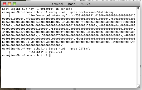

echo7117 Posted May 1, 2011 Share Posted May 1, 2011 http://code.google.com/p/iats/ send me your DSDT send me a new kextstat, run on terminal and ioreg -lw0 | grep PerformanceStateArray ioreg -lw0 | grep CSTInfo send me a new kextstat PS2? here's my new kextstat and captured screen for "ioreg"s i really hope that you can take care of this prlbms... thx in advance. you are getting my mac life saver kextstat.txt Link to comment Share on other sites More sharing options...

MaLd0n Posted May 1, 2011 Author Share Posted May 1, 2011 here's my new kextstat and captured screen for "ioreg"s - can't detect my pci sound card /echo gina 3g Try with clean install my restart/shutdown is partial working send me DSDT restart --> Chameleon RC5, Shutdown --> DSDT ... if the devices are already just the _DSM facilitate things and use GraphicsEnabler=Yes + drivers fermi I'm with a lot of work You need to test I'm not sure about it(Nvidia 420M) the result is the same(DSDT or GraphicsEnabler) Link to comment Share on other sites More sharing options...

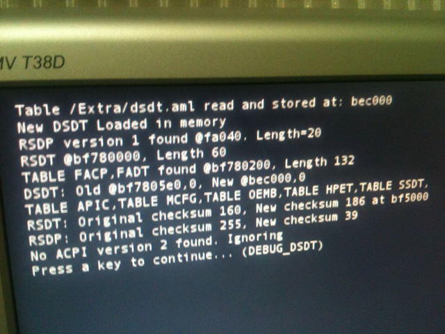

echo7117 Posted May 1, 2011 Share Posted May 1, 2011 - can't detect my pci sound card /echo gina 3g <--- use kext and try in "32", arch=i386 Try with clean install tried 32bit mode.. but failed... i really don't know how to do.. do i gotta give it up........;;;? any other things you think up with... also you know how to fix the booting key press issue?? everytime i try to boot, i gotta press any key to continue like the captured (DEBUG_DSDT) at least i wanna boot without pressing any key.. sorry for keeping asking you... but now that i'm gone far from my own to your advice..... plz help me out of here... thx thx thx in advance. Link to comment Share on other sites More sharing options...

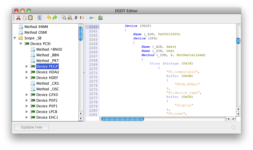

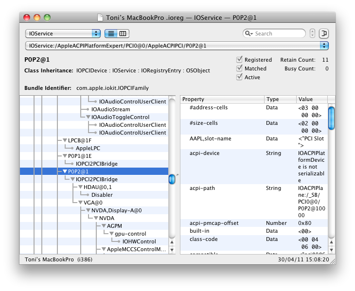

fc bayern Posted May 1, 2011 Share Posted May 1, 2011 I've been playing for 6 hours or so, without success. I have Device GFX0 ubder PCIO, when i tried to update that and delete PEGP , compiling error Also I have tried to move the PEGP inot POP2, no success ,No Graphics Injection Im confused, i have device VGA ubde POP2, also device GFXO - what shoul stay, what shoul be updated - I have no Idea Also HDAU is present as device (under device VGA), should it be only once present or twice. I know You wanna make me learn, im willing to also - but this is simply to much for me PLS be so kind an post updated DSDT for me IF You wanna PLS correct the thing that You've mentioned in the post above . By the way Fermi drivers are installed - without them no QE/CI, no rezolution change at all - i dont understand what You're suggesting. I am pationed about this thing and willing to learn more and more, but sorry i can not handle this - im confused Tnaks MaLdOn Attached mu latest DSDt (pegp moved into POP2 section, but no injection ???) dsdt.aml.zip Link to comment Share on other sites More sharing options...
