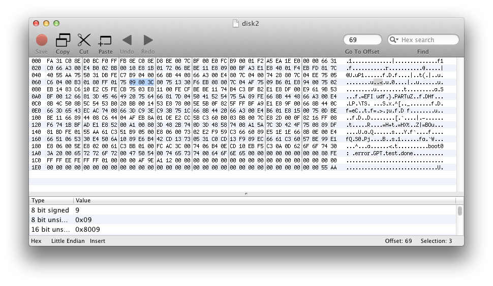

blackosx Posted October 7, 2011 Share Posted October 7, 2011 Fabio, from the code you posted earlier I see disk0 shows boot0, but I can't identify the code for disk2 ? The script checks bytes 069h-06Bh for a match against some know values, for example: 0a803c for boot0, 0b807c for boot0hfs. But as you can see from your posted result, you have 09803c which I don't have a match for? hmm.. which boot0 file did you write to disk2? Found errors with EN-Localizable.strings as below. Do I need to modify the title to be "New C-State _CST=Yes" or something else ? "CSTUsingSystemIO_title" = "Generate C-States=Yes"; "CSTUsingSystemIO_description" = "New C-State _CST generation method using SystemIO registers instead of FixedHW."; "GenerateCStates_title" = "Generate C-States=Yes"; "GenerateCStates_description" = "Enable auto generation of processor idle sleep states (C-States)."; To be honest I haven't touched either of those, but now you ask I think they both do the same thing but in different ways. So ideally the user would only choose one of them, not both in which case they can stay as they are. But I agree it's confusing. However, for now, I will work on finishing the installer and making sure that's working before finalising the text as that might change between now and when it's finished. Link to comment Share on other sites More sharing options...
