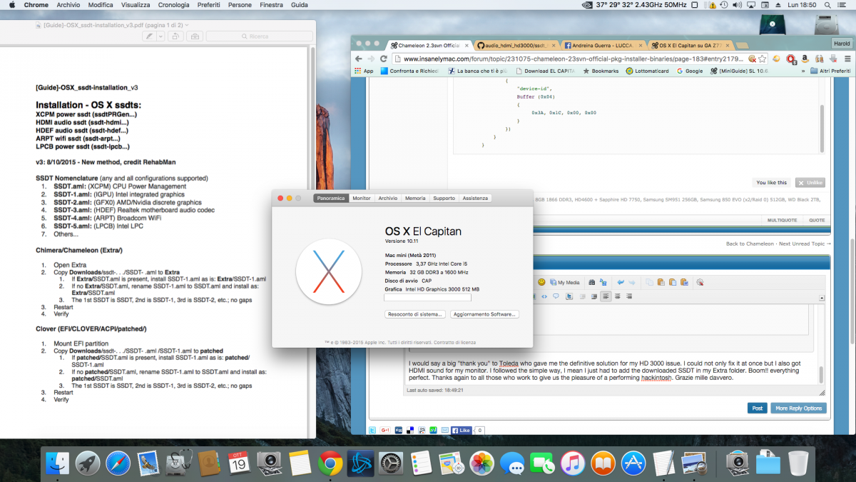

bluenote56 Posted October 18, 2015 Share Posted October 18, 2015 Let me chime in on this one as well. I was reading this: "This patch will fix i5-2500K issue, too." and thought... huh? Which issue? You know. I am actually typing this on a hack with a Gigabyte motherboard with an Intel i5-2500K and I can't remember having seen any issue. Not at all. What am I missing here? Hi I suppose my situation is different, but with my mixed Z77/i5-2500k there's no way (at least for me) to get it working. I mean it's not recognized and so on. ErmaC is giving me some very appreciated help about it at the moment but any suggest to fix it would be great. Thanks all of you for what you do for dumb "hackintoshers" like me. lol. ciao Link to comment Share on other sites More sharing options...
toleda Posted October 19, 2015 Share Posted October 19, 2015 my mixed Z77/i5-2500k there's no way (at least for me) to get it working. HD3000 MEI, dsdt or ssdt injection: Set MEI@16/device_id/0x3a1c0000 ssdt: ssdt_hdmi-hd3000-7series-3.zip dsdt: Device (MEI) { Name (_ADR, 0x00160000) // _ADR: Address Method (_DSM, 4, NotSerialized) // _DSM: Device-Specific Method { If (LEqual (Arg2, Zero)) { Return (Buffer (One) { 0x03 }) } Return (Package (0x02) { "device-id", Buffer (0x04) { 0x3A, 0x1C, 0x00, 0x00 } }) } } 1 Link to comment Share on other sites More sharing options...
bluenote56 Posted October 19, 2015 Share Posted October 19, 2015 HD3000 MEI, dsdt or ssdt injection: Set MEI@16/device_id/0x3a1c0000 ssdt: ssdt_hdmi-hd3000-7series-3.zip dsdt: Device (MEI) { Name (_ADR, 0x00160000) // _ADR: Address Method (_DSM, 4, NotSerialized) // _DSM: Device-Specific Method { If (LEqual (Arg2, Zero)) { Return (Buffer (One) { 0x03 }) } Return (Package (0x02) { "device-id", Buffer (0x04) { 0x3A, 0x1C, 0x00, 0x00 } }) } } I would say a big "thank you" to Toleda who gave me the definitive solution for my HD 3000 issue. I could not only fix it at once but I also got HDMI sound for my monitor. I followed the simple way, I mean I just had to add the downloaded SSDT in my Extra folder. Boom!! everything perfect. Thanks again to all those who work to give us the pleasure of a performing hackintosh. Grazie mille davvero. Link to comment Share on other sites More sharing options...
