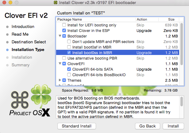

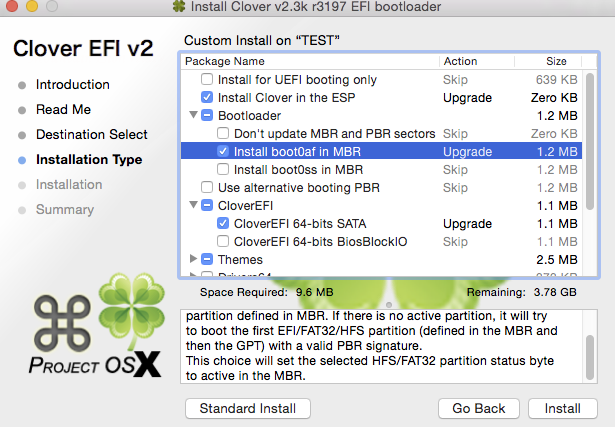

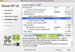

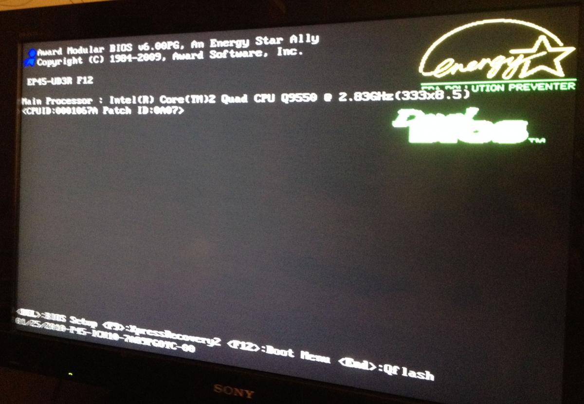

fusion71au Posted March 31, 2015 Share Posted March 31, 2015 setting active partition chnages value at 00001ce. i just tested using "fdisk -e /dev/rdiskX" and flagging second slice as active. then checked 1st sector and there is "80" at 00001ce. but i could not really understand why my pc stuck at POST screen, but yours (you and luxinhaus confirmed) are ok. if its only me, maybe i have something wrong configs in BIOS. i dunno. thanks. It's not only you and its not only the Chameleon installer . I've also noticed that behaviour on my legacy BIOS desktop rig with legacy Clover - a Gigabyte P55aUD3/Intel i5 750/ATI HD5770 system. If I install Clover on a GPT partitioned USB with the "boot0af in MBR" option, the installer sets an active partition ---> system will hang on boot with the USB plugged in: Some workarounds 1. Installing Clover with the "Install boot0ss in MBR" option ---> installer does not set an active partition ---> system boots normally 2. Partitioning the USB with MBR layout instead of GPT The issue does not appear when the bootloader is installed on the hard disk with boot0af option & active partition (only USB). Also not all legacy BIOS machines have the problem - my Dell laptop XPS M1530 happily boots from a GPT USB with active partition set and boot0af . 4 Link to comment Share on other sites More sharing options...

ea dd Posted April 1, 2015 Share Posted April 1, 2015 It's not only you and its not only the Chameleon installer . I've also noticed that behaviour on my legacy BIOS desktop rig with legacy Clover - a Gigabyte P55aUD3/Intel i5 750/ATI HD5770 system. nice to hear i'm not alone in a boat. thanks for sharing your experience. so, i take that "stuck at POST screen" problem as solved. also thanks to Micky1979, luxinhaus, Ermac. Link to comment Share on other sites More sharing options...
Micky1979 Posted April 1, 2015 Share Posted April 1, 2015 well. As soon I have time I'll made a package with a sub options (always enabled by default) to disable the choices and skip the install of stage 0, stage 1 and activation. This way you can chose what to do. just to test... 1 Link to comment Share on other sites More sharing options...
