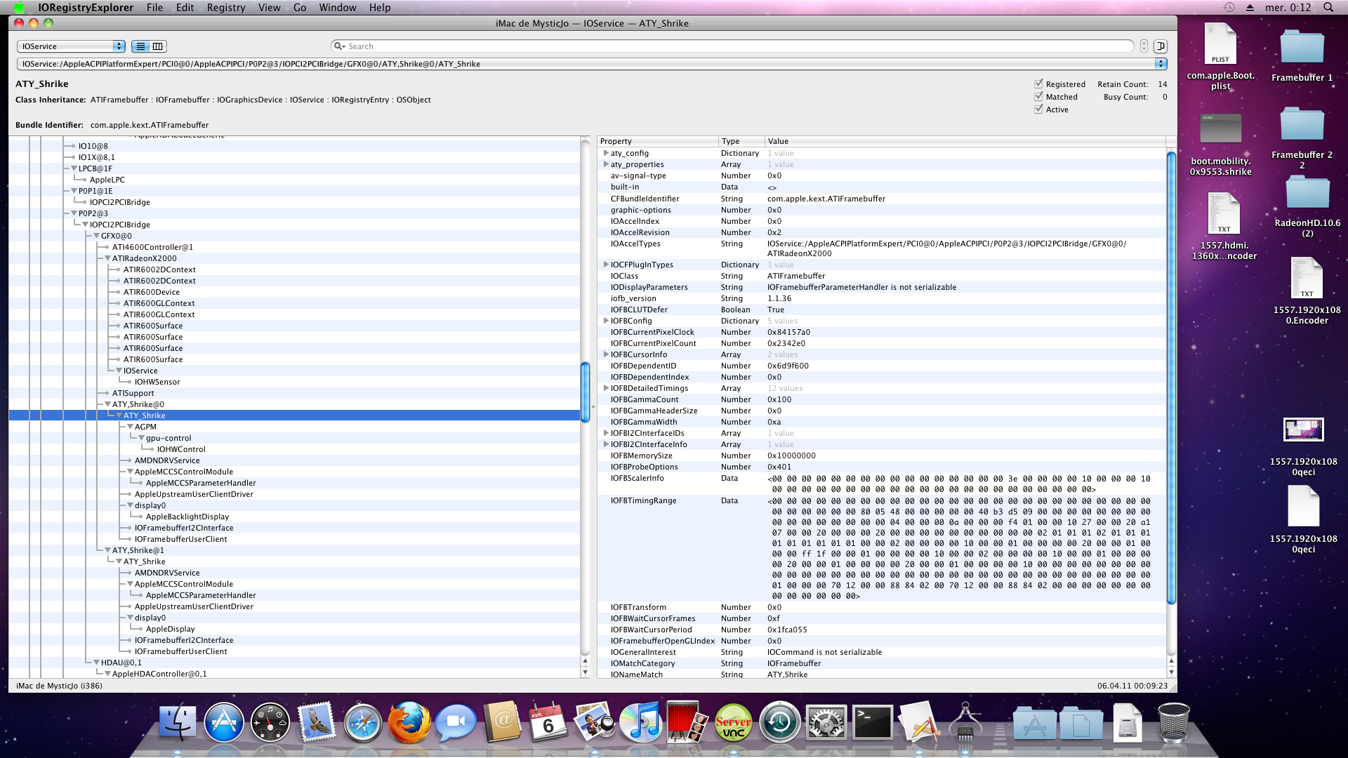

kizwan Posted April 4, 2011 Author Share Posted April 4, 2011 UPDATES I want to explain a little bit how I got my HD4570 working. Before mucha's guide available, I'm able to get HDMI working with 10.6.6 kexts after I learn the ATY,ControlFlags for LVDS (0x40) & HDMI (0x204). I'm able to get LVDS & HDMI partially working. Before that I also found ATY,ControlFlags for VGA which is 0x10. Later I learn ATY,ControlFlags for HDMI with 10.6.6 kexts is 0x200. Since LVDS & HDMI partially working, I tried VGA instead. This is when I'm able to get dual-monitor working with LVDS & VGA. When mucha's guide available & with help from mucha, I learn that the LVDS & HDMI was partially working because both are using the same link which basically caused the interference. With mucha's guide, I'm able to get all ports working. Regarding the ATIFramebuffer.kext available at Post #36. It contain Shrike's patched connection table that make all three connections (LVDS, VGA & HDMI) working. Remember, my internal LCD's resolution is 1366x768. This is Shrike's patched connection table I use in ATIFramebuffer.kext which available at Post #36.02 00 00 00 40 00 00 00 09 01 00 00 12 00 00 01 (LVDS) 10 00 00 00 10 00 00 00 00 01 00 00 00 10 01 06 (VGA) 00 08 00 00 00 02 00 00 00 01 00 00 20 01 02 02 (HDMI) This is Shrike's patched connection table I use after I obtain Transmitter & Encoder information using dong's RadeonHD.kext (10/20/2009 update). dong's RadeonDump's log (external monitor connected to HDMI port):- ... /* more messages, skipped */ ... Mapping DIG1 encoder to KLDSKP_UNIPHYB Connector "DVI-D 1" uses Monitor "SMB2330H": ... /* more messages, skipped */ ... Mapping DIG2 encoder to KLDSKP_UNIPHYE Crtc[1]: found native mode from Monitor[LVDS Panel]: Modeline "1366x768" 67 1366 1383 1395 1434 768 771 773 781 Connector "PANEL" uses Monitor "LVDS Panel": ... /* more messages, skipped */ ... Listing modesetting layout: ATOM CRTC 1: tied to Atom PLL 1 and LUT A: Outputs: AtomOutputUniphyB (DVI-D 1) ATOM CRTC 2: tied to Atom PLL 2 and LUT B: Outputs: AtomOutputUniphyE (PANEL) Unused Outputs: AtomOutputDACB Based on the above information, the connections are:-CRTC0 > DIG1 > UNIPHYB > HDMI: Encoder=0x00 Transmitter=0x20CRTC1 > DIG2 > UNIPHYE > LVDS: Encoder=0x01 Transmitter=0x12CRTC1 > DAC > DACB > VGA: Encoder=0x10 Transmitter=0x10 So the correct connection table is:-02 00 00 00 40 00 00 00 09 01 00 00 12 01 00 01 (LVDS)10 00 00 00 10 00 00 00 00 01 00 00 10 10 01 06 (VGA)00 08 00 00 00 02 00 00 00 01 00 00 20 00 02 02 (HDMI) Conclusion Based on the above results, the Transmitter & Encoder are not important. Almost any values should works as long as they're not conflicting with each other like I experienced at the beginning of my attempt. So far, all successful report I read which successfully got their graphic card working on their notebook have internal LCD screen with the highest resolution is 1366x768. I believe, based on several documents & datasheets I found, internal LCD with resolution higher than 1366x768 (probably higher than 1440x900????) require dual-link/two channel LVDS transmitter. Dell Studio 1557 have LVDS interface with dual-link/two channel LVDS transmitter (checked in schematic). That's why Studio 1557 can support Full HD LCD. Mine only equipped with 1366x768 internal LCD panel. I can upgrade to Full HD LCD anytime. Several iMac, e.g. iMac11,1, use DP_INT (internal DisplayPort????) instead of LVDS. Does this means iMac with higher resolution than 1366x768 use DP_INT while iMac with screen resolution 1366x768 (probably 1440x900????) & lower use LVDS? Need to examine all iMac's IORegistry dump to get clear picture. Probably, the dual-link/two channel LVDS transmitter driver support only available for several graphic cards. For example, latest 17" MacBookPro8,3 use LVDS for the internal LCD panel which have higher resolution than 1366x768. One thing for sure, LVDS must be at first row in connection table. I did tried putting LVDS at third row like this:- 10 00 00 00 10 00 00 00 00 01 00 00 10 10 01 06 (VGA) 00 08 00 00 00 02 00 00 00 01 00 00 20 00 02 02 (HDMI) 02 00 00 00 40 00 00 00 09 01 00 00 12 01 00 01 (LVDS) With the above connection table, with LVDS at third row, only LVDS is working. Any monitor connected to VGA & HDMI are not detected at all, not even in IORegistry. Resources http://www.spwg.org/spwg_spec_version3.5_3-29-2005.pdf http://www.toshiba-components.com/mobile/data/Toshiba_TC358764_65XBGA.pdf My files Encoder_RadeonDump.txt OFFSET_IN_FILE_SHRIKE_32BIT.txt OFFSET_IN_FILE_SHRIKE_64BIT.txt Link to comment Share on other sites More sharing options...

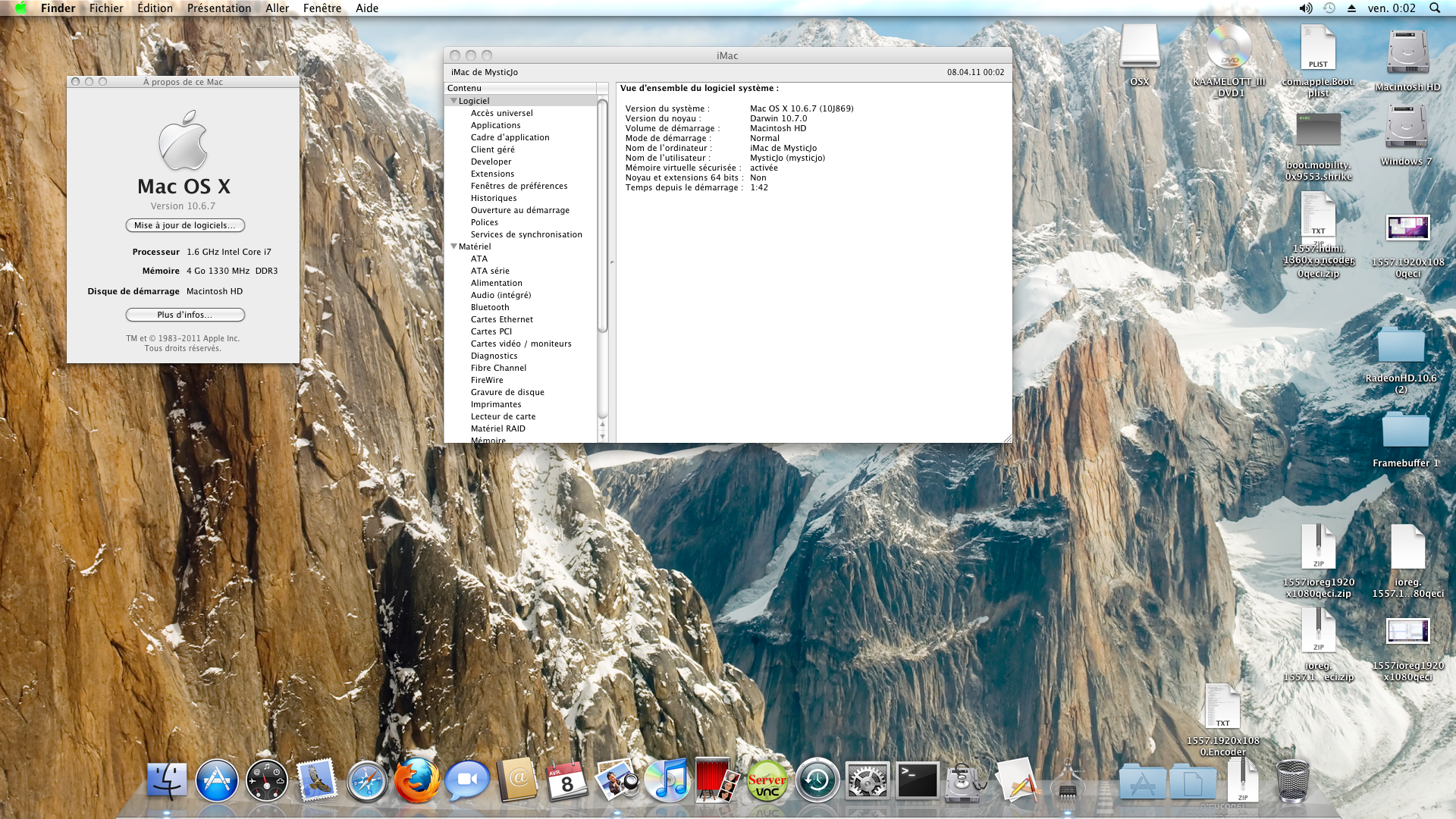

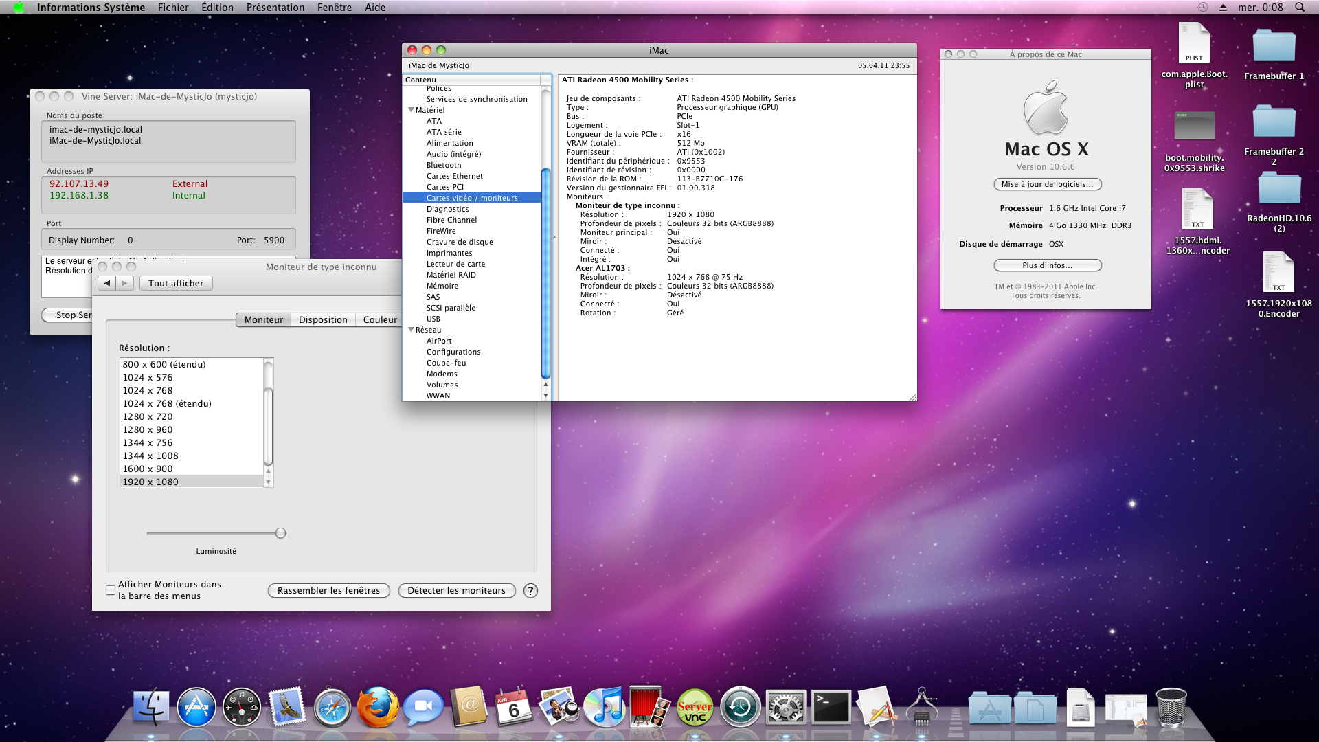

kizwan Posted April 5, 2011 Author Share Posted April 5, 2011 Ok, before reinstalling, i have retest your ATIFramebuffer.kext, with vga and hdmi. I have put the graphic card id in ATI4600controller.kext use touch /System/Library/Extension and run kextutility to repair permissions. I used the previous bootloader, (chameleon with trunk, build 16.03.2011) Ive got external screen worked properly with qe/ci And Surprising to me, the internal screen work in 1920x1080 with qe/ci Just a little problem with the fan who work as maximum and dont slow. Do you mean your internal LCD is working? I'll check your IOREgistry. This is interesting. Link to comment Share on other sites More sharing options...
jofox78 Posted April 6, 2011 Share Posted April 6, 2011 Do you mean your internal LCD is working? I'll check your IOREgistry. This is interesting. Yes, this is what i mean , all is working good, the water effect when i add a widget in dashboard, the dvd player work. and rectification, the fan is not running at the maximum, but higher than in linux or windows. I ve got problem with sound, do you have applehda modified, or not, installed on your 1557? Link to comment Share on other sites More sharing options...

jofox78 Posted April 7, 2011 Share Posted April 7, 2011 Now I'm using new connection table based on my dong's RadeonHD's log (Shrike framebuffer). Your dong's RadeonHD's log also similar with mine, you might want to test my current patched kext Many Thanks for your help and bcc9, mucha, and other who have discovered the method Ive tested with fresh install many config, and the only working for me is the shrike first connection table : 02 00 00 00 40 00 00 00 09 01 00 00 12 00 00 01 (LVDS) 10 00 00 00 10 00 00 00 00 01 00 00 00 10 01 06 (VGA) 00 08 00 00 00 02 00 00 00 01 00 00 20 01 02 02 (HDMI) Ports are all working, qe/ci, full internal resolution 1920x1080, but no mirroring I have made the update to 10.6.7, and test your atiframebuffer 10.6.7 patched, it dont work for me, so i ve patch the 10.6.7 kext from fresh update myself with the old connection table and its work for me. Effectively, the fan's running lower than before, but a little bit high. I have posted my configuration in your collection's thread post : http://www.insanelymac.com/forum/index.php...p;#entry1660086 So, the original package I shared at Post #36 also works for Full HD LCD too. Probably when you installed the patched ATIFramebuffer.kext at first time you forgot to make sure it loaded. It now works because you touch /System/Library/Extension & repair the permissions which you should have done at the first place. It's common sense that's why I didn't mentioned it at Post #36. Let me know whether you can or not replicate the success with fresh install. Congratulations! Yes, it work for 1920x1080, but only the "old framebuffer" and your are right, ... ... i dont have repair permissions on the first time... The audio card's working now with your patched id applehda.kext Many Thanks you're a genius Link to comment Share on other sites More sharing options...
