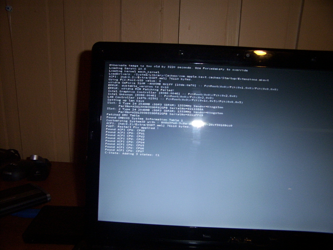

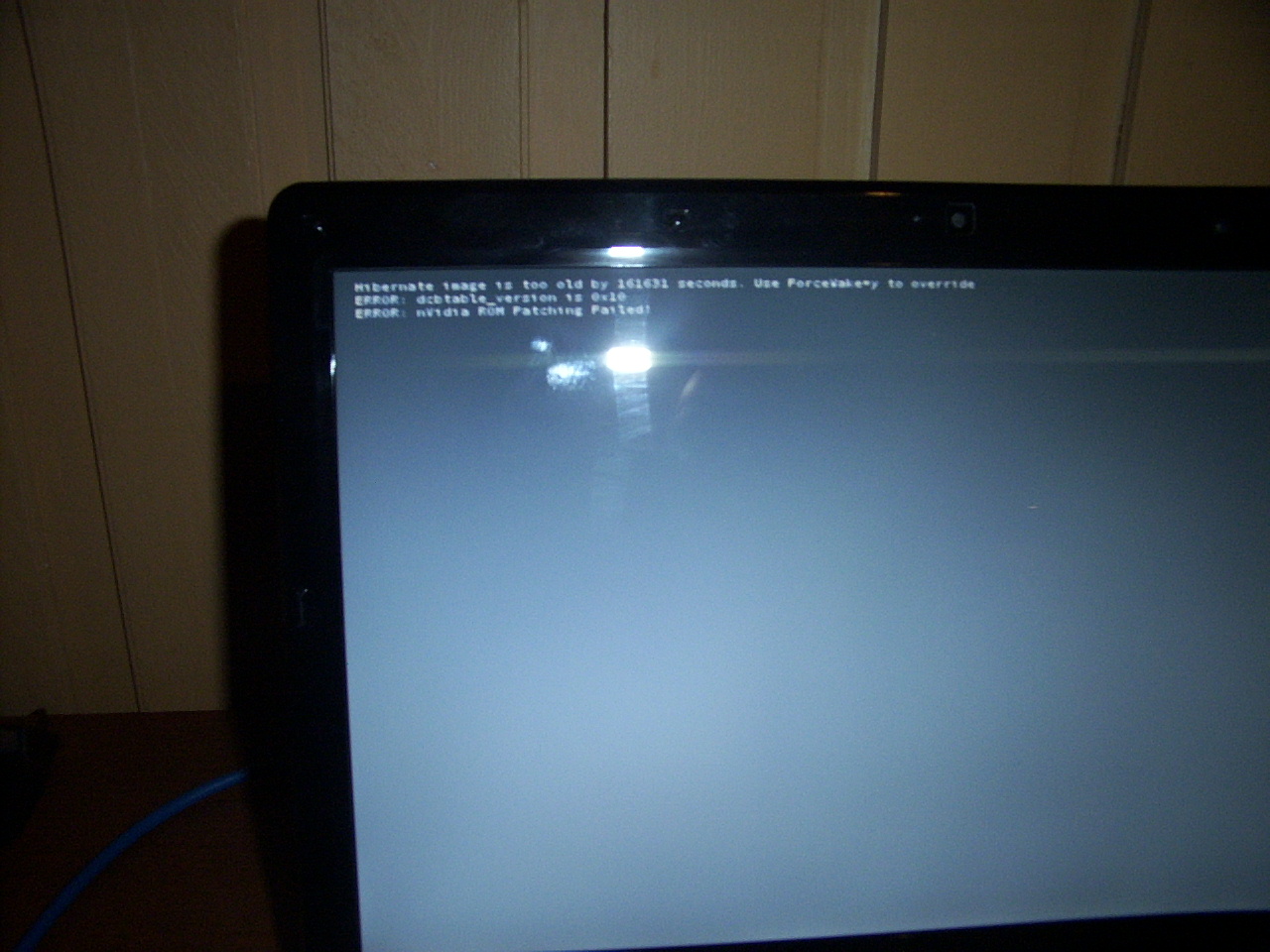

hello VALV have a problem injection nvidia geforce 310M on my ASUS K52JC an error with the boot is it possible to fix error thank you
PCI\VEN_10DE&DEV_0A70&SUBSYS_14321043&REV_A2
PCI\VEN_10DE&DEV_0A70&CC_030000
@gerard71
I have just tried using this bootloader (version 5.1.4) and the 310M, it has no problem identifying the card. See extract from my output of BDMesg below:

The above output is of course generated using graphicsenabler=yes and works perfectly.
However, you might also want to try using a modified com.apple.boot.plist using graphicsenabler=no and specifically injecting device properties from a MacBookPro. That is actually what I use day to day with my bootloaders and the reason is that injecting the device properties makes the brightness functions work correctly too for the 310M, 320M, 330M as long as your DSDT is also modified to include Device (PNLF) - check out other posts on Insanelymac on what that means . I realise this is a little off topic, but I think you will find that it makes your system work better. For your reference, I attach the boot plist I am using now and you could try it out.....to avoid going too far off topic you can PM me about this if you want.
com.apple.Boot.plist.zip
Try with GeneratePStates=No
That is worked on my rig.
