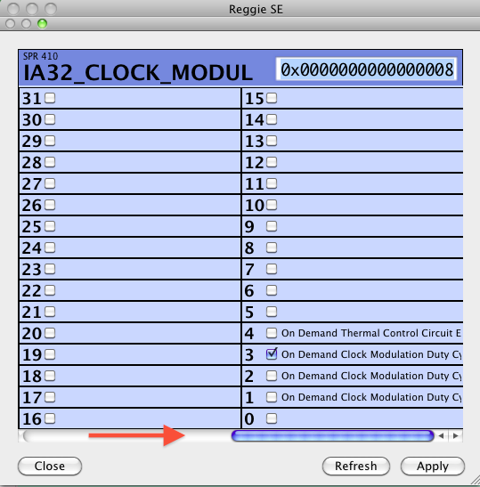

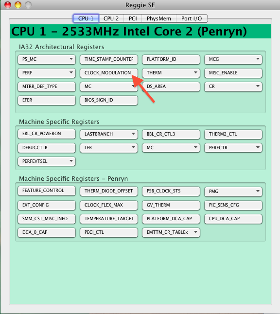

If u want, u can use this one:boot.zipbefore u do, I'd like to be sure about something. Do u have reggie_se app ? if yes, run it. Then on the cpu section click on CLOCK MODULATION (just like on the screenshot)
then give a screenshot of what is showing behind (like the one below)
p.s: pay attention to scroll the window to most right:
Reggie_SE first show me: "Unknow processor type (659)" and I don't see Processor section at all ??
yep, I was doubting it'd work as I have got same thing in the past.

Regarding Reggie_SE, I got it fixed after installing windows and updating chipset. I don't know if it 'd work for u though.

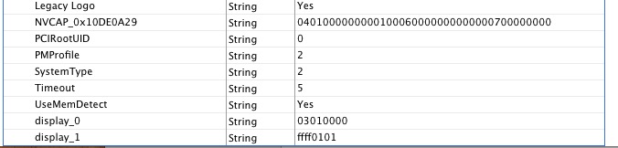

I use your v5.0.8 and can't get NVCAP feature working from Boot.plist. Would you mind describing how to use it?

For the nvcap injection, rename the key to NVCAP_0A29.

And what are that keys display_0 / 1 for in boot.plist ? Belongs that to NVCAP values ? How to get them ?

display_0/1 are for display-cfg injection.

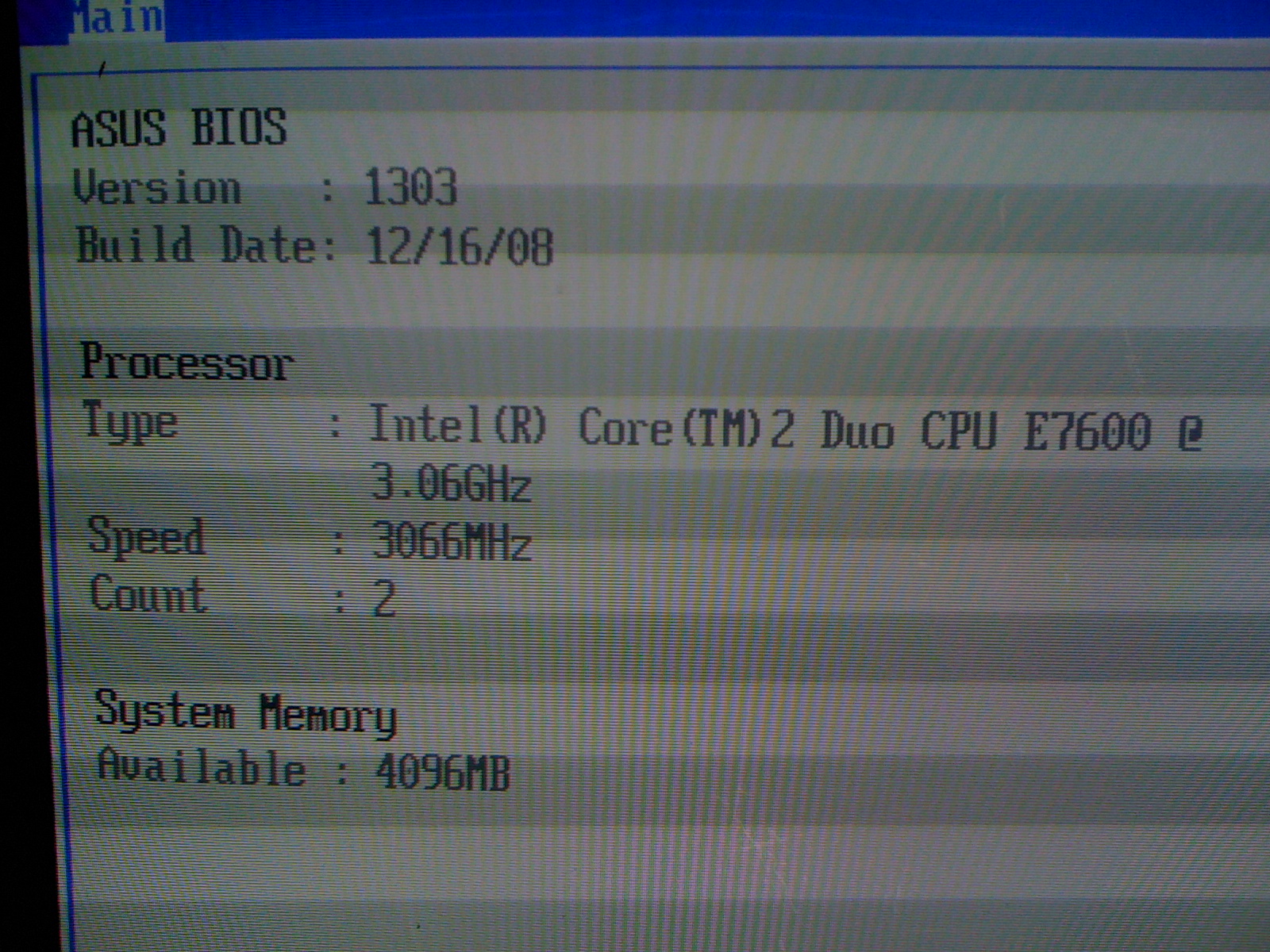

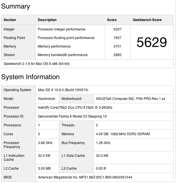

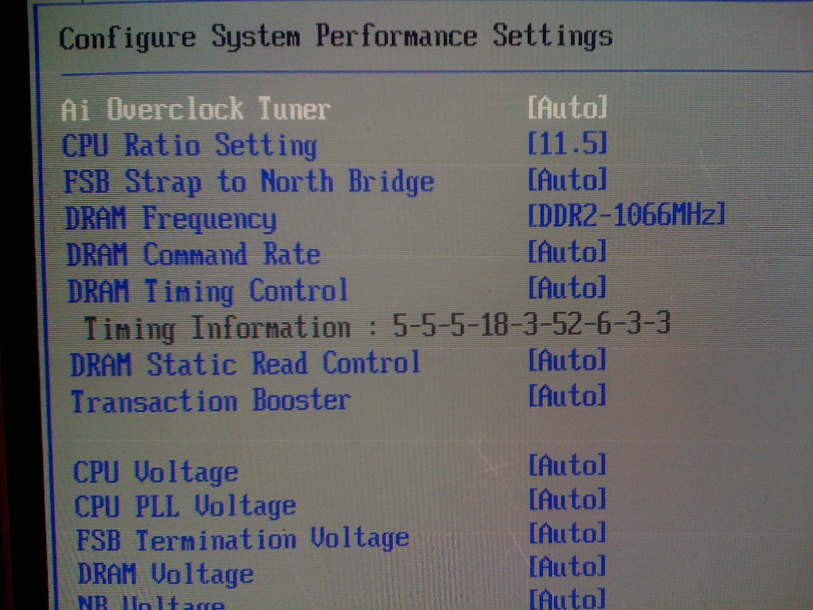

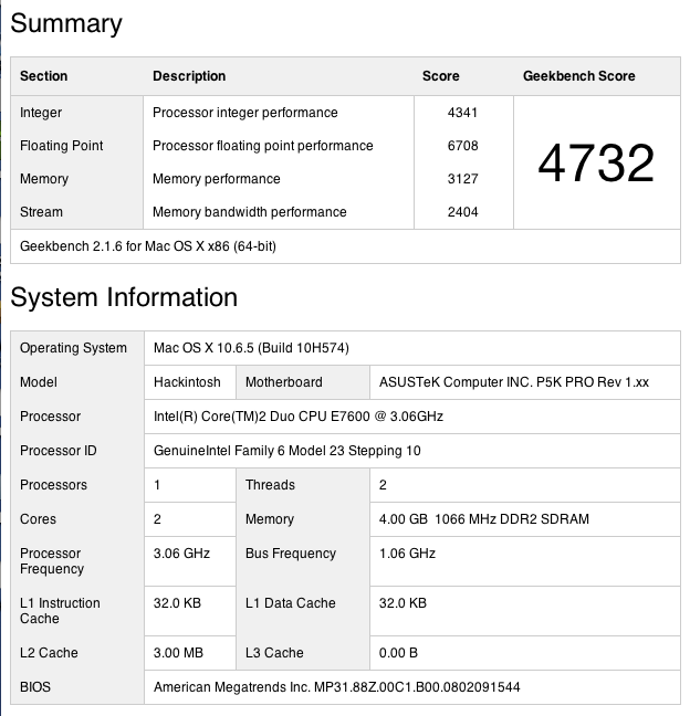

hi valv, i´ve got it :(
i made CPU changes in my dsdt and now i get all C and P states working with MacPro3.1
but the very best, OC works too from com.apple.Boot.plist. just set ForceFSB=320
all is set to auto 3060 Mhz and works with 3680 Mhz. :)
Vcore is set to auto too. if i want to OC to 3852 i need more Vcore but min/maxvolt don´t take effekt.
are you able to fix this or is it impossible because Asus don´t wont it ?
so i want to say a big thank you for your work !!
@Carstiman,
hey, am glad it did work :wallbash: and would like to thank u for not giving up. That's, giving anval more testing time and efforts, like u did.
honestly, I don't know (for now). but any suggestion is welcome :unsure:
