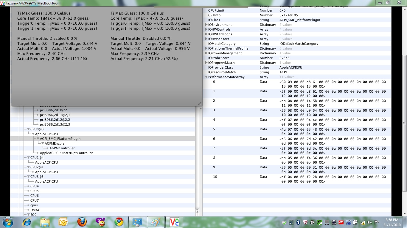

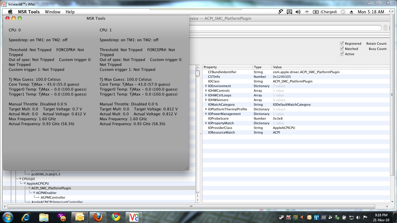

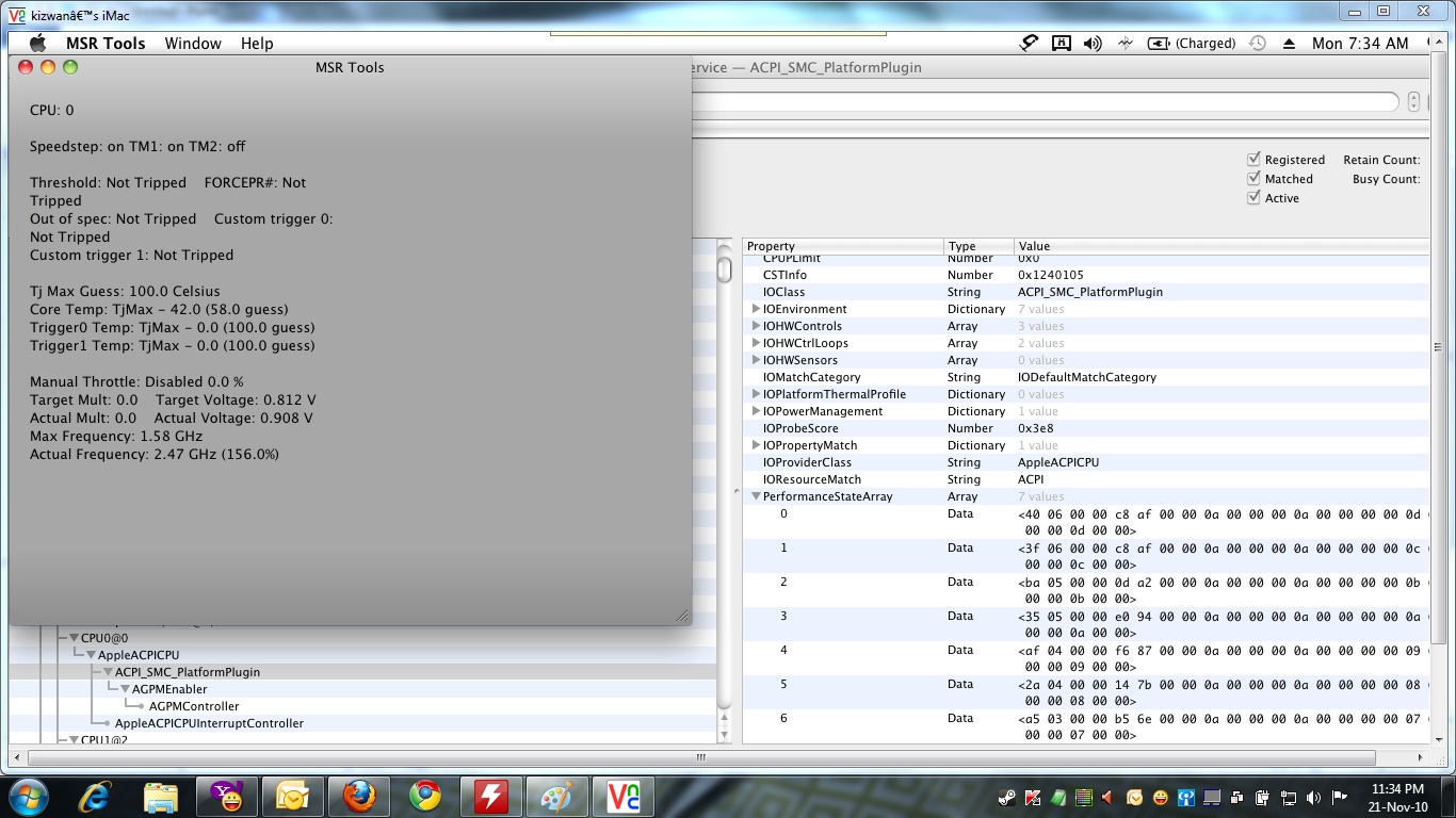

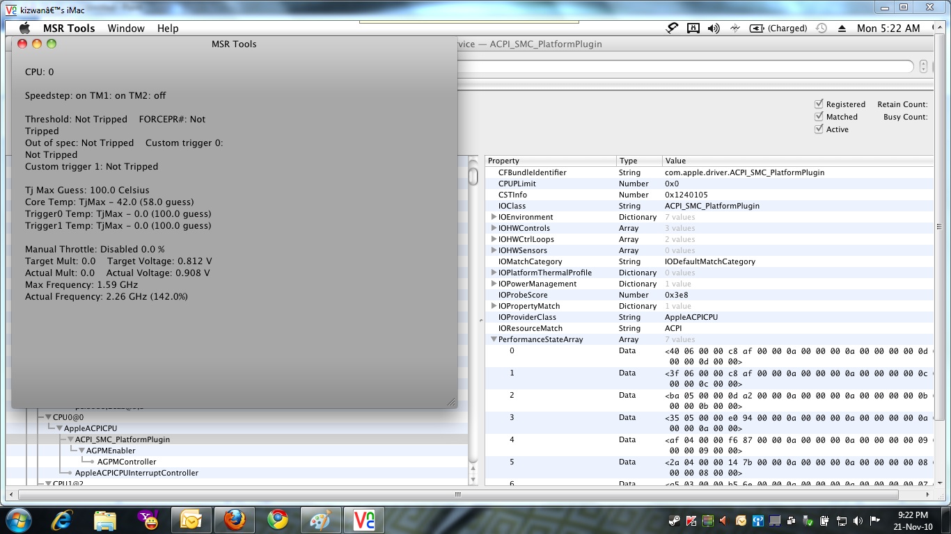

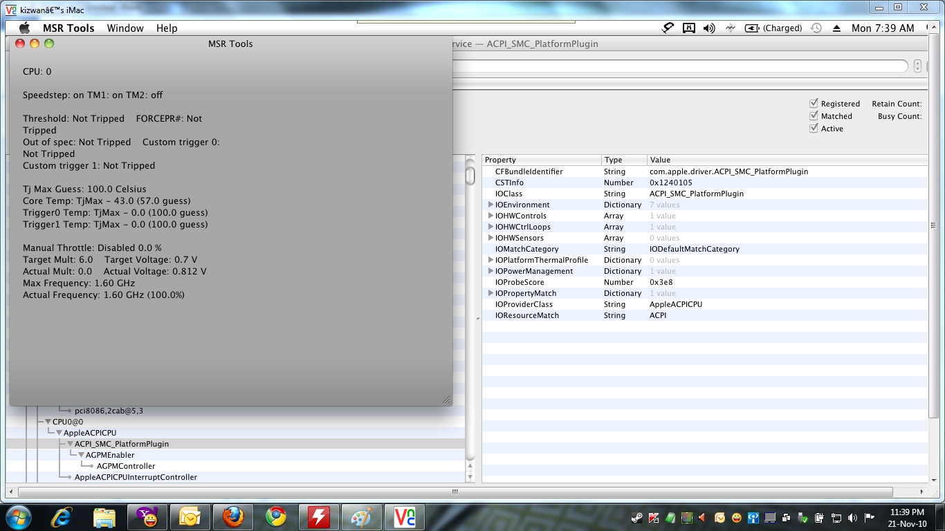

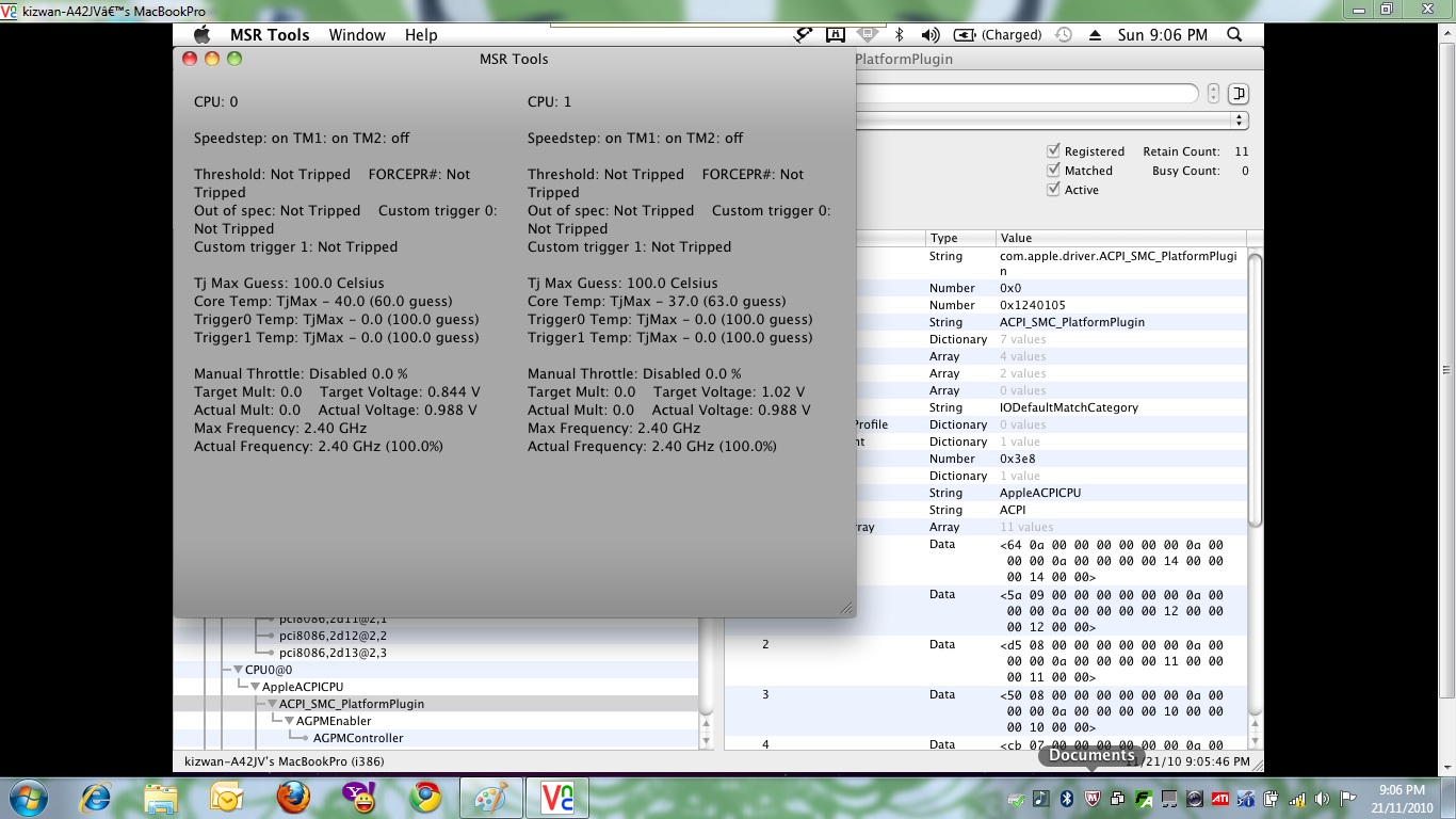

@valv,
Dell Studio:-
1) Without GeneratePStates:-
- Speedstep working
- Turbo Boost working
- PerformanceStateArray = 7
Studio1557_boot_8.txt
2) With GeneratePStates:-
- Speedstep not working
- Turbo Boost not working
- No PerformanceStateArray
Studio1557_boot_8_G.txt
Asus:-
- Speedstep working
- PerformanceStateArray = 11
Asus_Boot_8.txt
- Speedstep working
Asus_Boot_8_G.txt
I tried boot8 as well.
With EnableC6State and GeneratePStates being set to yes, almost the same behaviour. At first, it seems to work fine. Quicktime, Itunes, MSR Tools etc. But after a while, If I quit the apps and try to launch again, they get stuck.

Here are my questions:
- Should I change TjMax value in FakeSMC to 105? Does it make any difference.
- Under the load, temps are between 45-55C. I opened three HD movies in Quicktime and it seemed to manage well. But in idle, it doesn't seem to drop very much. Around ~44-48C. Can you share your values to compare with mine. I don't know what I should aim at. Are these normal?
- Sometimes, I lost C-States. I don't have CSTinfo=0x1240105 in IO. This is not something new. I had this while both using SSDT tables and letting OSX to pick those values up from bios, and it seems to happen with this method as well. Next restart brings it back.
So when I don't have CSTinfo=0x1240105 in IO, I have "Start up after a power failure option" appear in Energy Setting. Why is this happening.? However, I can't really say that when this happens, OSX is way running hotter.
- And finally, I don't need to use legacy ACPI_SMC_PlatformPlugin plugin, right? Can it make any difference?
Thanks Valv.
  1. regarding TjMax, you have to change it according to your cpu specs (intel's page)
  2. Temps depend on many things (how the case is manufactured; 64bit/32bit mode; voltage...). mine is around 40~45
  3. no idea why CSTInfo does disappear. Maybe u could add that key (only) to your legacy.
  4. I, myself don't use acpi_smc_pp anymore
