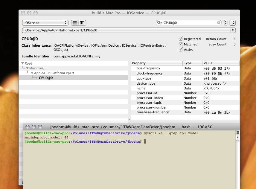

valv Posted June 27, 2010 Author Share Posted June 27, 2010 Processor in "About this Mac" says Unknown.would u mind typing this on a terminal:sysctl -a | grep cpu.model, and giving me the result. also, using IORegistryExplorer look at CPU0@0 and tell me what value is shoing at cpu-type item. Link to comment Share on other sites More sharing options...

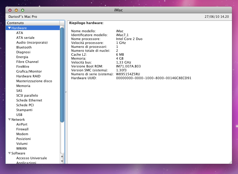

DariosF Posted June 27, 2010 Share Posted June 27, 2010 With beta3d----darwin 10.4.0=black screen legacy_kernel=show my cpu as 1 ghz instead 4.3 ghz. Link to comment Share on other sites More sharing options...

DariosF Posted June 27, 2010 Share Posted June 27, 2010 With beta3e----darwin 10.4.0=black screen legacy_kernel=show my cpu as 1 ghz instead 4.3 ghz. I've used busratio flag...HDAenabler kext doesn't works with this boot file. Link to comment Share on other sites More sharing options...

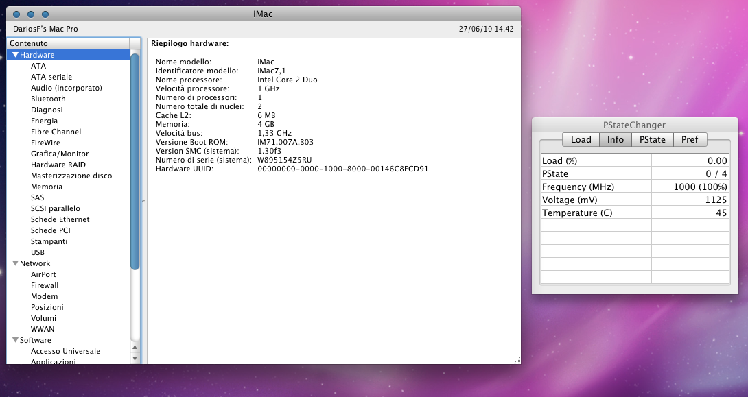

DariosF Posted June 27, 2010 Share Posted June 27, 2010 Now, with your keys, no black screen, but cpu is always at 3.33 ghz...Now hdaenabler works. Check my com.apple.boot.plist...bye com.apple.Boot.plist.zip Link to comment Share on other sites More sharing options...
valv Posted June 27, 2010 Author Share Posted June 27, 2010 @rednous, thank u very much for the feedback. one more thing, would u mind altering your busratio below 11, (something like 10, or 10.5) just to see if the key is actually taken in count or not? thanks again. Now, with your keys, no black screen, but cpu is always at 3.33 ghz...Now hdaenabler works. give it one more try by altering the busratio to 14 (333Mhz x 14 = 4.33Ghz) Link to comment Share on other sites More sharing options...
DariosF Posted June 27, 2010 Share Posted June 27, 2010 same problem also with 14. My real busratio is 10...so... Also time is still too fast. Link to comment Share on other sites More sharing options...

jboehm Posted June 27, 2010 Share Posted June 27, 2010 would u mind typing this on a terminal:sysctl -a | grep cpu.model, and giving me the result. also, using IORegistryExplorer look at CPU0@0 and tell me what value is shoing at cpu-type item. Attached was taken using beta3c Thanks, Jon Link to comment Share on other sites More sharing options...
