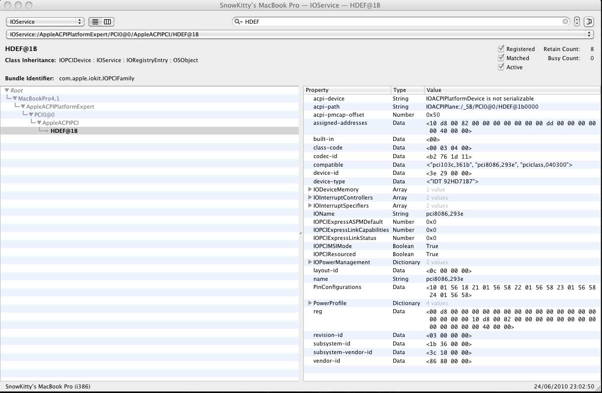

JBraddock Posted June 24, 2010 Share Posted June 24, 2010 Ok guys, I am not a DSDT geek but I would like to share DSDT patch for audio. As you may have read from my previous posts I am using vanilla AppleHDA.kext extracted from 10.6.2 as Apple removed support for some audio chipsets, including ours, from upcoming OSX versions. Update: Please see the following post for the updated code. Open your DSDT and search for Device (OVGA) and above this, paste the following code. I am not sure if there was a specific reason for me having put this code above Device (OVGA). Device (HDEF) { Name (_ADR, 0x001B0000) Method (_DSM, 4, NotSerialized) { Store (Package (0x04) { "layout-id", Buffer (0x04) { 0x0C, 0x00, 0x00, 0x00 }, "PinConfigurations", Buffer (Zero) {} }, Local0) DTGP (Arg0, Arg1, Arg2, Arg3, RefOf (Local0)) Return (Local0) } } Now, after applying this hack, please download this file: 92HD71B7X_AppleHDA_10.6.2 - Copy AppleHDA.kext to System/Library/Extensions. (This is the original/untouched version from 10.6.2) - Copy LegacyAppleHDA.kext to Extra folder. (Don't put it to S/L/E!) Notes: You must apply DTGP method to your DSDT first. Check out the first page. Pin configuration and other important information are included in LegacyAppleHDA.kext. LegacyAppleHDA.kext is not created by me. I don't remember where I got it. This hacks assumes that your audio controller's device id is as follows: 00:1b.0 Audio device [0403]: Intel Corporation 82801I (ICH9 Family) HD Audio Controller [8086:293e] (rev 03) (Please pay attention here: 00:1b.0 turns into 0x001B0000.) if you guys are able to use sleep, please could you test this solution and report back if it is still working after the wake. Link to comment Share on other sites More sharing options...
JBraddock Posted June 24, 2010 Share Posted June 24, 2010 Guys, I think with the above code, the audio is not going to work after sleep. I did a little bit of research and tweaked my code accordingly. I'll share it tomorrow. So I reserved this place Update I Yes, it is sleeping but lazy {censored} doesn't wake up with the power button. If I hold the power button and turn the HDX off and restart again, after the Chameleon menu it says something about wake kernel and then there I have my desktop I can't call it a complete success but it is something I guess. PS: Audio is working after 'sleep'. // Update II So I downloaded a DSDT file from this post. When I compared the HDEF fix applied to that DSDT with mine, I noticed that there are some codes missing in my HDEF device. So the tweaked code will be like this. Open your DSDT file and search for _L0D and add Notify (\_SB.PWRB, 0x02) to this code. You'll end up like this. Method (_L0D, 0, NotSerialized) { Notify (\_SB.PCI0.HDEF, 0x02) Notify (\_SB.PWRB, 0x02) } Now, search for Device (OVGA) and paste the code below right above Device (OVGA). Device (HDEF) { Name (_ADR, 0x001B0000) Method (_PRW, 0, NotSerialized) { Return (Package (0x02) { 0x0D, 0x05 }) } Method (_DSM, 4, NotSerialized) { Store (Package (0x0A) { "built-in", Buffer (One) { 0x00 }, "codec-id", Buffer (0x04) { 0xB2, 0x76, 0x1D, 0x11 }, "layout-id", Buffer (0x04) { 0x0C, 0x00, 0x00, 0x00 }, "device-type", Buffer (0x10) { "IDT 92HD71B7" }, "PinConfigurations", Buffer (Zero) {} }, Local0) DTGP (Arg0, Arg1, Arg2, Arg3, RefOf (Local0)) Return (Local0) } } Please find the necessary kext files and instruction in my previous post. If you are wonder here is the audio detail of HDX that I dumped for a while ago. Detailed one is here. Terminal_Saved_Output.txt Probing codec #0... HDA Codec #0: IDT 92HD71B7 HDA Codec ID: 0x111d76b2 Vendor: 0x111d Device: 0x76b2 Revision: 0x03 Stepping: 0x02 PCI Subvendor: 0x361b103c Please notice that "HDA Codec ID: 0x111d76b2" becomes 0xB2, 0x76, 0x1D, 0x11. Here is the output. I already mentioned my sleep experience above. I don't know if this solution is still going to work if I've fixed the wake up with the power button. But now, it seems to work. Please let me know if this works for you. Link to comment Share on other sites More sharing options...
manmal Posted June 27, 2010 Share Posted June 27, 2010 hi JBradock, thanks for your help. With your dsdt modifications & applehda.kext+legacyapplehda.kext audio does not work after sleep here in my hdx18. If i understood correctly, i should use dsdt modifications for L0D and for HDEF like in your last post removing the HDEF modifications in previous post you wrote, correct ? Mal Link to comment Share on other sites More sharing options...

hdx18 Posted June 29, 2010 Share Posted June 29, 2010 hmm ... here audio does not work at all after resuming from sleep. And i am following the exact configuration/dsdt mods as you suggest ; IORegistryExplorer shows me the exact values as yours! Really strange you have audio after resuming from sleep and me not. I am using anval latest bootloader (not beta one, 06/04/10 one) Me neither... And, like you, I tried the exact same configuration... I still can't resume from sleep! ...And we are always waiting for valv for his speedstep guide through correct acpi tables for hdx18 using anval bootloader :P Link to comment Share on other sites More sharing options...

manmal Posted June 29, 2010 Share Posted June 29, 2010 Hi jbraddock, Your system has not sleep & resume working properly(dunno why). What you are talking about is resume from hibernate. It's a different thing. the computer powers off then on again. I can confirm that audio is not working using applehda after *Proper resuming from sleep. if anyone find a solution please let us know. Thanks! mal Just to make sure that we're talking about the same thing when we say "resuming sleep". - My HDX 16 sleeps well. - He doesn't wake up with the power button - When I press the power button, I see a black screen and he gets frozen. - I hold the power button and turn him off. - I turn him on again and after Chameleon menu, it says something about wake kernel and there I have my desktop and yes, audio is working. So the question for me is that whether it's still going to work after fixing the waking up with the power button. So the time will tell. Regarding the bootloader versions, I tried RC4 and AnVal bootloaders (beta3b and beta3c). I am using beta3c right now. (The steps above are working with these bootloaders) I tried the latest version (beta4b) and it broke my resuming sleep. It just starts the OSX but not resume sleep. It is working with the latest version as well. You just have to update your boot.plist according to Valv's and set hibernate mode to 3 with this command: sudo pmset -a hibernatemode 3. Don't forget to uncheck "secure virtual memory" under System Preferences > Security. Link to comment Share on other sites More sharing options...
