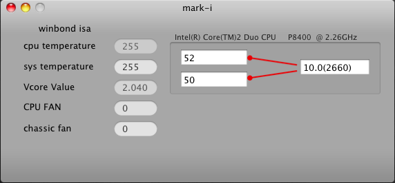

JBraddock Posted January 5, 2011 Share Posted January 5, 2011 How should one read the following screenshot? It floats only between 8.5 and 10. Rarely I saw 1.5ghz. Is it same with you as well? Link to comment Share on other sites More sharing options...

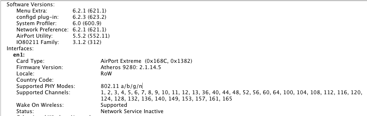

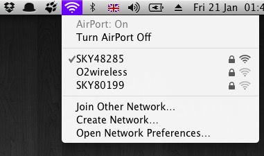

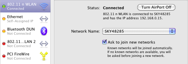

JBraddock Posted January 20, 2011 Share Posted January 20, 2011 OMG! I knew it would work I was right in my assumption. It worked without a bios hack. Bare in mind that the wifi card I am using right now has an HP subsystem id. Previously, I tried the same card with a Toshiba subsystem id but it was failed to pass the bios. Things I noticed. - Locale and Country Code is misconfigured. I need to check Andy's hack to see if I can override those values. - I can't use Airport Utility or Menu Bar icon to connect to the network. They are unable to find available networks. However, menu bar icon shows the current situation of the network connected. - I can only connect to a wifi network from Network Preferences in System Preferences. - I didn't tape the pin 20. As of now, it seems to work. I did a restart to see if it would turn the wifi on and it did. I'll test this further. - I am running OS X 10.6.6 in 32 Bit. I don't know if it will work in 64 Bit but System Profiler > Extensions shows that the loaded driver does support 64 Bit. - Locale : RoW means "Rest of the world" I'll do more test and let you know if it really works without any problem. God, I am so happy right now Edit: After renaming the network device to AirPort and restarting the OSX, I got country code set to GB. I'll see if it changes later again. It refuses to auto connect to the network. But it remembers the password and I can manually connect to the network. So it seems that I need to find out why the Airport Utility is not working. I bet it is something to do with the sub system id and I need to add my subsystem id to somewhere in the Atheros kext. We'll see. Taping the pin 20 seems to be not needed. Edit: Auto connect issue persists after waking up from sleep. But at least the wifi card doesn't seem to turn itself off after sleep. Once I find a way of enabling the use of Airport Utility, I'll bet this issue will also be gone. Edit: I solved the no-wifi-after sleep issue and also now the menu bar icon shows wifi networks Apparently, all I needed to do is to create a new Airport device (Will be named AirPort 2) in Network Preferences then choose Assist, which took me through to connect to a network. After that I deleted the previous AirPort device and then rename the recently created one to AirPort. Now the airport utility in the menu bar shows all connections and connects to the network automatically But, Airport Utility app still can't find the wifi card, which by the way I don't care as long as it works this way. Finger Crossed! Software Versions: Menu Extra: 6.2.1 (621.1) configd plug-in: 6.2.3 (623.2) System Profiler: 6.0 (600.9) Network Preference: 6.2.1 (621.1) AirPort Utility: 5.5.2 (552.11) IO80211 Family: 3.1.2 (312) Interfaces: en1: Card Type: AirPort Extreme (0x168C, 0x1382) Firmware Version: Atheros 9280: 2.1.14.5 Locale: RoW Country Code: GB Supported PHY Modes: 802.11 a/b/g/n Supported Channels: 1, 2, 3, 4, 5, 6, 7, 8, 9, 10, 11, 12, 13, 36, 40, 44, 48, 52, 56, 60, 64, 100, 104, 108, 112, 116, 120, 124, 128, 132, 136, 140 Wake On Wireless: Supported [b]Status: Connected[/b] Link to comment Share on other sites More sharing options...
