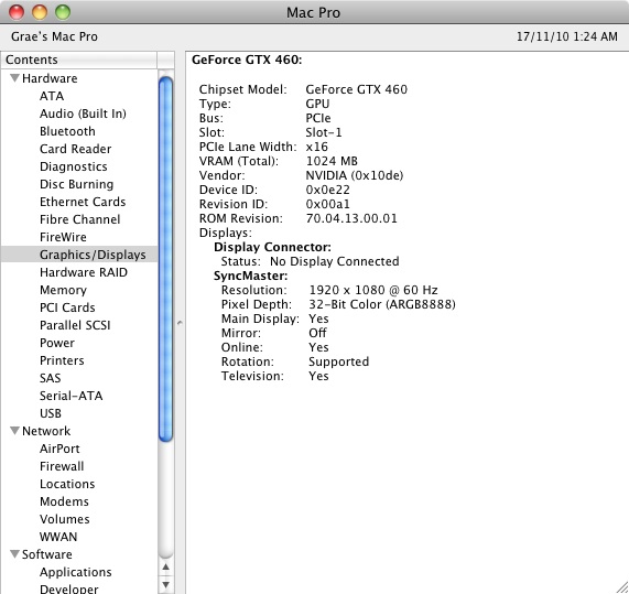

Graebags Posted November 16, 2010 Share Posted November 16, 2010 QUADRO MAC OS X DRIVER RELEASE 256 include NVDAGF100Hal.kext. device id that NVDAGF100Hal.kext support is blow. GeForce GTX 580(GF110) is supported!! 0x06c010de // GeForce GTX 480 0x0dc010de 0x0e2010de 0x0ee010de 0x0f0010de 0x104010de 0x108010de // GeForce GTX 580 YES! YES! YES! GTX460 works! with quartz! Yes guys, GTX460 is supported too! Link to comment Share on other sites More sharing options...

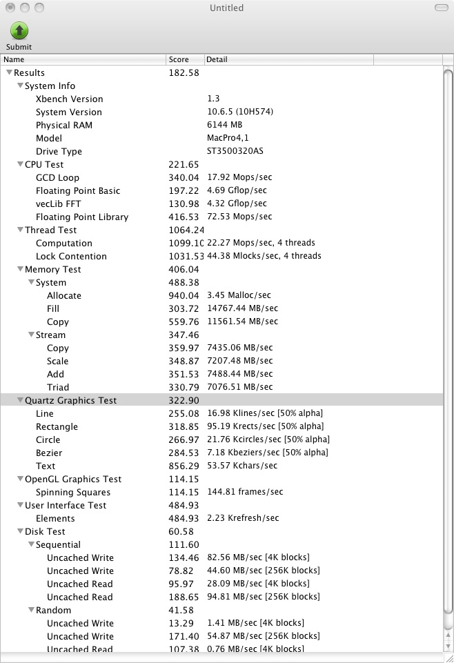

Diwad Posted November 16, 2010 Share Posted November 16, 2010 First openGL tests...why opengl 3 isnt tested? Link to comment Share on other sites More sharing options...

Graebags Posted November 16, 2010 Share Posted November 16, 2010 Any idea of the id for the GTX460 ? anyone? Edit: gtx460 – 0×0e22 (Cinebench 25.21) Link to comment Share on other sites More sharing options...
