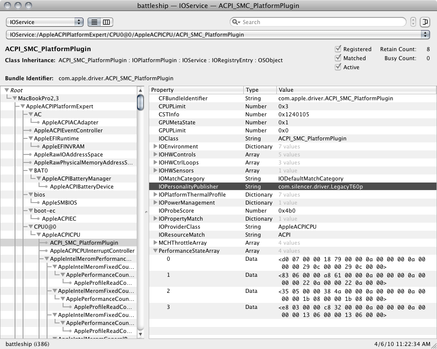

BrendenM Posted April 6, 2010 Share Posted April 6, 2010 It did end up being something wrong with my cache, pfix fixed that and I seem to have SpeedStepping (sp?) working, though I don't know if it's better then what I have with VoodooPowerMini or not. I am curious about one thing. I have the x1700/v5250 card in my T60p so to get it to work I not only have to modify ATIRadeonX1000.kext's Info.plist but also the binary too. I am able to be QE/CI working by doing this and then using either ATIinject.kext or EFI strings in com.apple.Boot. I do not have ATINDRV.kext anywhere on my system and stuff is working find including sleep but you said that it was needed. What benefit would ATINDRV.kext provide me? Link to comment Share on other sites More sharing options...
Silencers Posted April 6, 2010 Author Share Posted April 6, 2010 It did end up being something wrong with my cache, pfix fixed that and I seem to have SpeedStepping (sp?) working, though I don't know if it's better then what I have with VoodooPowerMini or not. Refer to my guide to see how to check if you have C-states enabled. If you do - it is better than VoodooPower, because CPU will eat less power with C-states. I am curious about one thing. I have the x1700/v5250 card in my T60p so to get it to work I not only have to modify ATIRadeonX1000.kext's Info.plist but also the binary too. I am able to be QE/CI working by doing this and then using either ATIinject.kext or EFI strings in com.apple.Boot. I do not have ATINDRV.kext anywhere on my system and stuff is working find including sleep but you said that it was needed. What benefit would ATINDRV.kext provide me? I don't think that ATINDRV will give anything to you, it is an old version of ATI framebuffer, you probably have working new one without any problems. Can you share with me the information regarding your binary patch, I would like to try this with X1600 to see if I can get rid of ATINDRV. Link to comment Share on other sites More sharing options...
BrendenM Posted April 6, 2010 Share Posted April 6, 2010 Refer to my guide to see how to check if you have C-states enabled. If you do - it is better than VoodooPower, because CPU will eat less power with C-states. Okay I do not match your guide completely, you mentioned that I should be showing 5 values in PerformanceStateArray, I'm only showing 4, I also now have the CPULimit entry but it's value is 0x3. Picture Attached. Hmmmm I don't think that ATINDRV will give anything to you, it is an old version of ATI framebuffer, you probably have working new one without any problems. Can you share with me the information regarding your binary patch, I would like to try this with X1600 to see if I can get rid of ATINDRV. Sure here is my quick writeup I did on it. http://www.projectosx.com/forum/index.php?showtopic=650 Basically my card's ids weren't known by the driver's binary at all. I had to search for another version 71de (don't remember which card this was) and replace it with 71d4 (My card). I found this mentioned somewhere else but it was for versions prior to 10.6 so I wrote up what I found. Ahhh all the little pieces to fix, just realized I've lost my Ultrabay DVD Burner support, hmmmmmmmmm. :-D ah well, I find this somewhat enjoyable, well only if I'm seeing some progress, if I'm not getting anywhere I want to bring out the baseball bat. Link to comment Share on other sites More sharing options...
