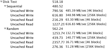

BarboneNet Posted March 2, 2010 Share Posted March 2, 2010 The 2640x4 came in this morning. I am currently Initializing the RAID 5 array, but here is the Xbench in RAID 0. RAID 0: 4 x 250GB Seagate Momentus 7200.4: This is more in line with what I was expecting performance wise. Ideally, I need a solution that will sequentially write as fast as the Intel SSD can read. In RAID0, the 2640x4 provides that. RAID 5: 4 x 250GB Seagate Momentus 7200.4: I am little concerned about the random read/write performance as this drive is only data. I love how fast the RAID0 was, but with 4 drives I am a bit concerned about a disk failure. I would have to make periodic backups to my Drobo either way. I will stick with the 5 now and see how it works for my workload. The RAID5 array nearly writes as fast as the Intel SSD (280MB/s) can read: I have had two kernel panics though. One while running XBench on the drive and the other while attempting to copy a 120GB Aperture Library to the drive. I will continue to monitor the set up for stability. But as far as speed is concerned, the RocketRAID 2640x4 is obviously much better than the RocketRAID 2300 yeah....now raid works fine;) how much cost this controller??? Link to comment https://www.insanelymac.com/forum/topic/211529-raid-5-setup-questions/page/2/#findComment-1421233 Share on other sites More sharing options...

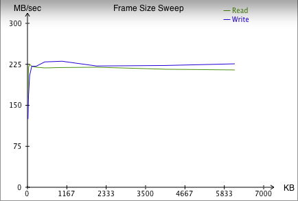

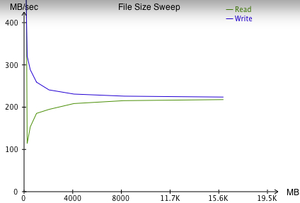

Narayana Posted March 5, 2010 Author Share Posted March 5, 2010 I bought the 1210. I'll give AJA a try, but first I need to get OrCAD installed and do some work. Aperture runs nicely off the RAID volume. My new scans will reside on the RAID volume before being imported...which will be much nicer than the Drobo (which freaks out when trying to preview large tifs). EDIT: If only I bought the Areca and used AJA when you first suggested, BarboneNet, I would have saved myself time. The sequential transfer rates top out at a bit less than 225MB/s for read and writes...which is a bit lower This might be a bit slower than the RocketRAID 2640x4 (which was able to get 20-30MB/s more on reads transferring a large h264 file). The <64K block size performance is light years ahead of the RocketRAID, though, and the performance is pretty flat over block/file size. And unlike the RR, this card works beautifully in both OS X and Win 7. I wish I built a RAID0 and played around with it for a while...maybe another day. Link to comment https://www.insanelymac.com/forum/topic/211529-raid-5-setup-questions/page/2/#findComment-1423339 Share on other sites More sharing options...
