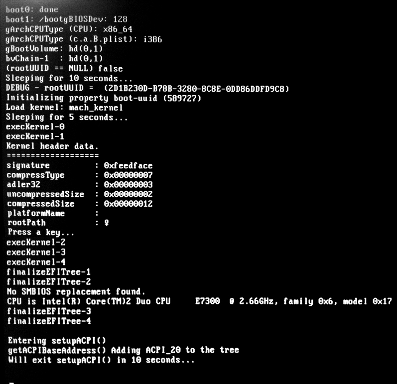

This is where DUMP_ADDRESS comes in place (acpi_patcher.c). Set it to 1 and it should show you your address. Set it to 0 afterwards. A one time only event (per configuration).
I got that earlier, but I still wasn't sure where exactly to add it in acpi_patcher.c. Would it be after static uint32_t const DSDT_TABLE_SIGNATURE = ?
I guess this doesn't matter now? (see next item)
I would like to advise you to stick with the files as they are now, with the latest changes making us no longer drop SSDT tables.
That's fine with me. So I'll stick with your master files without going along with the additional acpi_patcher.h and acpi.h as suggested by dsgsa ?
I now also changed fake_efi.c a little:
I'll have a look.
EDIT:
After making the fake_efi.c changes I now get the following verbose output after the kernel header details boot:
finalizeEFITree-1
finalizeEFITree-2
No SMBIOS replacement found.
CPU is Intel(R)... blah
finalizeEFITree-3
finalizeEFITree-4
loadACPITable(DSDT.AML)
I've still got DUMP ADDRESS enabled so I then see the baseAddress: output. - now disabled.
I then have to press a key before I see a garbled screen.
oh.. and for info, the above output includes the changes to DROP_SSDT_TABLES in patcher.h
EDIT 2:
Trying to narrow down where exactly the code fails in function setupACPI
I know the code gets past:
	rsdp = getACPIBaseAddress();
rsdp_mod = (struct acpi_2_rsdp *) AllocateKernelMemory(rsdp->Length); // 36 / 0x24
but it never makes it past:
	memcpy(rsdp_mod, rsdp, rsdp->Length);
Or the printf statements I put after these lines don't get executed as this is the point I see the multicoloured blocks and garbled screen.

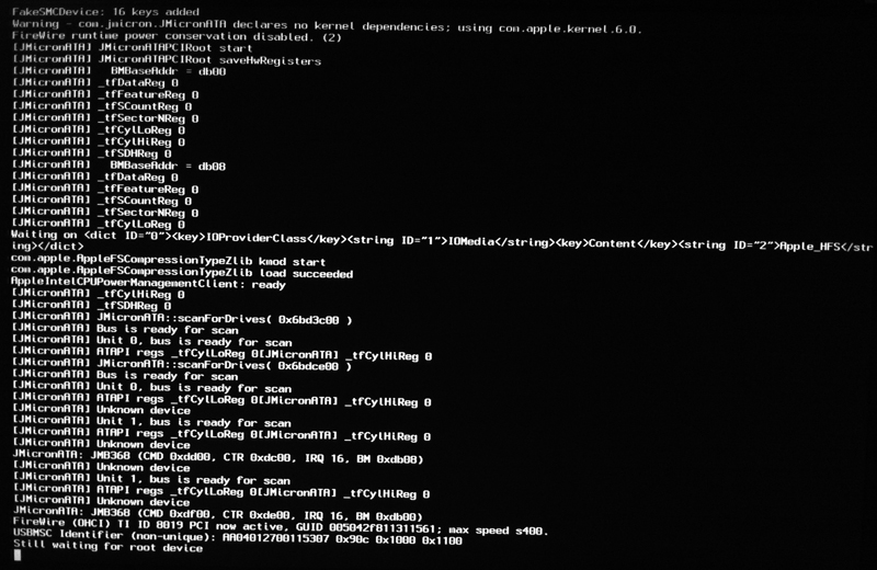

Kernel starts :)
But only gets as far as USBMSC identifier, then sits at waiting for root device.
EDIT2:

Question:
Where is the rootUUID coming from?
EDIT:
Just added this to fake_efi.c
bool setRootUUID(Node *chosenNode, char *rootUUID)
printf("DEBUG - rootUUID =  (%d)\n", rootUUID);	// blackosx added.
sleep(5);   // blackosx added
// Only accept a UUID with the correct length.
if (strlen(rootUUID) == 36)
and I see the following which is not 36 characters in length.
DEBUG - rootUUID = 589727
Does this help?
Can you please add the following two lines:
	DEBUG_DUMP("(rootUUID == NULL) %s\n", (rootUUID == NULL) ? "true" : "false");
DEBUG_DUMP_SLEEP(10);
Right above the call to initEFITree(rootUUID) and enable debug output.
I see:
(rootUUID == NULL) false
I have to go visit family now. Will be back after lunch...
No problem. I'll catch up later :P
rootUUID is a string which can be dumped with: %s (not %d). And yes doing this helps.
Thanks for the correction, and yep this results in
DEBUG - rootUUID = ()
p.s. You can set it in the usual way in com.apple.Boot.plist but that would basically defeat the whole purpose of this exercise / new feature.
Just to test this out, I can confirm that I can successfully boot my system by adding
rd=uuid boot-uuid=00000000-0000-0000-0000-00000000000000
in to kernel flags in my c.a.B.p.
Where the UUID value is that of my OSX partition as shown in disk utility.
Screenshot of the Revolution debug info from the settings I have
and I see the following in the verbose kernel log.
rooting via boot-uuid from /chosen: <rootUUID>
So it just confirms, along with the other debug output, that the auto detection of my UUID is failing.
