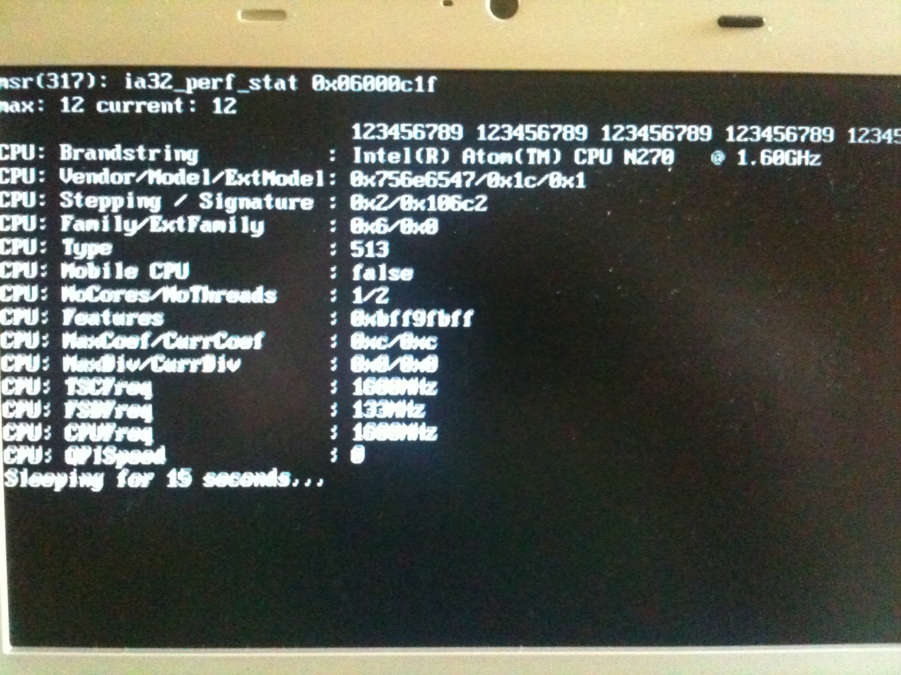

DB1 Posted February 10, 2011 Share Posted February 10, 2011 As long as it works. And without your changes it doesn't work for your Atom? Yeah works sweet for me. The adjustments allow about this mac and hardware overview show core solo rather than core 2 which I've not had yet. One odd thing i've noticed is in Platform.c section of private_data.h is if I set to static smbios the ram settings I have set there dont show in system profiler, but if i do dynamic they do is this whats expected? Link to comment Share on other sites More sharing options...

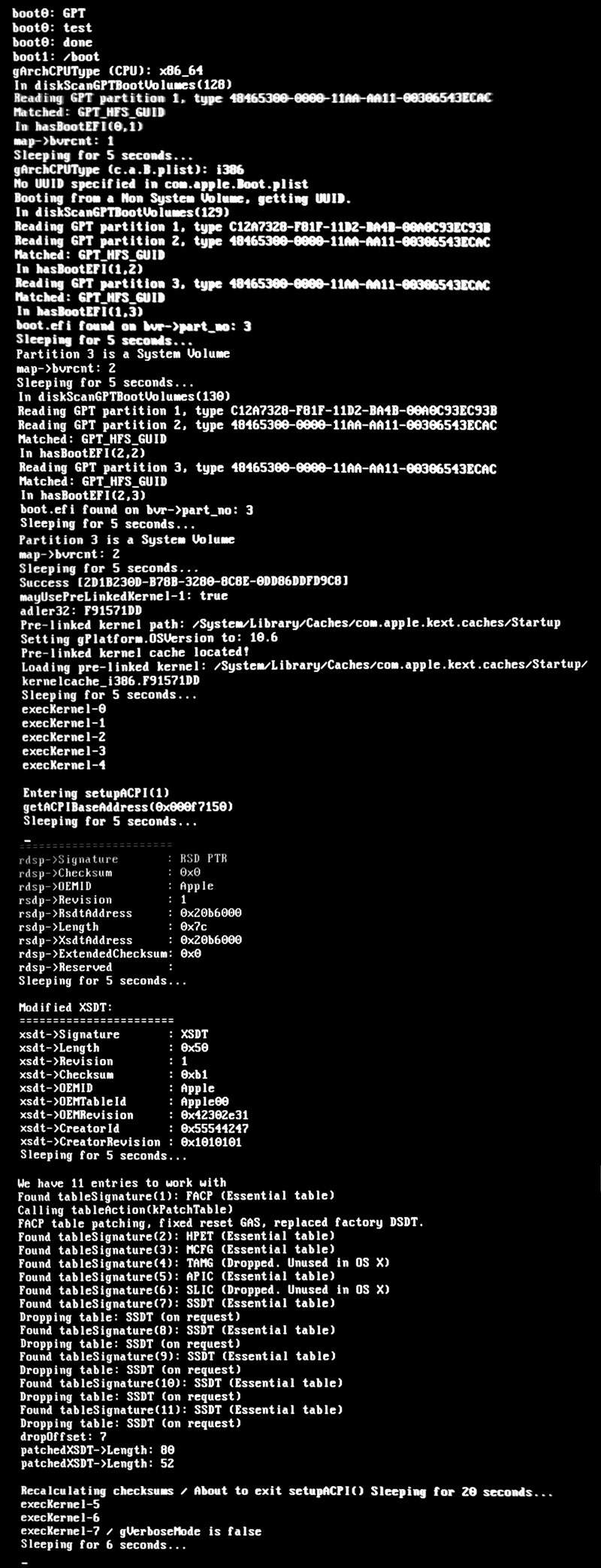

blackosx Posted February 10, 2011 Share Posted February 10, 2011 Hmm. You have three calls to diskScanGPTBootVolumes. Should be two only. I think three is correct. diskScanGPTBootVolumes(128) is for my HFS+ partition on the USB flash drive. diskScanGPTBootVolumes(129) is for my EFI, HFS+, HFS+ partitions on HDD 1. diskScanGPTBootVolumes(130) is for my EFI, HFS+, HFS+ partitions on HDD 2. Can be anything of course... Yeah I know, but i still can't work it out. Booting from HDD is nice an quick, but I can't seem to get my USB booting quickly.. I've tried my previous boot file before the experimental version, re-copied Extensions.mkext, pre-linked kernel, c.a.B.p, double checked ownership/permissions, and it's still slow, I'm missing something obvious but I'm tired so I'll retry it tomorrow. Bed time for me as I have to be at work early tomorrow. Keep up the good work everybody Link to comment Share on other sites More sharing options...

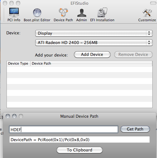

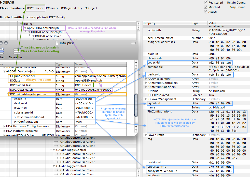

scrax Posted February 10, 2011 Share Posted February 10, 2011 But EFI studio does not seem to grab correct info for HDEF (as in the info it generates is not same as I see in IORegExp). OK I should just go test, I guess... I've made this screenshot to try to explain what I did to move the HDEF Method _DSM from DSDT into a Legacy kext (after the EFI way I found more interesting this one so now all the audio patch is done with a dummy kext). The ioreg is saved with HDEF working with DSDT inj. The blue value are the one we want to merge to ioreg with the legacy kext or EFI string. Making an EFI string is easiest because you only need the name of the device were you want to put the data ES. Device (HDEF) and then you can use EFIStudio to get the PCI path SO to have it in a EFI string format only the IOProviderMergeProprieties Dictionary is needed but you need to change the name to the HDEF PCI path For mine: PciRoot(0x1)/Pci(0x8,0x0) instead of IOProviderMergeProprieties in the default EFI plist (After many test I can't use the DeviceMergeNub method with GFX and SATA so they are still in a EFI format) Link to comment Share on other sites More sharing options...
humph Posted February 11, 2011 Share Posted February 11, 2011 Making an EFI string is easiest because you only need the name of the device were you want to put the data ES... Scrax, thank you for the info. Well it got my brain sorted. And thank you to DHP for earlier encouragement. I've now got EFI DP for GFX, HDEF and ARPT(WiFi) - all the DSM's in my DSDT. My mistake was that of just adding the "additional" hex numbers to the end of the existing DP table. Soon as I remade the new table from a new .plist with all relevant devices and used those numbers, it all worked. BTW, it'd be nice if Revolution could handle just a long string of EFI DP numbers (or have a little converter app) as it took ages and imminent RSI to reformat the long numbers into 0xAA, 0xBB etc for inclusion in private_data.h! Also, I made slight edit to aml2struct.pl to add the "\" at end of lines for DSDT conversion: if (($index % 32) == 0) { $str .= "\\\n\t"; } EDIT: Here's the complete file...aml2struct_mod.pl.zip Link to comment Share on other sites More sharing options...

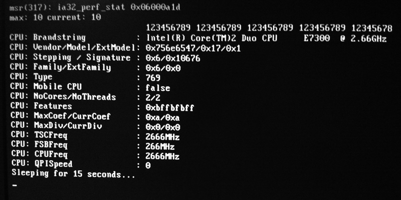

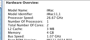

DB1 Posted February 12, 2011 Share Posted February 12, 2011 I said to be working on this... and so I did. Attached is a proper fix for CPU speed/detection. Please give it a try. Thanks. You see; two downloads already. Thanks Works ok for me, cpu reporting correctly in about this mac, and system profiler, can set macbook4.1 or macbookpro6.1. only minor issue is if I do dynamic cpu & smbios I get mac mini 2.1 & core 2 solo but memory (apart from size) comes through as is set in private_data.h, if I do static everything ok except one memory module does not report manufacturer, part no, and serial no. Not overly concerned. My ram always shows in about this mac 2Gb (2 x1Gb) which is correct but in system profiler/memory it is 32mb and always ever has been with Chameleon or Revolution. It's no big deal but for completeness if you can capture memory size why not. I tried adding #define STATIC_RAM_SIZE SMB_MEM_SIZE_1GB in private_data.h and //============================================================================== static int getRAMSize(void) { return STATIC_RAM_SIZE; } in smbios/dynamic_data.h but got the old first use error on compile - don't really know what i'm doing but i thought worth a try. Overall though I'm 10 seconds faster than Chameleon on my EFI partition spare hdd set up so the work you done so far great stuff, thanks for your hard work. Another advantage i've seen over Chameleon is at wake after sleep, I used to have erratic mouse or trackpad activity until the wifi reconnected uo to about 30 seconds to a minute, Revolution connects within 5 seconds with no erratic mouse / trackpad {censored}. Have hacked away further at my dsdt (now 8kb) to get rid of the DSM stuff and have managed to make a hex file so working toward making some more improvements, a few more seconds off maybe! Catch up tomorrow, great work DHP. Link to comment Share on other sites More sharing options...

blackosx Posted February 12, 2011 Share Posted February 12, 2011 I said to be working on this... and so I did. Attached is a proper fix for CPU speed/detection. Please give it a try. Hi dutchhockeypro Sorry I wasn't around much to test yesterday, but I have caught up here now. I've taken the three revised files you posted, made the fix to function getCPUtype, and added the declarations for CPU_VENDOR... as DB1 posted which allowed me to successfully compile. Booting using my static data works fine, but I thought I'd test using dynamic CPU and SMBIOS data as this is what's changed. When using the dynamic CPU, the debug info show during boot is correct and is what I have been using for my static data. and is what I see once booted and type sysctl -a | grep cpu hw.ncpu = 2 hw.cpufrequency = 898196224 hw.availcpu = 2 hw.ncpu: 2 hw.activecpu: 2 hw.physicalcpu: 2 hw.physicalcpu_max: 2 hw.logicalcpu: 2 hw.logicalcpu_max: 2 hw.cputype: 7 hw.cpusubtype: 4 hw.cpu64bit_capable: 1 hw.cpufamily: 2028621756 hw.cpufrequency: 26668000000 hw.cpufrequency_min: 26668000000 hw.cpufrequency_max: 26668000000 machdep.cpu.max_basic: 10 machdep.cpu.max_ext: 2147483656 machdep.cpu.vendor: GenuineIntel machdep.cpu.brand_string: Intel® Core(tm)2 Duo CPU E7300 @ 2.66GHz machdep.cpu.family: 6 machdep.cpu.model: 23 machdep.cpu.extmodel: 1 machdep.cpu.extfamily: 0 machdep.cpu.stepping: 6 machdep.cpu.feature_bits: 3219913727 582557 machdep.cpu.extfeature_bits: 537921536 1 machdep.cpu.signature: 67190 machdep.cpu.brand: 0 machdep.cpu.features: FPU VME DE PSE TSC MSR PAE MCE CX8 APIC SEP MTRR PGE MCA CMOV PAT PSE36 CLFSH DS ACPI MMX FXSR SSE SSE2 SS HTT TM SSE3 MON DSCPL EST TM2 SSSE3 CX16 TPR PDCM SSE4.1 machdep.cpu.extfeatures: SYSCALL XD EM64T LAHF machdep.cpu.logical_per_package: 2 machdep.cpu.cores_per_package: 2 machdep.cpu.microcode_version: 1548 machdep.cpu.mwait.linesize_min: 64 machdep.cpu.mwait.linesize_max: 64 machdep.cpu.mwait.extensions: 3 machdep.cpu.mwait.sub_Cstates: 139808 machdep.cpu.thermal.sensor: 1 machdep.cpu.thermal.dynamic_acceleration: 0 machdep.cpu.thermal.invariant_APIC_timer: 0 machdep.cpu.thermal.thresholds: 2 machdep.cpu.thermal.ACNT_MCNT: 1 machdep.cpu.arch_perf.version: 2 machdep.cpu.arch_perf.number: 2 machdep.cpu.arch_perf.width: 40 machdep.cpu.arch_perf.events_number: 7 machdep.cpu.arch_perf.events: 0 machdep.cpu.arch_perf.fixed_number: 3 machdep.cpu.arch_perf.fixed_width: 40 machdep.cpu.cache.linesize: 64 machdep.cpu.cache.L2_associativity: 6 machdep.cpu.cache.size: 3072 machdep.cpu.tlb.inst.small: 128 machdep.cpu.tlb.inst.large: 8 machdep.cpu.tlb.data.small: 16 machdep.cpu.tlb.data.small_level1: 256 machdep.cpu.tlb.data.large: 16 machdep.cpu.tlb.data.large_level1: 32 machdep.cpu.address_bits.physical: 36 machdep.cpu.address_bits.virtual: 48 machdep.cpu.core_count: 2 machdep.cpu.thread_count: 2 However, System Profiler shows and About This Mac shows: Have I forgotten to make any changes at my end, or is this an issue with the code? p.s. I'll be working for most of today, so I'll check in when I can. Link to comment Share on other sites More sharing options...
DB1 Posted February 12, 2011 Share Posted February 12, 2011 Hi DB1, Seem like your Atom isn't recognized as Mobile CPU. Now the big question is if this was working for you previously. I may have to change something for this to work properly. What brand string do you get with DEBUG_CPU enabled? Ah yes. This static memory detection bug was something I planned to fix for this release. Let me give it a try. SMB_MEM_SIZE_1GB should show up as undefined. I'll also check if we can add memory size. Would be cool. Yes. This can be done, but we will have to figure out what values to use. The SMBIOS specification only talks about: 0x0000 for when no module is installed, 0x8100 for a 256 KB module and 0x100h for a 256 MB module. Oh and 0xffff for when the size is unknown. FIXED Verified to work with fake values for: 1, 2, 4, 8 and 16 GB modules (32 GB not working on the HP). Good to hear that. And I've said this before but I do it once again; We will toggle the load switch in the upcoming release (6.43) and you got to see a jump start from USB-stick and SD cards, as it will improve the load factor by 10-35. Wow. So I wasn't dreaming – my keyboard was non-responsive (with Chameleon) the first couple of seconds. The smaller the file the better. Static DSDT injection is even better. p.s. Do you have a BIOS setting to enable C4? If yes then please attach a CPU debug dump with C4 enabled and disabled. Otherwise one will do. Need to know what this: msr(n): platform_info shows. Can't do anything without this info. Hi DHP, you're right cpu not recognised as mobile here's the debug. Brand string looks ok to me. Good you fixed the memory size, expect will be in next release. Look forward to the speed leap on the SD/USB mine seems to lag quite a bit. I have static dsdt alreaady, just playing now with device properties efi to take out DSM's. Dont have a C4 setting, the MSI Wind/Advent 4211 has a very, very, very basic bios. there is an msr output on the cpu debug, not sure if thats what your looking for. Link to comment Share on other sites More sharing options...
blackosx Posted February 12, 2011 Share Posted February 12, 2011 Hi DHP Just to recap: booting using my static data works great with these new updates you've released, I was just questioning the results of experimenting with dynamic data. Anyway. Im post #924 I said: "When your CPU speed is displayed wrong with this change, then you need to adjust the (static) values in private_data.h" so yes you need to update your static data accordantly. This is what I am using for the HP: #define STATIC_CPU_TSCFrequency 2266000000ULL #define STATIC_CPU_FSBFrequency 133300000ULL #define STATIC_CPU_CPUFrequency 2266000000ULL A bit shorter so to speak. I'm sure you get it sorted. I don't understand.. Why do I need to change my static CPU data to correct the result of the dynamic CPU setting? And dynamic data appears to be a factor 10 of what it should be. I'll look into it before releasing a new update. Thanks! FIXED With the new files in post #945, using the dynamic CPU setting, System Profiler still shows my Processor Speed as 26.67 GHz as reported in post #942 Link to comment Share on other sites More sharing options...
