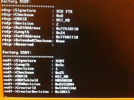

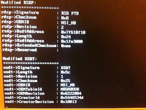

DB1 Posted January 6, 2011 Share Posted January 6, 2011 Hi DB1, May I ask how did you collect this info? Also. Your dump tells me that your system is ACPI 3.0 compliant. Why? Because under "Factory RSDP:" I see this rsdp->Revision: 2 and your RSDP signature is XSDT instead of RSDT (for ACPI 1.0). Please compile Revolution with ACPI_10_SUPPORT set to 0 and attach the same kind of dump. Thank you. I video then typed up, it was set at 1 and then I tried 0 but did notice any significant changes and had not re video to check. Re ACPI 3.0 blackosx pointed us at that a couple of days back but I was not convinced as previous ACPI dumps and extracted dsdt stated ACPI 1.0. A bit bizarre to say the least. attached my updated debug: DubugOutput.txt Off to work now may catch up this evening. Link to comment Share on other sites More sharing options...

DB1 Posted January 6, 2011 Share Posted January 6, 2011 may be related to his CPU Wasn't that some Atom type? So tell me. Are you using dynamic or static CPU/SMBIOS data? Just to be sure: What is the problem at this moment? HPET related KP? Gentlemen: The files in this attachment aren't thoroughly tested, but it is mostly a matter of moving the new code into macro's. There's one new file called debug.h where all debug related stuff went to. Both are set dynamic and when I dubug cpu it finds and details it ok. I only raised the HPET thing because I notice others debugs had it in. I get grey screen, apple no throbber after the debug finishes. I get a compile error with the new files. In file included from acpi/patcher.h:10, from acpi_patcher.c:94: acpi/debug.h:89:37: error: macro parameters must be comma-separated In file included from acpi_patcher.c:94: acpi/patcher.h: In function ‘setupACPI’: acpi/patcher.h:180: warning: unused variable ‘tableName’ acpi/patcher.h:335: warning: implicit declaration of function ‘_ACPI_DEBUG_DUMP_SLEEP’ make[2]: *** [acpi_patcher.o] Error 1 make[1]: *** [all] Error 2 make: *** [all] Error 2 Link to comment Share on other sites More sharing options...

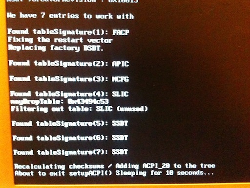

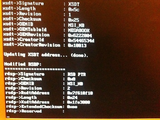

dgsga Posted January 6, 2011 Share Posted January 6, 2011 I've just tested the latest acpi changes (acpi634 v3 plus patch) on my acpi 2.0 rig, compiles fine, all appears well on debug, but the DSDT.aml in Extra/ACPI isn't loaded. Luckily I still get to desktop but a quick look at ioreg confirms that the native DSDT is being used. I have LOAD_DSDT_TABLE_FROM_EXTRA_ACPI set to 1 in acpi_patcher.c, and have checked the aml file is where it should be. Am I missing something obvious here? Link to comment Share on other sites More sharing options...

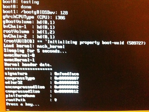

DB1 Posted January 6, 2011 Share Posted January 6, 2011 The only thing I miss in it is the rootUUID debug output (see post #327). Can you please add that to see if it locates your system volume? I get: (rootUUID [0] == Initializing property boot-uuid (589727) Thank you for catching these. This should do the trick.acpi/debug.h -#define _ACPI_DEBUG_DUMP_SLEEP(int seconds) +#define _ACPI_DEBUG_DUMP_SLEEP(seconds) acpi/patcher.h +#if DEBUG char * tableName[] = { 0, 0, 0, 0, 0 }; +#endif yeah that fixed it, thanks. And it's pleasure to help out where i can. p.s. See boot.h for that issue with the Apple boot logo being off center. The (static) default values are 1024 / 768 but that obviously isn't working for your system. Sorted this out now thanks again. I would also like to recommend that you use the same file group/ownership settings as on your regular OS X system volumes. This because I think that OS X uses these file rights to launch applications with. I'm not sure what the correct name for this is, but I remember having read something about it. I dont think thats a problem as that and the previous permissions set up works fine on my Chameleon EFI configuration. Ok, I think I may have an inkling where to narrow down the problem I have and its because you raised the possibility of Atom cpu. In 10.6.1 (from memory) Atom support was withdrawn from mach_kernel, some guy's came up with a kernel patch for the Chameleon boot loader which worked fine. More recently some others created a couple of kexts so the kernel no longer needed a patch and I have these in my /Extra/Extensions on the USB SD card booter. So whats the relevance! Well it works ok on the SD card and EFI booter with Chameleon boot so in theory it should work with Revolution, but maybe the pace at which it boots maybe the kexts are not loading to do their magic before the kernel panics. OR my Extra/Extensions are not loading at all (12 kexts). Hmmm! EDIT Having just read dgsga (hi pal) it seems possible dsdt might not be loading (is anything loading from Extra - for anyone?) EDIT 2 To eliminate potential Atom cpu panic I applied the patch to boot 2 as we (Atom cpu users) used to for Chameleon, still no boot. Link to comment Share on other sites More sharing options...

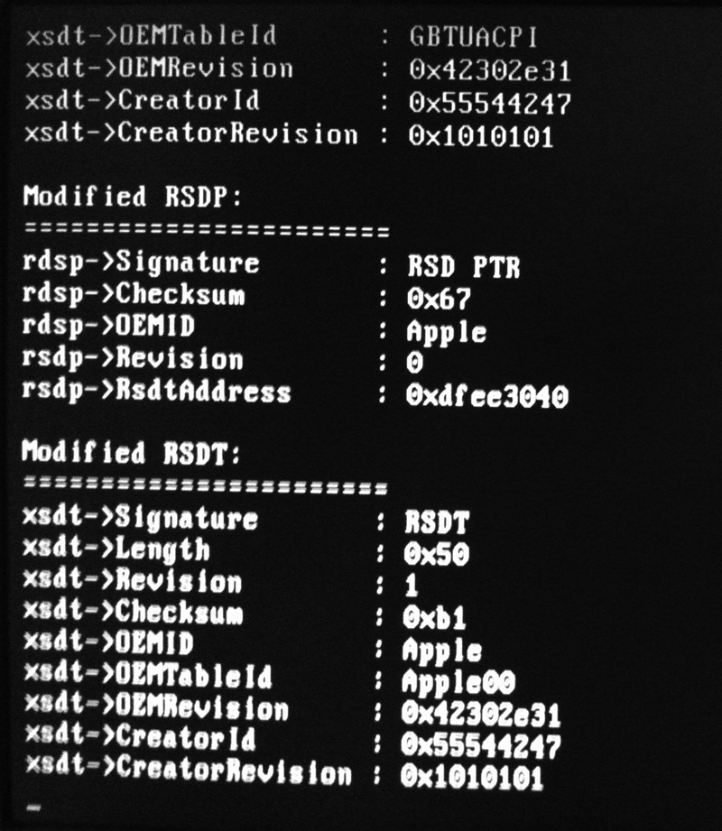

blackosx Posted January 6, 2011 Share Posted January 6, 2011 Hi DHP I have replace my files with the new files from the acpi_634_3.zip along with the fixes from past #348 then flicked the switches in acpi_patcher.c to 1 for the following options: #define ACPI_10_SUPPORT 1 #define PATCH_ACPI_TABLE_DATA 1 #define STATIC_ACPI_BASE_ADDRESS 1 #define LOAD_DSDT_TABLE_FROM_EXTRA_ACPI 1 #define DEBUG 1 Rebooting gets so far, but after loading all the ACPI tables etc.. the machine just reboots and doesn't get as far as loading the kernel. Here's the debug I see (though the pics don't show the remainder of the ACPI tables loading) From looking at the debug, I don't see any of the ACPI 1.0 changes to the modified RSDT as coded in updateACPITableData in acpi_patcher.c. I'll look into this more. EDIT: Sussed that I needed to change #define FAKE_APPLE_DATA to 1 and now I see correctly modified RSDP and RSDT tables as per function updateACPITableData The machine still reboots though before loading the kernel. Link to comment Share on other sites More sharing options...
blackosx Posted January 7, 2011 Share Posted January 7, 2011 First. Sorry for not being here yesterday evening, but my mom blocked me from working on this. You know. The usual protective stuff – you are working too much on this.../snip/.. Yikes! We're still not dropping tables, and indeed do not inject anything DSDT'ish. Investigating... Good morning dutchhockeypro. No need for apologies on your attendance here, come as go as it best suits you (or your mom - bless; she's only looking out for you). Shall I hold off on the diff for now until you've looked at the dropping / injecting of tables? Link to comment Share on other sites More sharing options...

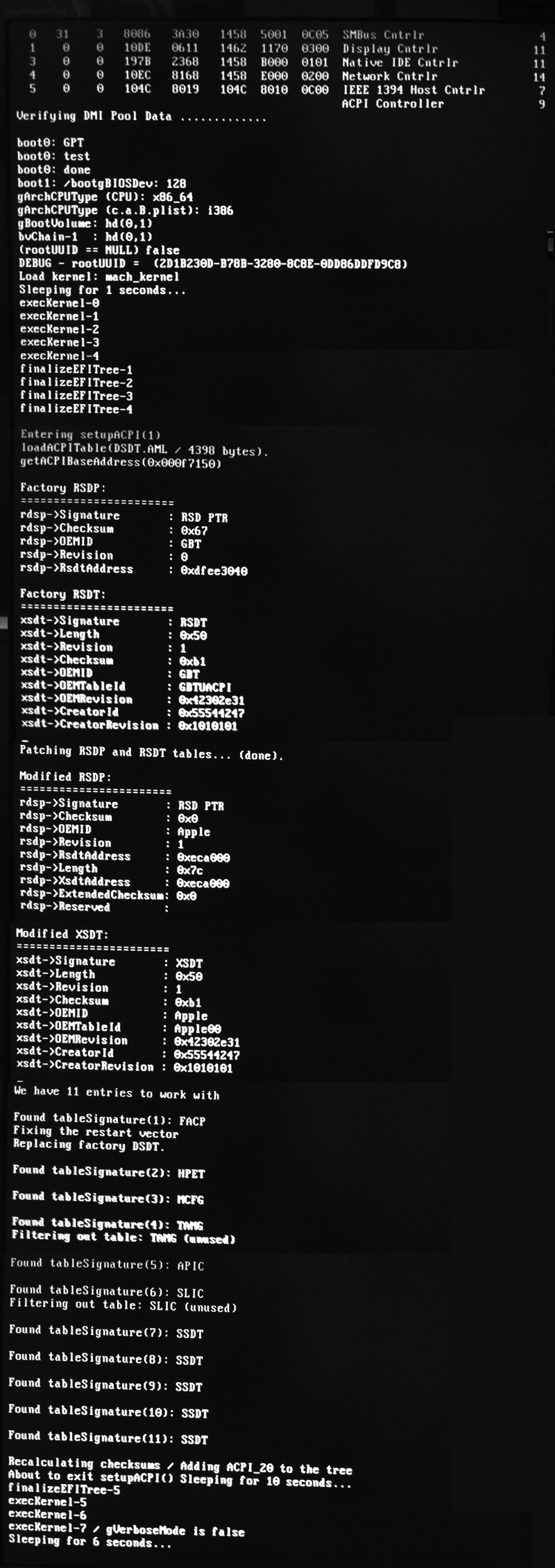

blackosx Posted January 7, 2011 Share Posted January 7, 2011 No probs. I've done it by hand testing now... Booted successfully and DSDT loaded fine. I'll just put together my debug photos - here you go. Link to comment Share on other sites More sharing options...

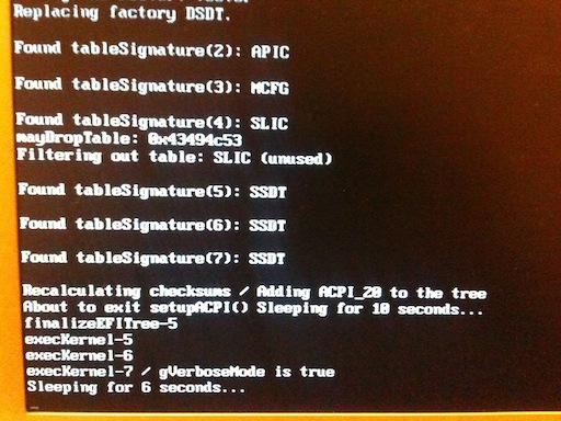

blackosx Posted January 7, 2011 Share Posted January 7, 2011 I have made another version here but this time using your files from acpi_634_5.zip. This compiles and boots fine - good job Also booting with this one shows me some extra debug, which I guess you added since the previous patch or maybe I missed when doing my manual patching - either way it doesn't matter, but those lines I see are: customDSDT @ : 0x00ec7000 mayDropTable: 0x474d4154 mayDropTable: 0x43494c53 I won't post new pics but just letting you know I see it. p.s My boot is now 50912 bytes. Link to comment Share on other sites More sharing options...

blackosx Posted January 7, 2011 Share Posted January 7, 2011 BTW: There's something wrong with this forum; all kind of images/info is missing How am I supposted to logout now, without a link for it?!? Yeah it was strange but fixed now. The latest update ACPI files tested, dsdt now loading however still no boot for me. Well done for sticking at it DB1.. I'm just Sorry I don't have the necessary skills to help you with it. EDIT: I did a couple of tests earlier to see if using Revolution reduced my boot time. I converted my DSDT.aml in to a struct and added it in to /acpi/static_data.h and added #define STATIC_DSDT_TABLE_INJECTION 1 in to acpi_patcher.c. The other options i have set in acpi_patcher.c are: #define ACPI_10_SUPPORT 1 #define PATCH_ACPI_TABLE_DATA 1 #define STATIC_ACPI_BASE_ADDRESS 1 #define FAKE_APPLE_DATA 1 smbios_patcher.c: #define DYNAMIC_SMBIOS_DATA_GATHERING 0 boot.c: #define PRE_LINKED_KERNEL_SUPPORT 0 I then turned off all debug settings and rebooted. Starting timing from when I press return from selecting my USB boot device from BIOS, it took 30 seconds until the throbber appeared, and 53 seconds in total until I was at the desktop.. I have to admit though that I have VMWare Fusion installed and that does increase boot time considerably, however I want to do further testing to build up a better picture. I've also got some data I posted in post #13 which I can bring in to my comparisons (blimey - that was nearly a year ago!) EDIT2: For comparison, I've just booted from USB using the latest version of Chameleon RC5 (GUI disabled by using GUI=No in c.a.B.p) with the same DSDT and kexts and including the time it took for me to press the down arrow to select my OS X partition, it took 19 seconds for the throbber to appear and 40 seconds until I was at the desktop. I know these simple tests are hardly conclusive and maybe in the future I can construct a proper test with help from DHP to optimize my Revolution build to make the most of it's slimline frame and therefore give it a fair comparison. With that I'm off bed. Goodnight. Link to comment Share on other sites More sharing options...

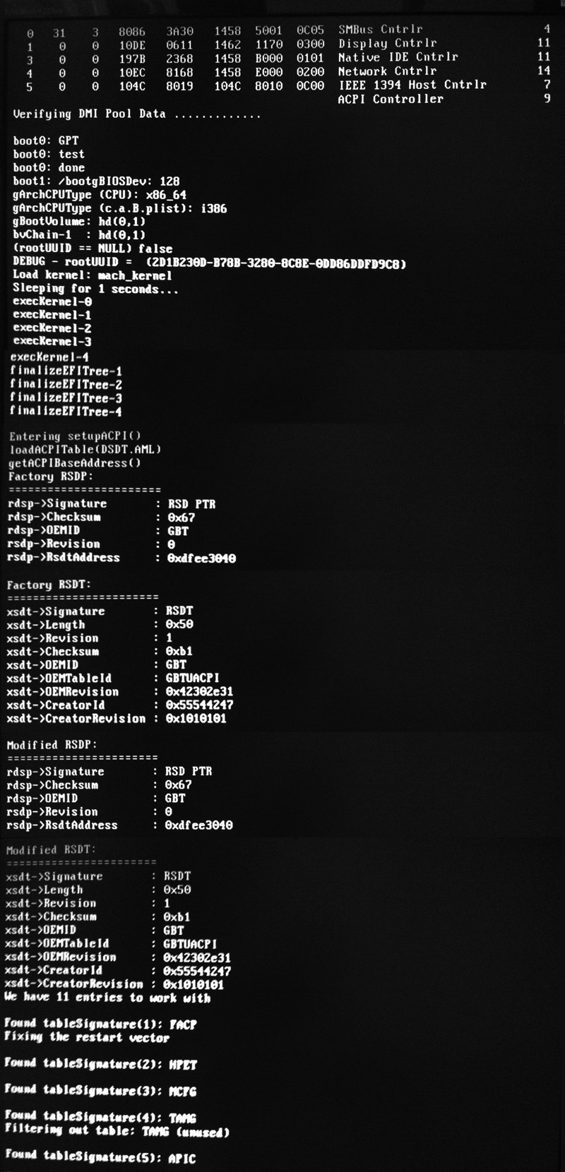

scrax Posted January 8, 2011 Share Posted January 8, 2011 no more cmos error with the last change but still not a complete boot... I'll post dump asap Link to comment Share on other sites More sharing options...

scrax Posted January 8, 2011 Share Posted January 8, 2011 That is good to hear. Can you please attach a ioreg dump of your running hack for me? TIA. I'm pretty sure DB1's Atom is 32-bit only, but I have yet to check what Scrax is using so... please chime in gentlemen. I'm using the Zotac in my signature, usually I prefer to boot in 32bit mode, but with chameleon or Grub2 I can boot also in 64bit without problems. With only 4 GB of RAM I don't think 64bit is really needed but I have made no changes in Revolution or in the c.a.B.p to determine which mode to use so if 64bit is the default mode as chameleon i'm trying to start in 64bit IOREG: iMacdiScrax.ioreg.zip EDIT: SUCCESS!?! I've added arch=x86_64 in caBp, -x instead of -v and it worked! But... it loaded the wrong system??? I have 2 HD First one with Chameleon and my working system in disk0s2: /dev/disk0 #: TYPE NAME SIZE IDENTIFIER 0: GUID_partition_scheme *128.0 GB disk0 1: Microsoft Basic Data EFI 209.7 MB disk0s1 2: Apple_HFS Gskill 115.0 GB disk0s2 3: Apple_HFS Mac OS X Install DVD 12.6 GB disk0s3 the other one with revolution and my test install on disk1s2: /dev/disk1 #: TYPE NAME SIZE IDENTIFIER 0: GUID_partition_scheme *1.0 TB disk1 1: EFI 209.7 MB disk1s1 2: Apple_HFS ScraxMac 100.0 GB disk1s2 3: Apple_HFS Data 899.6 GB disk1s3 boot uuid is from disk1s2 but after finishing the debug prompt it loads disk0s3 a volume where I have restored the install DVD of snowLeopard with fakesmc included to load it. I'm pretty sure that it loads c.a.B.p from ScraxMac (disk1s2) because I can see the changes I made to it reflected it the debug info. I'll try to remove the first HD and reboot now, and then I''l make some other test just to have some more to report. EDIT2: With only one HD all goes fine but only if I use the -x flag I can boot. Link to comment Share on other sites More sharing options...
scrax Posted January 8, 2011 Share Posted January 8, 2011 Thank you for testing. Hope to be of assistant. I have this kernel flags in caBp in /Volumes/ScraxMac/Library/Preferences/SystemConfiguration/com.apple.Boot.plist: arch=x86_64 -x rd=uuid boot-uuid=ECFBE09E-8AC0-34E2-93DC-952E4B7E8117 (the uuid is the one i get with disk utility->info on the ScraxMac volume) In acpi_patcher.c I have this options: #define ACPI_10_SUPPORT 1 #define PATCH_ACPI_TABLE_DATA 1 #define STATIC_ACPI_BASE_ADDRESS 1 #define STATIC_APIC_TABLE_INJECTION 0 #define STATIC_SSDT_PR_TABLE_INJECTION 0 #define STATIC_SSDT_USB_TABLE_INJECTION 0 #define STATIC_GPU_TABLE_INJECTION 0 #define STATIC_DSDT_TABLE_INJECTION 1 #define LOAD_DSDT_TABLE_FROM_EXTRA_ACPI 0 #define STATIC_SSDT_TABLE_INJECTION 1 #define LOAD_SSDT_TABLE_FROM_EXTRA_ACPI 0 #define DROP_SSDT_TABLES 1 #define FAKE_APPLE_DATA 1 #define DEBUG 1 static dsdt and ssdt data added using the data I have with chameleon now, but when revolution starts I have a unrecognized sata chipset instead of the correct one that i have with chameleon. I'll now try to load the dsdt.aml from /Extra/ACPI to see if it works better. (problem solved, was a missed patch in dsdt.) So now I can boot with only one HD connected, maybe I need to try with an usb bootloader? What do you think about the problem of not booting without -x? Is there some dump that I can provide you? Now I need to leave, see you al tomorrow. Link to comment Share on other sites More sharing options...
