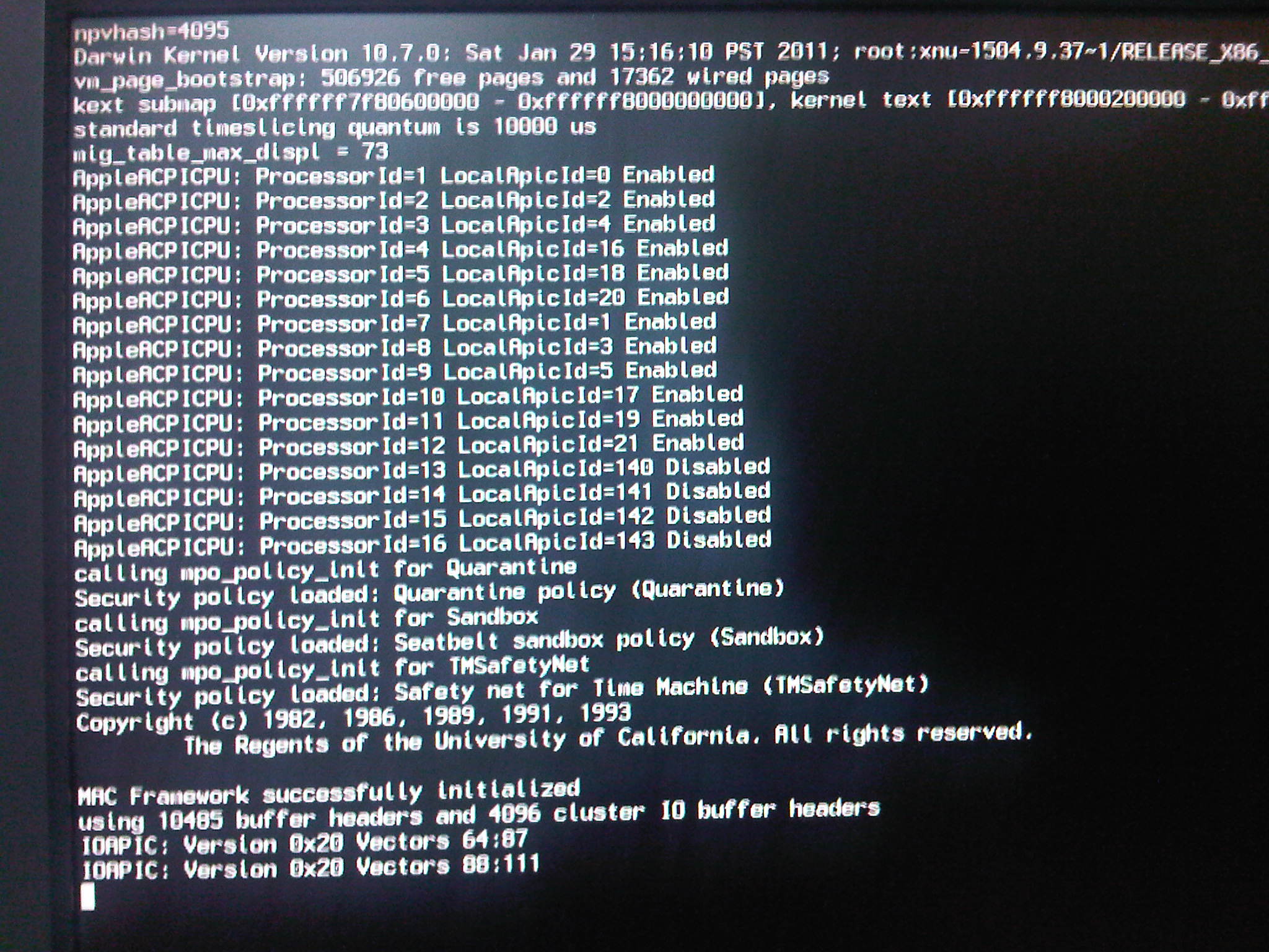

inovice Posted April 16, 2011 Share Posted April 16, 2011 @kmcdaniel Ok, found what my problem was, my sleep issue that had, was related to my previous USB Mouse Setup. I swapped to a logitech mouse with IBM PS/2 keyboard and never had any sleep problem again. My bios is currently with "Repost to Yes". Also, I have the latest bios. Thanks All, I am having a problem and need your advice. I have setup my new cpu cooler and overclocked my cpu to 4.4 Ghz. But I am getting kernel panic every now and then. If I use my cpu at 3.6 Ghz around, everything works fine. But if I increase it to 4.4 Ghz, I cannot boot (if I am lucky, it boots but then kernel panic). I am using DSDT v3.3 from Fabio with 980X Package from Post#4. I am thinking that maybe it is the speedstep setting on the dsdt, could you please let me know your thoughts. Thanks, iNovice Link to comment Share on other sites More sharing options...
ErmaC Posted April 16, 2011 Share Posted April 16, 2011 @kmcdaniel Ok, found what my problem was, my sleep issue that had, was related to my previous USB Mouse Setup. I swapped to a logitech mouse with IBM PS/2 keyboard and never had any sleep problem again. My bios is currently with "Repost to Yes". Also, I have the latest bios. Thanks All, I am having a problem and need your advice. I have setup my new cpu cooler and overclocked my cpu to 4.4 Ghz. But I am getting kernel panic every now and then. If I use my cpu at 3.6 Ghz around, everything works fine. But if I increase it to 4.4 Ghz, I cannot boot (if I am lucky, it boots but then kernel panic). I am using DSDT v3.3 from Fabio with 980X Package from Post#4. I am thinking that maybe it is the speedstep setting on the dsdt, could you please let me know your thoughts. Thanks, iNovice Try the setting and the "new" DSDT v3.4 Fabio Link to comment Share on other sites More sharing options...
