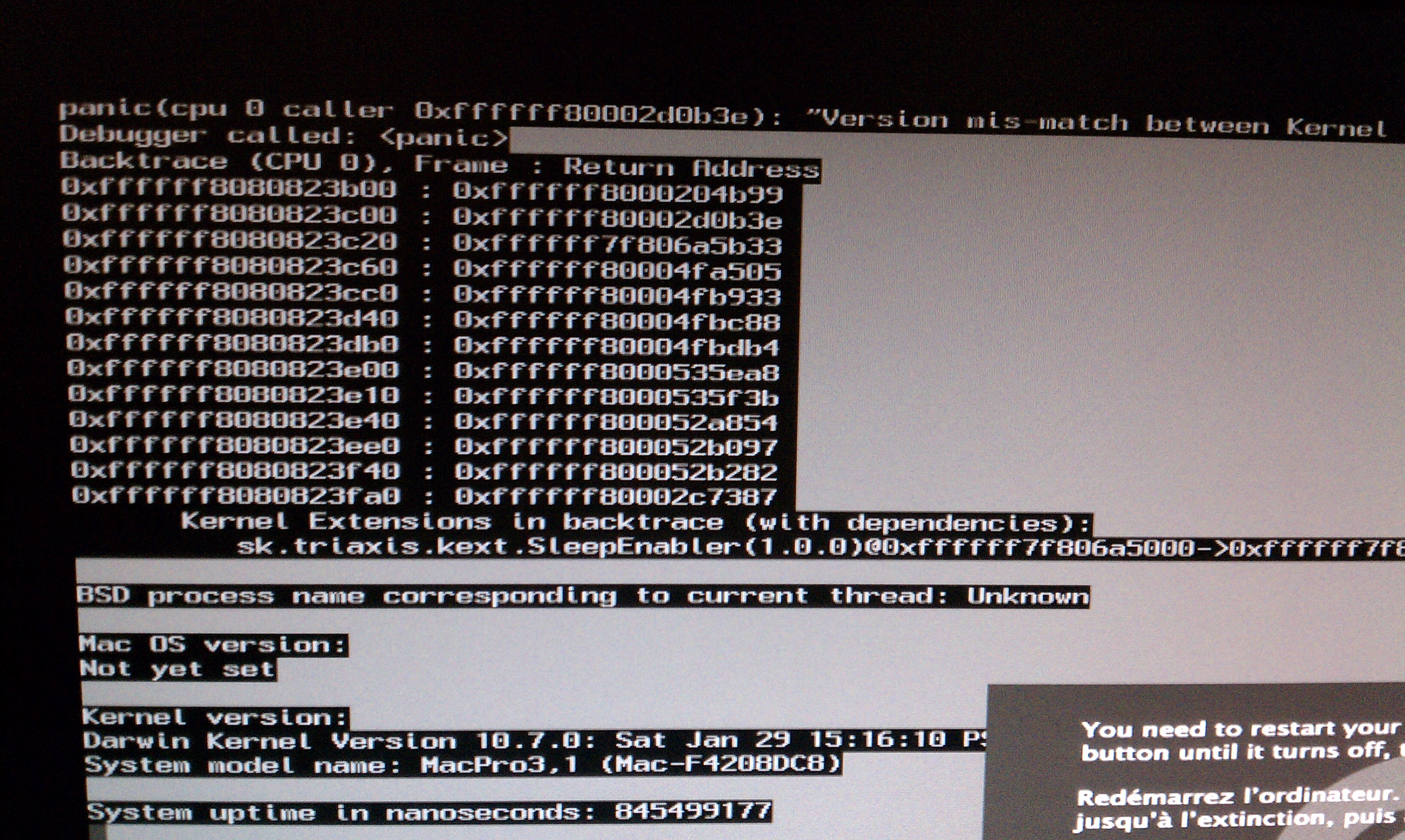

So sounds like everyone is not having any issues with the 10.6.7 update straight from software update. So I went ahead and did that, then restarted and tried using the chameleon boot mngr to boot with single user and verbose and get a kernal panic. it says something like hold down power button till off then turn back on, and its saying something about 10.7.0...i hope i didn't loose everything!!

I got the same error, but what i did was shut down, unplug the power supply, then boot up again. not exactly sure how i fixed it, but it happened to me twice, and it now works fine for me. (I am now booting from a USB stick, because I screwed up something in Chameleon on my drive, after I switched from a single velociraptor drive, to 2 in RAID 0.)
good luck

Why did you boot in single user mode straight after the update? Have you tried booting just normal?
Ive tried everything, i even tried typing in -x to boot in safe mode and still gives me the same message. Does it look like its the sleep enabler kext thats causing it? If so is there a way to disable it?
If you have an external usb disk, reinstall osx there, boot from it and you'll also have access to internal hdd filesystem. Maybe manually deleting caches and rebuilding them by kext.utility will help. It's not the fastest way to accomplish your job, but, anyway, having another working osx setup on usb to boot from, is always a good idea!

So your saying that i have to reinstall everything? Start all over? I do have the actual SL Disc. I edit my sig now
please help me out here, someone has to know how to fix this issue, if i just type in pmVersion=0 while im at the bootloader screen in chameleon will that do it? ive done all sorts of updates before and never had a kernal panic.
Hi carleycr,
By using a boot flag during update you have interrupted the update process (never a good idea). As st3p said
the only way you 'may' be able to save your system is by using another OSX install to navigate your corrupted
install. If you don't have access to a Mac & a USB to SATA adapter, you could set up a USB with OSX on it. To
do that you will have to use from here installer DSDT etc you use & any other kexts/mods if needed for your GFx
card, google search "How to Install Snow Leopard (10A432)" to get an idea how to do this. If as st3p said earlier
deleting & rebuilding caches does not work:
Then download update pkg from apple & select to install to your corrupted drive, restart with corrupted H/D still
connected after it is done, you should then be able to Repair Permissions on it, then corrupted install should boot.
(Please just try normal boot ie: without any flags first)..
If this to fails 'yes it probably would be best to do fresh install, Unless anyone else has another solution ??
EDIT: You 'MAY' have to set Bios to boot from USB first if using a USB install.
It is a good idea to have a cloned back up for just these moments. (I found Clonezilla very good). Good luck

so good new, was able to boot using pmversion=0, deleted sleepenabler kext, repaired disk permissions and now have a fully updated osx to 10.6.7!!! thanks everyone for the help, very much appreciated..
