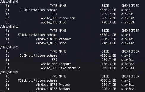

Someone might be able to help if you provided the output of diskutil list and diskutil info /dev/diskXsY <--One of your volumes that is not recognized as the correct type.

From diskutil:
Correctly identified:
Device Identifier: disk0s3
Device Node: /dev/disk0s3
Part Of Whole: disk0
Device / Media Name: Snow2
Volume Name: Snow
Escaped with Unicode: Snow
Mounted: Yes
Mount Point: /
Escaped with Unicode: /
File System: Journaled HFS+
Type: hfs
Name: Mac OS Extended (Journaled)
Journal: Journal size 40960 KB at offset 0xe87000
Owners: Enabled
Partition Type: Apple_HFS
Bootable: Is bootable
Media Type: Generic
Protocol: SATA
SMART Status: Verified
Volume UUID: 3A83CFD2-3476-35FF-861F-B181FA3B3F31
Total Size: 498.8 GB (498824364032 Bytes) (exactly 974266336 512-Byte-Blocks)
Volume Free Space: 417.8 GB (417840521216 Bytes) (exactly 816094768 512-Byte-Blocks)
Read-Only Media: No
Read-Only Volume: No
Ejectable: Yes
Whole: No
Internal: No
Device Location: "Bay 2"
Incorrectly identified (as external):
Device Identifier: disk3s2
Device Node: /dev/disk3s2
Part Of Whole: disk3
Device / Media Name: Untitled
Volume Name: Leopard
Escaped with Unicode: Leopard
Mounted: Yes
Mount Point: /Volumes/Leopard
Escaped with Unicode: /Volumes/Leopard
Type: hfs
Journal: Journal size 16384 KB at offset 0x462000
Owners: Disabled
Media Type: Generic
Protocol: SATA
Volume UUID: 9DD2F083-5FA1-3084-9B0B-6457CDBB6F92
Total Size: 150.3 GB (150323851264 Bytes) (exactly 293601272 512-Byte-Blocks)
Volume Free Space: 141.6 GB (141639577600 Bytes) (exactly 276639800 512-Byte-Blocks)
Read-Only Media: No
Ejectable: Yes
Whole: No
Internal: No
Device Location: "Bay 4"

Thanks again. Maybe you missed my edited post above with some diskutil info.
You're welcome...
diskutil list shows the partition scheme (MBR or GUID). I don't know the answer but I was just showing you how to post the information that might enable someone to help you.
You're welcome...
Thanks. Just carrying on with this for a while.
1) Boot disc 1.15 works perfectly for me.
2) to answer an earlier question, Drive Genius has a comprehensive set of HD benchmarking tests and the results for ICH10 and ESB2 were almost identical.
3) going back to my partition info being mostly wrong using ICH10, I don't understand this. I have 4 exact same drives, all with 2 partitions. 4 Windows and 4 Mac OS X. Why do all 4 NTFS partitions show up as CD/DVD, 2 of the Mac ones (a Leo install and my Time Machine backup) as External, and 2 (my Snow install and Chameleon boot partition) show up correctly as HDs? I can perhaps understand all 4 NTFS being the same, but why are the 2 GUID drives not the same?

    Yours may be mounted on a different device e.g. /dev/disk2s2
    Type in:
    sudo fdisk -e /dev/diskX <Enter> replace X with your drive number
    You are now at an fdisk prompt. Type:
    p <Enter> to print the partition table, you will see output like this:
    Disk: /dev/disk3 geometry: 60801/255/63 [976773168 sectors]
    Offset: 0 Signature: 0xAA55
    Starting Ending
    #: id cyl hd sec - cyl hd sec [ start - size]
    1: EE 1023 254 63 - 1023 254 63 [ 1 - 976773167] GPT
    2: 00 0 0 0 - 0 0 0 [ 0 - 0] unused
    3: 00 0 0 0 - 0 0 0 [ 0 - 0] unused
    4: 00 0 0 0 - 0 0 0 [ 0 - 0] unused
    Type:
    flag 1 <Enter> To flag your partition as active, it will be the one with id EE.
    Type:
    w <Enter> To write the changes, hit y at the reboot warning if present.
    Type q <Enter> to quit. Reboot and remove all disks again to see if it works.
    If not, boot one more time from the boot-132 disk and select the hard drive.
    Once at the Desktop, double-click the CD/DVD icon and run the
    P6TDeluxeV2Installer.pkg installation package again.
