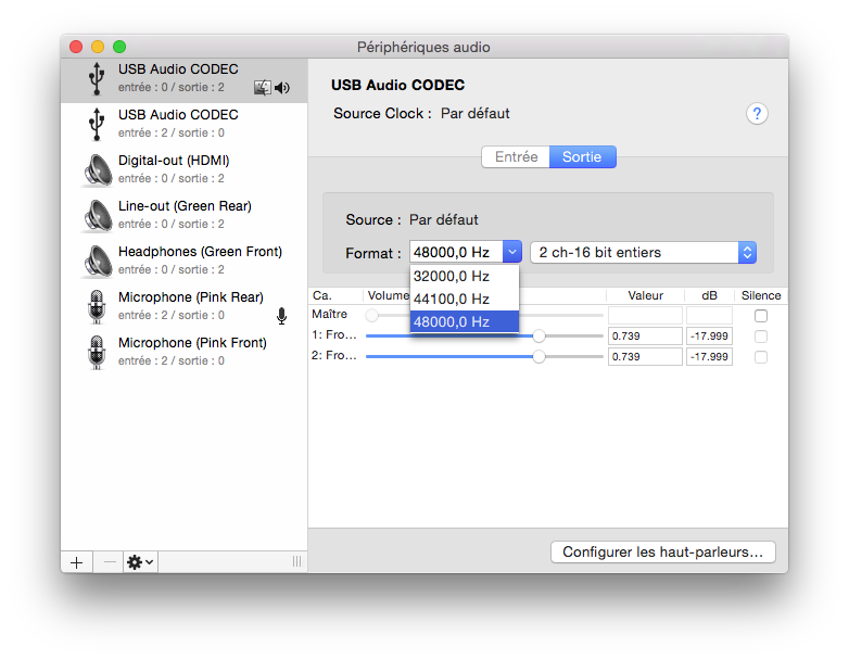

gils83 Posted January 5, 2015 Share Posted January 5, 2015 I was the opinion that Savva_Mitrofanov also in this kext for NForce was involved, see http://www.insanelymac.com/forum/topic/206494-applenforceata-x32x64-new-sl-version-recompiled/?p=2061091 Therefore I am assumed that the Kext provided for Maverick also on Yosemite be adapted can AMD Phenom II X3 720 Asus, M2N-SLI Deluxe Nvidia GeForce GTX 650 Sound Behringer, UCA222 Yosemite 10.10.1 oh !! use UFO 202 , good audio card but low Link to comment Share on other sites More sharing options...

yakei Posted January 5, 2015 Share Posted January 5, 2015 AMD Phenom II X3 720 Asus, M2N-SLI Deluxe Nvidia GeForce GTX 650 Sound Behringer, UCA222 Yosemite 10.10.1 oh !! use UFO 202 , good audio card but low yes, usb sound card is ok AppleNforceATA 1.0.4 Support Hardware Updates for Lion or later Based on AnV 1.0.4 32/64 Version Support hardware Updates list NFORCE MCP55 But SATA DVD NO FIX ˇ ˇ include kext & Source yes, no error on the start from yosemite (fast start) I Tunes opened with Audio CD, Music cannot be played unfortunately. DVD not works Are there possibilities at DVD problem to modify ? Thank you Link to comment Share on other sites More sharing options...

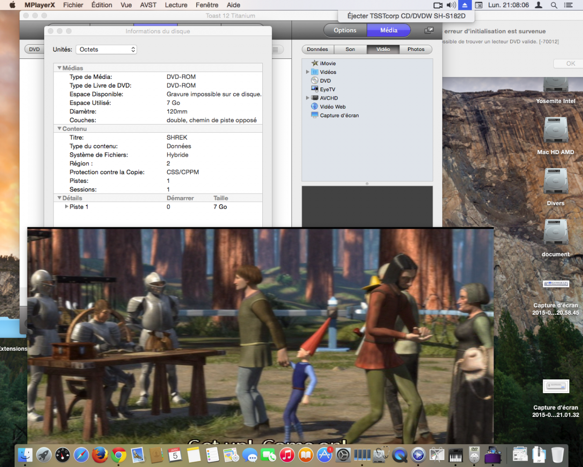

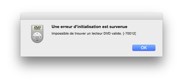

gils83 Posted January 5, 2015 Share Posted January 5, 2015 use MPlayerX for video DVD , works very well for Toast Titanium and works for Itunes ( old DVD ext ide/usb) 1 Link to comment Share on other sites More sharing options...
