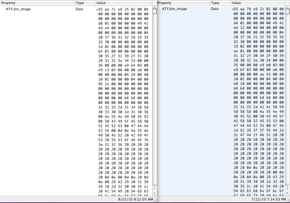

VCH888 Posted August 22, 2010 Share Posted August 22, 2010 Sure no problem, the rom is @ rev 126. here it is : Sapphire_1002_68b8.rom.zip Once unzipped MD5 = af0a8833b8baf3f93bbbf74c85c40ec1 I've crossflashed my Sapphire with an XFX bios, in order to get 1920x1200x32 boot resolution. But no luck for the moment. If someone with this screen res. at boot time could share is bios, could be cool ? Bye. Thanks for boot7.zip I tested your Sapphire rom and it worked. See the below picture, the left side is bin_image of your Sapphire and the right side is bin_image of my Gigabyte HD5770. I have a question. Is it save to use other roms rather than itself? Link to comment Share on other sites More sharing options...

Trauma! Posted August 22, 2010 Share Posted August 22, 2010 Thanks for boot7.zip I tested your Sapphire rom and it worked. See the below picture, the left side is bin_image of your Sapphire and the right side is bin_image of my Gigabyte HD5770. I have a question. Is it save to use other roms rather than itself? If Chameleon can read your VBIOS then no need to use a ROM file. About using another card rom's: as long as you are using a 5770 rom, i don't think it can cause any problems. But it's always better to use your proper rom if it's working with OSX. You can dump it from ATI WinFlash if you like. About HDMI audio, is any HDA plist edition is required ? I've used the DSDT code from iMac11,1, I have AppleHDA loading on HDAU just fine, but nothing else. Cheers Link to comment Share on other sites More sharing options...

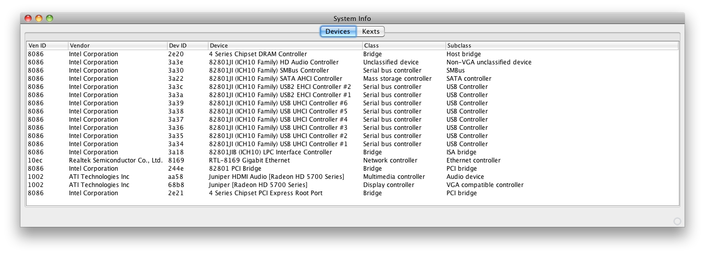

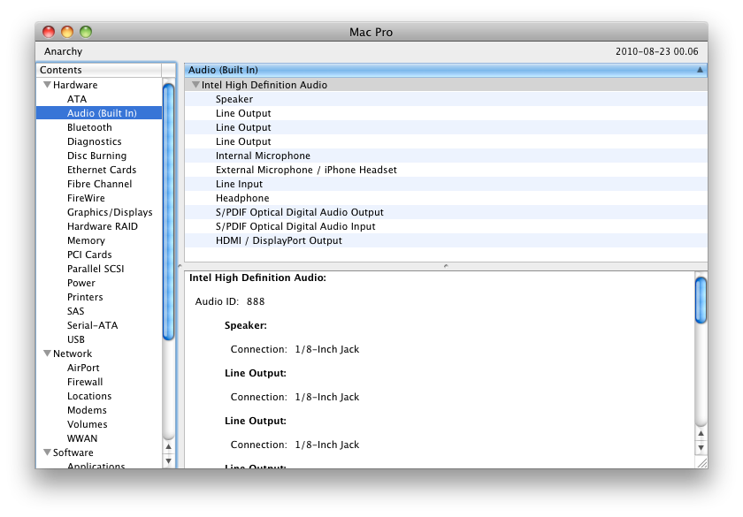

Common Sense Posted August 22, 2010 Share Posted August 22, 2010 Great news! Then maybe HDMI is working for me too, I assumed it was not working because it did not show up in the System preferences -> Sound -> Output. It does show up under System Profiler -> Audio (Built In) and when running System Info (GUI for lspci). I include screenshots for them. If my wife wasn't sleeping now I would try and connect it to the TV Link to comment Share on other sites More sharing options...
