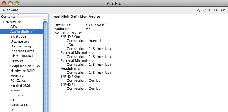

smc13 Posted February 21, 2010 Share Posted February 21, 2010 Hello D00d, Thanks for your help. I put the changes to mod 5 that you suggest I do yesterday. The cpu is working, the temp is fine. I am having one issue, though. My sound is stuttering now where it wasn't before. Any idea why the stuttering is occurring? I have an ex58-ud3r Rev 1.6 with an ALC888. Thanks again Link to comment Share on other sites More sharing options...
smc13 Posted February 22, 2010 Share Posted February 22, 2010 Hello D00d, Thanks for your help. I put the changes to mod 5 that you suggest I do yesterday. The cpu is working, the temp is fine. I am having one issue, though. My sound is stuttering now where it wasn't before. Any idea why the stuttering is occurring? I have an ex58-ud3r Rev 1.6 with an ALC888. Thanks again Well, I put the NullCPUPowerManagement.kext back and the stuttering went away. I don't see any performance difference either way. I'll just, stick with the extra kext and sound. Thanks again Link to comment Share on other sites More sharing options...
d00d Posted February 22, 2010 Author Share Posted February 22, 2010 Well, I put the NullCPUPowerManagement.kext back and the stuttering went away. I don't see any performance difference either way. I'll just, stick with the extra kext and sound. Thanks again Did you do 11? What can be wrong? I mean, I should have the correct DSDT.aml since it's the one I downloaded from d00d's first post. Shouldn't the ALC889a.kext be all I need then? I noticed I got this in the logs at boot: 2010-02-22 00.56.24 com.apple.kextd[10] AppleHDA.kext - no dependency found for com.apple.iokit.IOAudioFamily. 2010-02-22 00.56.24 com.apple.kextd[10] Can't load AppleHDA.kext - failed to resolve dependencies. 2010-02-22 00.56.24 com.apple.kextd[10] Failed to load AppleHDA.kext - (libkern/kext) dependency resolution failure. 2010-02-22 00.56.24 com.apple.kextd[10] Load com.apple.driver.AppleHDA failed; removing personalities. 2010-02-22 01.01.06 com.apple.kextcache[204] AppleHDA.kext - no dependency found for com.apple.iokit.IOAudioFamily. 2010-02-22 01.01.07 com.apple.kextcache[204] AppleHDA.kext - no dependency found for com.apple.iokit.IOAudioFamily. 2010-02-22 01.01.07 com.apple.kextcache[204] Prelink failed for com.apple.driver.AppleHDA; omitting from prelinked kernel. Anything to worry about? Yes, 14B and ALC889a.kext is all you need for audio.Do you have an AppleHDA.kext in Extra/Extensions.mkext? If so, remove it. If not, is IOAudioFamily.kext missing from SLE? Link to comment Share on other sites More sharing options...
star-affinity Posted February 22, 2010 Share Posted February 22, 2010 Yes, 14B and ALC889a.kext is all you need for audio.Do you have an AppleHDA.kext in Extra/Extensions.mkext? If so, remove it. If not, is IOAudioFamily.kext missing from SLE? I'll check these things when I get back home (at work now). Here comes a follow-up question: how can I see what I have in Extensions.mkext? I've noticed I cannot do a right-click an ”Show Package Contents” like on the kexts. Another thing that started to happen yesterday: I have one drive for Mac OS X and one drive for Windows 7 and now when I boot Chameleon doesn't seem to kick in but Windows starts instead. If I disconnect the Windows drive I get into Chameleon and can select the drive I wan't to boot from (in this case only Mac OS X since it's the only one available). What can the reason for this be? I guess a re-install of Chameleon might do the trick – will try that. Thanks a lot for helping! I'll happily give a donation to you d00d when I get my salary on the 25th! You have a PayPal account or something so I can send you a little beer money? (or whatever-money if you don't like beer) Link to comment Share on other sites More sharing options...

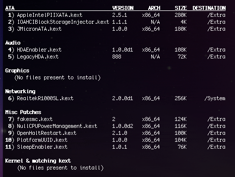

smc13 Posted February 22, 2010 Share Posted February 22, 2010 Another thing that started to happen yesterday: I have one drive for Mac OS X and one drive for Windows 7 and now when I boot Chameleon doesn't seem to kick in but Windows starts instead. If I disconnect the Windows drive I get into Chameleon and can select the drive I wan't to boot from (in this case only Mac OS X since it's the only one available). What can the reason for this be? I guess a re-install of Chameleon might do the trick �" will try that. The reason you are booting into Windows without going into Chameleon is because your bios is set to boot the windows drive, not the drive with Chameleon/OSX. Go into the bios and change the hard drive order and then try it. Link to comment Share on other sites More sharing options...
smc13 Posted February 23, 2010 Share Posted February 23, 2010 I thought I had, but I'll look when I get home. Well, So much for my memory. I hadn't done number 11 after all. I don't have any audio stuttering and I am not using NullCPUPowerManagement.kext. Thanks Link to comment Share on other sites More sharing options...

Swhay Posted February 23, 2010 Share Posted February 23, 2010 The extensions seem to load and it works fine to sleep the computer using the power button!So what the heck is missing when it comes to the audio? Is the problem that I've installed all the kexts in /S/L/E instead of /E? Should that matter? I'll try and see if I can remove NullCPUPowerManagement.kext and still start up - should work since the DSDT.aml seems to be read in correctly, right? Edit: Removing the NullCPUPowerManagement.kext didn't work. So it seems I have a semi-functional DSDT.aml... Altight! I can boot without NullCPUPowerManagement.kext now - it seems I'd forgot to do step 6 in the com.apple.boot.plist. Anyway - still no audio! I don't understand what the problem is. What can be wrong? I mean, I should have the correct DSDT.aml since it's the one I downloaded from d00d's first post. Shouldn't the ALC889a.kext be all I need then? I noticed I got this in the logs at boot: 2010-02-22 00.56.24 com.apple.kextd[10] AppleHDA.kext - no dependency found for com.apple.iokit.IOAudioFamily. 2010-02-22 00.56.24 com.apple.kextd[10] Can't load AppleHDA.kext - failed to resolve dependencies. 2010-02-22 00.56.24 com.apple.kextd[10] Failed to load AppleHDA.kext - (libkern/kext) dependency resolution failure. 2010-02-22 00.56.24 com.apple.kextd[10] Load com.apple.driver.AppleHDA failed; removing personalities. 2010-02-22 01.01.06 com.apple.kextcache[204] AppleHDA.kext - no dependency found for com.apple.iokit.IOAudioFamily. 2010-02-22 01.01.07 com.apple.kextcache[204] AppleHDA.kext - no dependency found for com.apple.iokit.IOAudioFamily. 2010-02-22 01.01.07 com.apple.kextcache[204] Prelink failed for com.apple.driver.AppleHDA; omitting from prelinked kernel. Anything to worry about? I had a problem with audio too at first. I ended up by removing the ALC889a.kext from /E/E and making the changes to the DSDT for audio without any additional kexts. All the kexts I have now is fakesmc.kext in E/E and the realtek nic driver in /S/L/E. Everything works. Here is my DSDT.aml file it is for the i7 920 CPU. dsdt.aml.zip Link to comment Share on other sites More sharing options...

star-affinity Posted February 24, 2010 Share Posted February 24, 2010 I had a problem with audio too at first. I ended up by removing the ALC889a.kext from /E/E and making the changes to the DSDT for audio without any additional kexts. All the kexts I have now is fakesmc.kext in E/E and the realtek nic driver in /S/L/E. Everything works. Here is my DSDT.aml file it is for the i7 920 CPU. dsdt.aml.zip Thanks. I've installed your attached DSDT.aml and indeed it works fine with just facsmc.kext and the Realtek NIC driver, but I still don't get any audio. Someting seems broken since I get a lot of complaints about audio in the logs at boot. If anybody got any idea of what might be wrong, please let me know. Permission problems perhaps? 2010-02-24 12.06.26 com.apple.kextd[10] Can't create kext cache under / - owner not root. 2010-02-24 12.06.26 com.apple.kextd[10] SteerMouse.kext does not declare a kernel dependency; using com.apple.kernel.6.0. 2010-02-24 12.06.26 com.apple.kextd[10] SteerMouse.kext does not declare a kernel dependency; using com.apple.kernel.6.0. 2010-02-24 12.06.26 com.apple.kextd[10] IOAudioFamily.kext - no dependency found for com.apple.kext.OSvKernDSPLib. 2010-02-24 12.06.26 com.apple.kextd[10] Can't load AppleFWAudio.kext - failed to resolve dependencies. 2010-02-24 12.06.26 com.apple.kextd[10] Failed to load AppleFWAudio.kext - (libkern/kext) dependency resolution failure. 2010-02-24 12.06.26 com.apple.kextd[10] Load com.apple.driver.AppleFWAudio failed; removing personalities. 2010-02-24 12.06.26 com.apple.kextd[10] IOAudioFamily.kext - no dependency found for com.apple.kext.OSvKernDSPLib. 2010-02-24 12.06.26 com.apple.kextd[10] Can't load AudioIPCDriver.kext - failed to resolve dependencies. 2010-02-24 12.06.26 com.apple.kextd[10] Failed to load AudioIPCDriver.kext - (libkern/kext) dependency resolution failure. 2010-02-24 12.06.26 com.apple.kextd[10] Load com.apple.driver.AudioIPCDriver failed; removing personalities. 2010-02-24 12.06.26 com.apple.kextd[10] IOAudioFamily.kext - no dependency found for com.apple.kext.OSvKernDSPLib. 2010-02-24 12.06.26 com.apple.kextd[10] DspFuncLib.kext - no dependency found for com.apple.kext.OSvKernDSPLib. 2010-02-24 12.06.26 com.apple.kextd[10] Can't load AppleHDA.kext - failed to resolve dependencies. 2010-02-24 12.06.26 com.apple.kextd[10] Failed to load AppleHDA.kext - (libkern/kext) dependency resolution failure. 2010-02-24 12.06.26 com.apple.kextd[10] Load com.apple.driver.AppleHDA failed; removing personalities. 2010-02-24 12.06.26 com.apple.kextd[10] IOAudioFamily.kext - no dependency found for com.apple.kext.OSvKernDSPLib. 2010-02-24 12.06.26 com.apple.kextd[10] Can't load AudioIPCDriver.kext - failed to resolve dependencies. 2010-02-24 12.06.26 com.apple.kextd[10] Failed to load AudioIPCDriver.kext - (libkern/kext) dependency resolution failure. 2010-02-24 12.06.26 com.apple.kextd[10] Load com.apple.driver.AudioIPCDriver failed; removing personalities. Edit: Looked around the web a little and figured it might got to do with the info.plist within one (or more) of the kexts. Or? Edit: I managed to get rid of the kext cache creation problem by changing the permissions for / The audio kext dependency issues are still there, though. Link to comment Share on other sites More sharing options...
